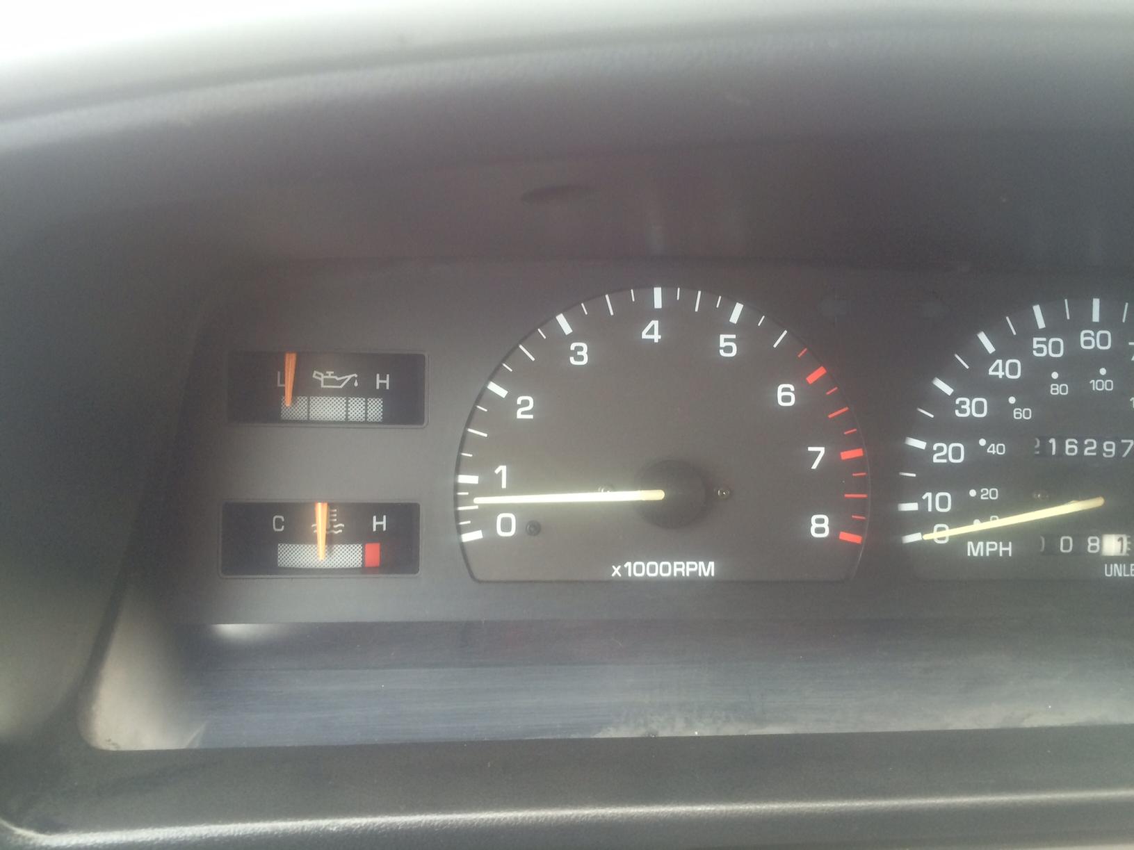

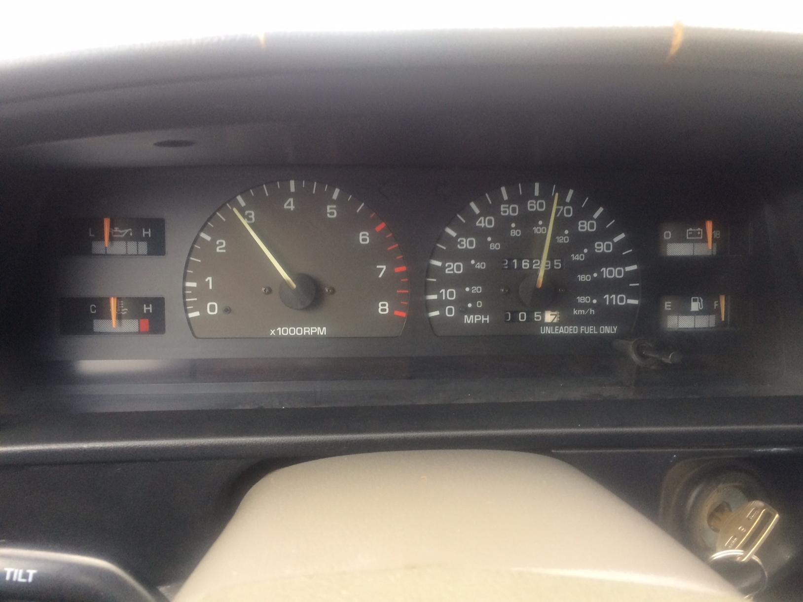

I'm in the same boat. I was given this 4Runner and put some work into it getting the AC fixed, leaky valve cover gasket, and lots of other odds and ends. I hadn't driven it in 2 months while all these things were being done to it. I drove it and noticed that gauge was on the low side. I can' remember what it was like when I got the car.
The engine has 216k on it. Purrs like a kitten. But that oil pressure gauge concerns me.
At first start up, the gauge performs as expected (in the middle as I drive it). As the engine gets warm, everything goes down to the 'L'.
Attached are two photos. One at idle. One while driving about 66mph at 2800RPM. The gauge is low.
It has enough oil in it.
The car will live down in HOT Cabo Mexico so I put in 10w-40 vs the recommended 10w-30. Was that a good idea?
