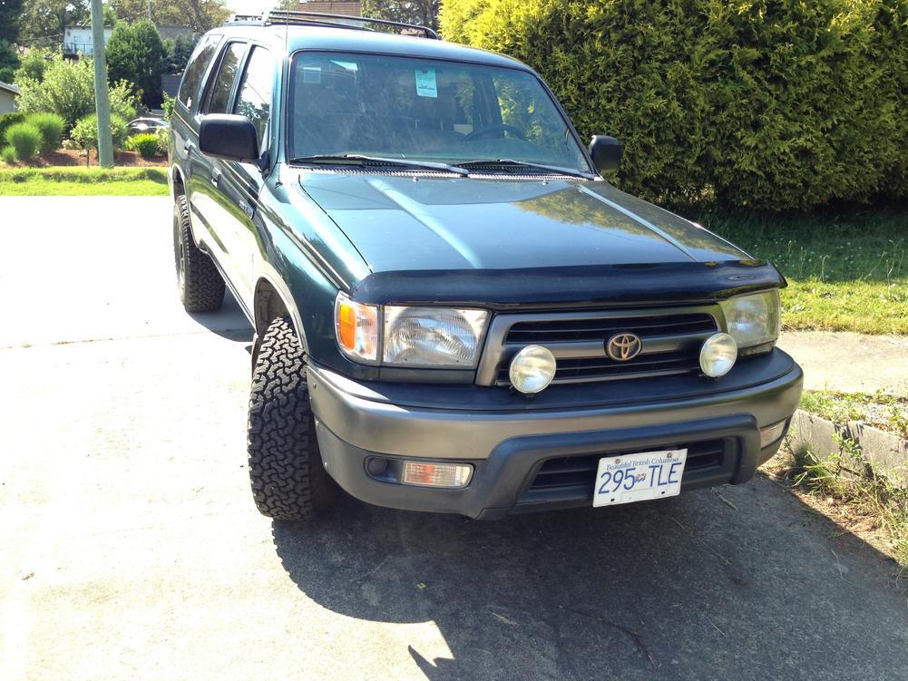

Painted the grille to match the bumper.. Looks way better, in my opinion.

Since you are fishing for feedback I will give it...
Yes, your grill does look better :thumb3:. Now PLEASE remove or paint all gold items from your 4Runner. Especially that pin stripe! Did you mock up the emblems on the front fenders at all? IIRC those emblems came on the front fenders of older rigs. I thought it might seem more appropriate to place them on the fender, but what do I know.
On a more positive note I appreciate your ability to hold out for the rig that you want and not buy the first thing that comes your way. I also like the green, same color as my 1996 Taco. I also like how some of the less optioned 4Runners came with a non-power Tacoma whip style antenna(unless it was modded previously?), pretty sweet.
Thanks for the feedback! The gold pinstripe will go for sure when new paint happens.. I don't really like it either, haha.
As for the emblems, I mocked them up on the front gender, but i couldn't mount them where I wanted due to body curves. I prefer the door now, I think, but the fender would have been my first choice.

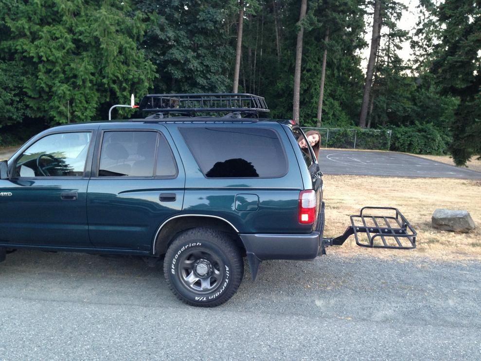

Scored a roof basket+cargo bag+trailer hitch carrier for an amazing deal.. I've been looking for one for so long! It was nice that the wait finally paid off.

I didn't realize my girlfriend was in both photos until now. I don't even remember her being near my truck at the time. Creepy.

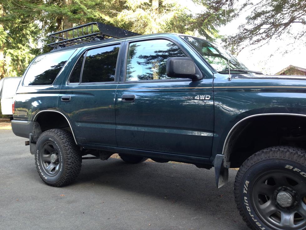

ORDERED A LIFT!! At long last I made up my mind: OME 881 front coils with OME Sport Shocks and top plate spacers, and OME 890 coils for the rear. I'm very much undecided on what shocks to run for the rear.. OME shocks are just so expensive... Has anyone had any luck with LC shocks and 890 coils? Is there a suitable model of Bilstein that will work? Any help would be awesome!
Lift installed!
Finally got around to installing my lift last night. Assembling the front struts had me nervous as the spring compressor I rented had obviously seen better days. My front struts were the originals and came apart ridiculously easy.. The top plate nut had no pressure on it at all once out of the truck. The rear springs were even worse- my truck was riding on the top cones.
Anyways, got all the old crap out and replaced it with OME 881s, 1/4" top plate spacers and sport shocks for the front. OME 890s and ProComp ES9000 for the rear. I gained 7" in ride height from the worn out stock coils. I still have to install the poly sway bar bushings and get an alignment, but I think the truck looks great. Next step: 16" wheels and 235 85r 16s.
Here's a photo as she sits now with 235 75r 15s.

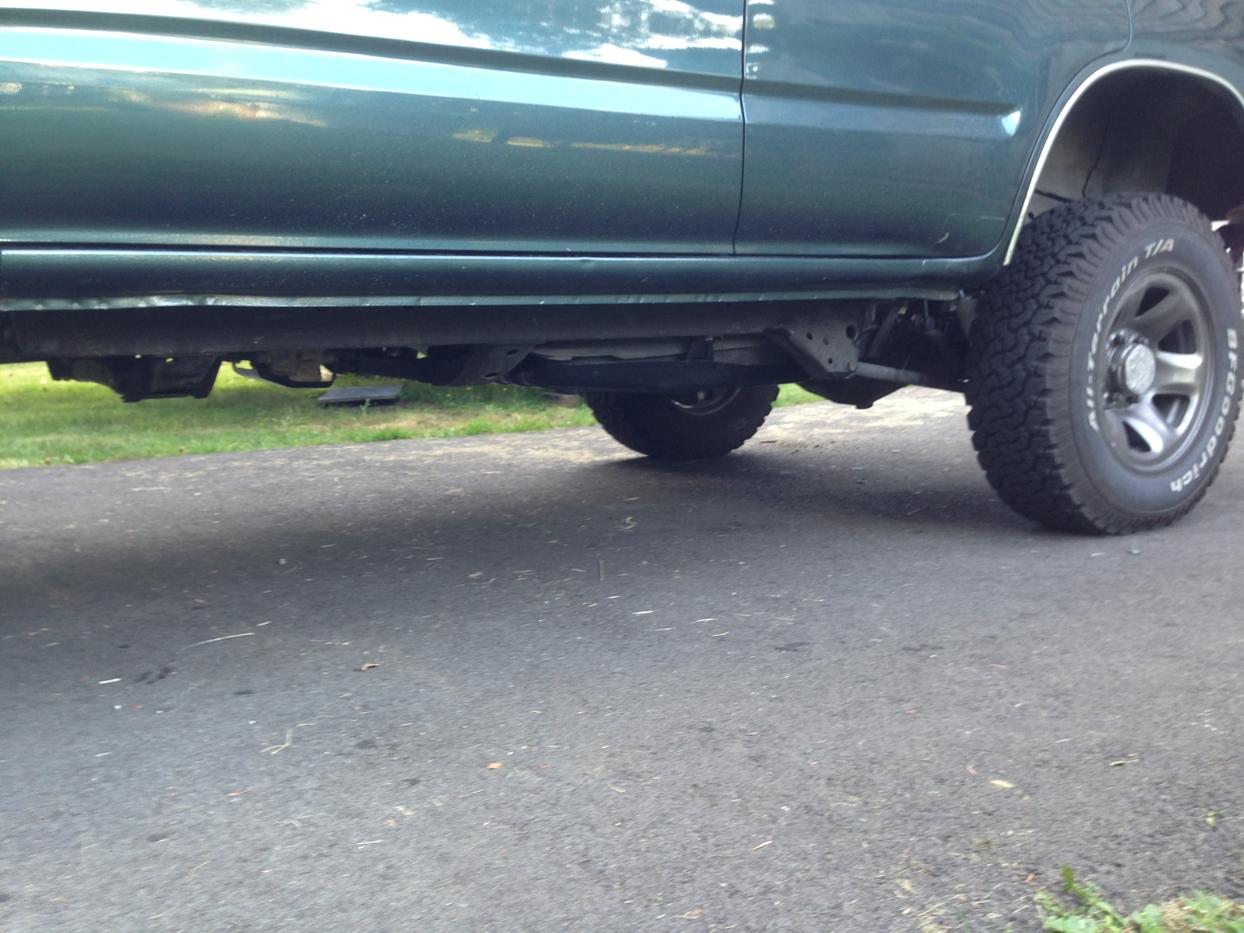

Wheeling in Mission
Went for a trek up Stave Lake forest service road near Mission BC to scope out some of my old dirt biking trails from when I was younger. Ended up finding some awesome lookouts and with those came good opportunities to take photos of my truck.

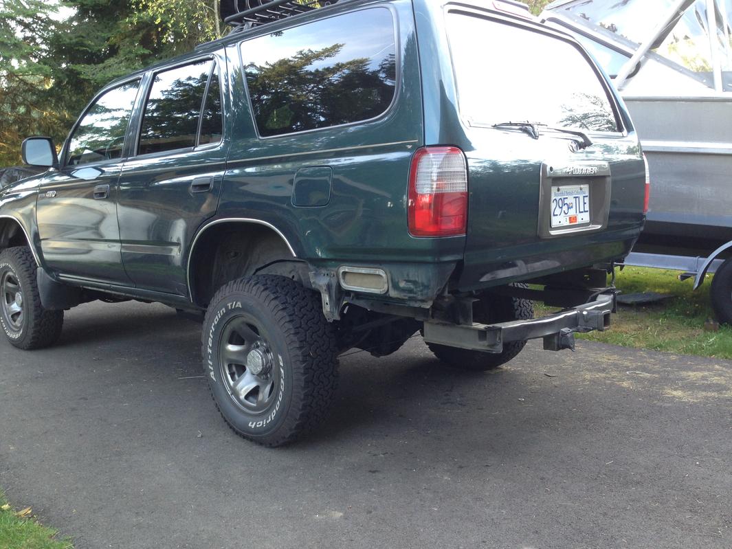

Got around to doing my annual rust prevention stuff. Focused on the skid plates- all of which were looking a little rough. I pulled everything off, wire brushed away rust, cleaned everything with acetone, painted on rustproofing and applied an epoxy based paint. I've not used the epoxy paint before, but I'm hoping it adheres well.

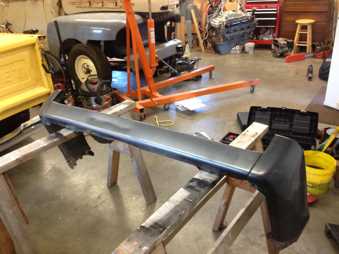

The only thing on my truck that really bothered be was the huge dent in the rear bumper left graciously by the previous owner. I decided it was time to do some bondo-ing. Most of the bolts that mount the rear bumper to the truck were pretty corroded so I had to be careful to avoid rounding the heads off.
