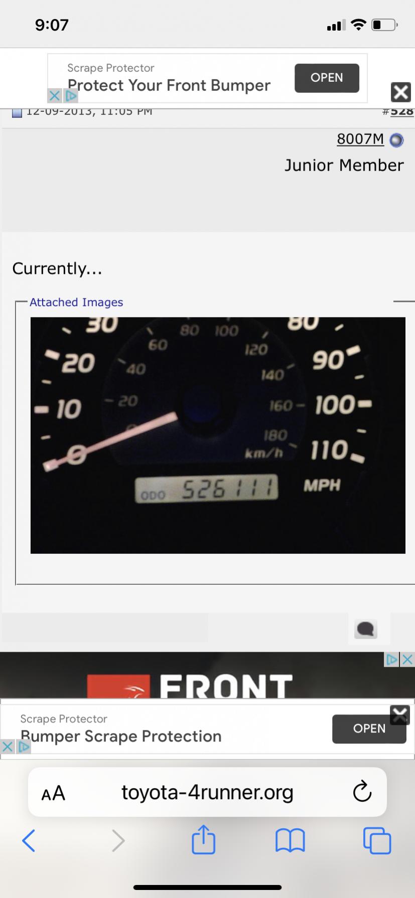

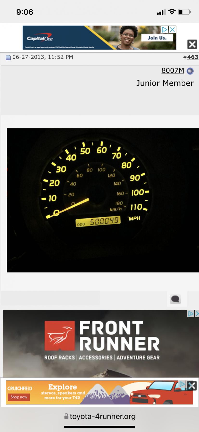

Just drive it. I would however get a second opinion, especially if you are looking at getting a new motor. I’m surprised at failing rings. I see these motors with 400/500 thousand miles on them. If you are going to spend that kind of money definitely get a second opinion!

Yup. These are pictures posted on this very forum! There are more but I did not want to take up too much space.
