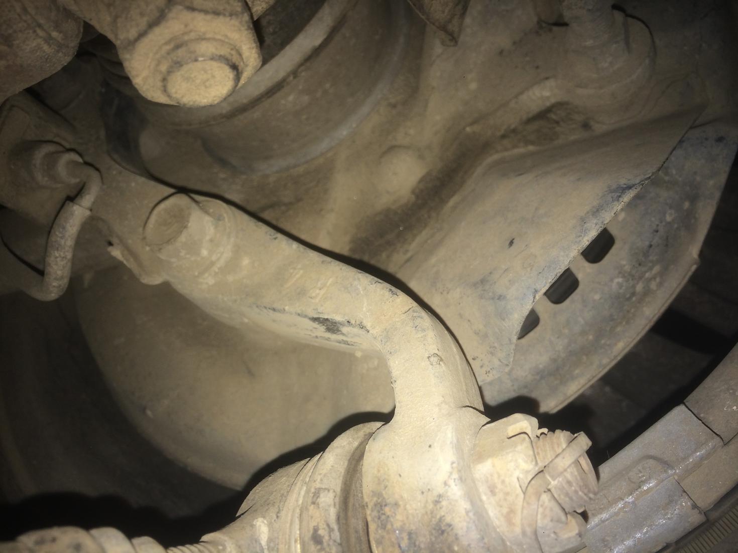

Hey everyone. It's probably a dumb question, but I had a bit of an oops in my runner and I'm wondering what this part here is. To be fair, my buddy who built his 1st gen has no clue what it's called. Any help is appreciated! IMG_2220[1].jpg Edit: Nvm. Part found and problem hopefully solved. Let's hope there's no surprises...
