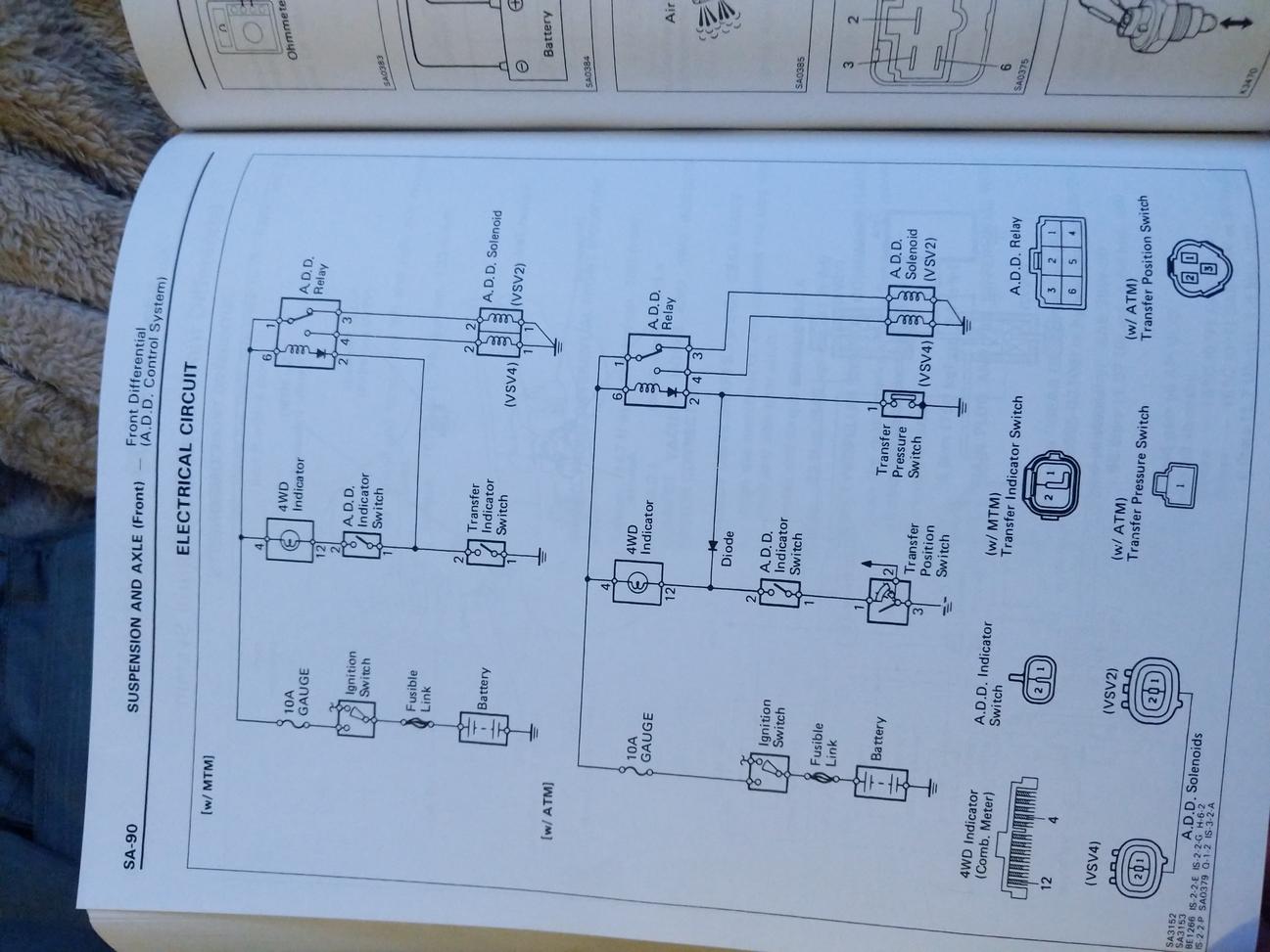

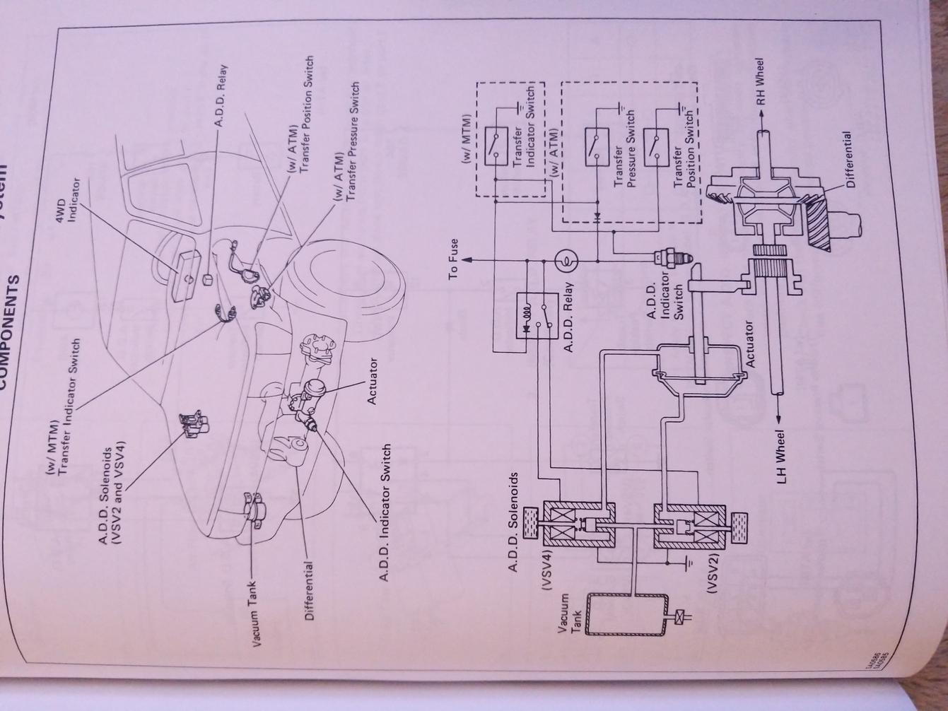

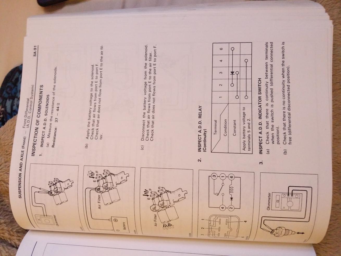

Hey guys new to the forum and the 4Runner world. I bought a used 1991 v6 and among the few issues I’ve had to fix the one that has given me the biggest problems is the ADD. I found one site that shows me how to lock it out (I’m assuming permanently) I’m just wondering if there’s a way to bypass using a cable lock or is it going to destroy my differential in all time 4wd? If there’s a thread for this already please point me in the right direction. Thank you
EDIT: Here's the first three pages about ADD pulled from Toyota FSM for Gen 2 Runner, if you need more let me know. Didn't feel like posting pages upon pages right away. I can't help you with practical knowledge sadly (and happily) I haven't had to work through ADD issues.
Phil
