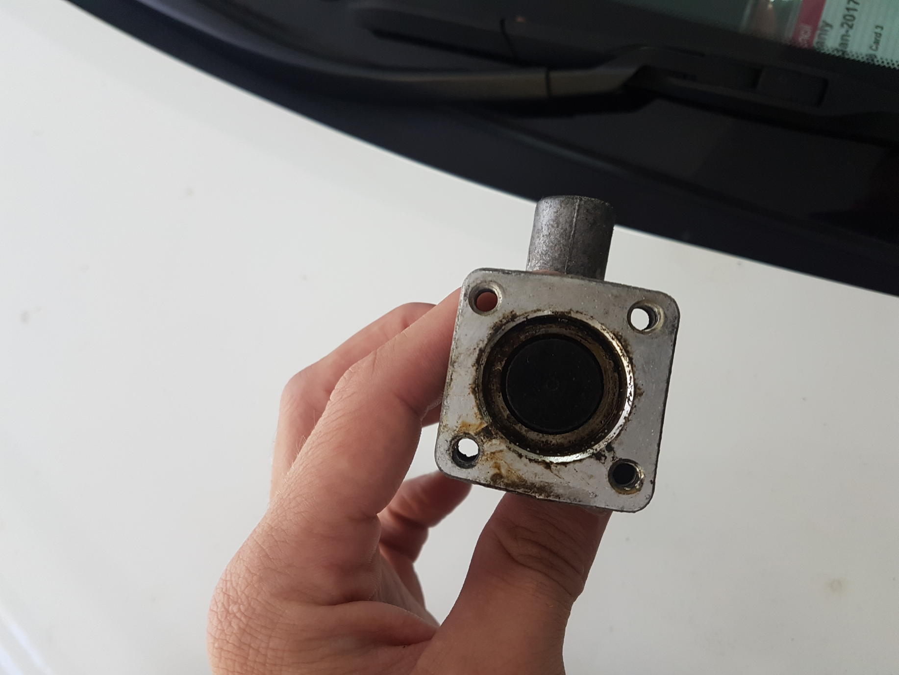

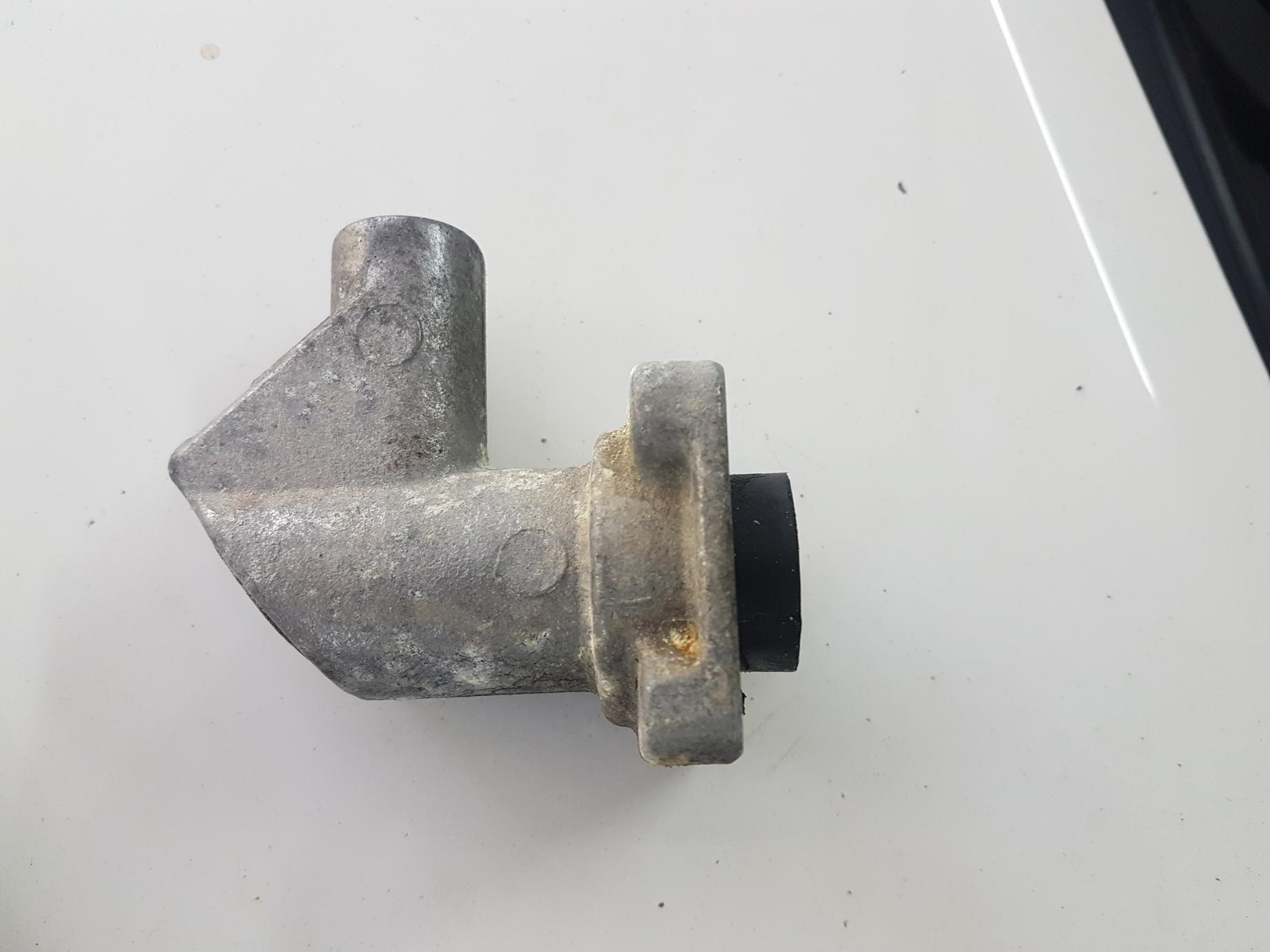

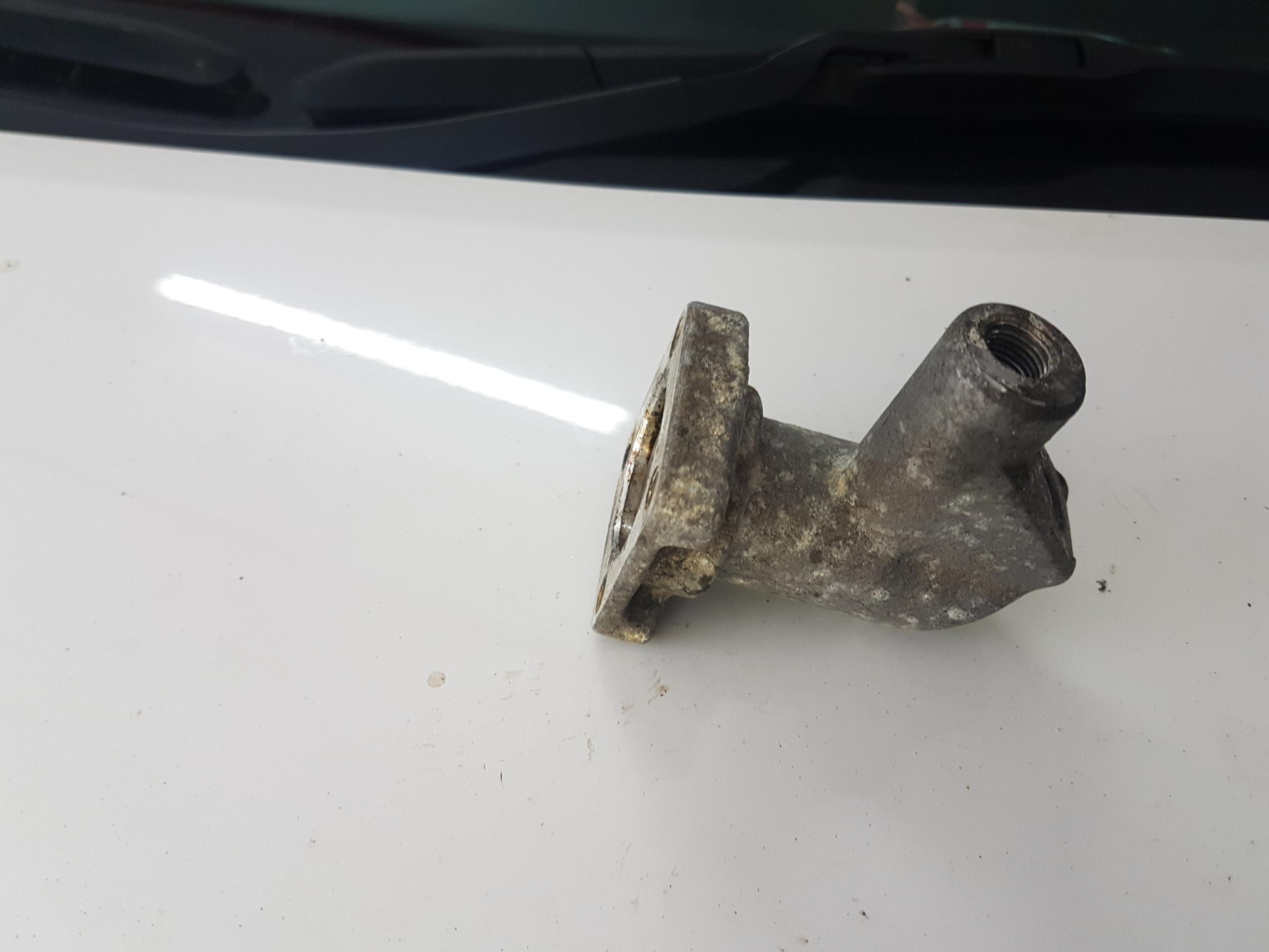

Part between Master cylinder and slave cylinder?
Hi guys,
I'm hoping you can assist me identify the name of this part which I need to replace. I have been unable to obtain the spare part as no one can tell me what its called!
Its part of the hydraulic clutch system. The fluid from the master cylinder through this part then to the slave cylinder. It sits on the right side of the engine bay. Virtually the same spot as the master cylinder but on the right side of the engine bay (as opposed to the left side where the master cylinder sits)
Vehicle - 1990 Toyota 4Runner
Engine - 2.8L Diesel
Thanks guys. Appreciate your help.
Mike.
