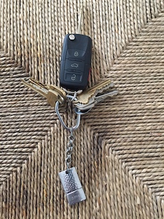

If anyone has one of these fabulous flip keys for your 4th gen and you break it (or jump in the pool with it in your pocket), don't throw it away!!! I ordered a new one, and was able to easily switch out the blade and chip, so I didn't have to have the new one cut or programmed!!!

Got my VW style TODAY! Went over to see my buddy, who works for Toyota, so he could program it.
He was like, "There's no way in hell that'll work on your 4Runner." I showed him this thread and the Ebay link. He absolutely couldn't believe it worked! He was flabbergasted when he got it programmed.
