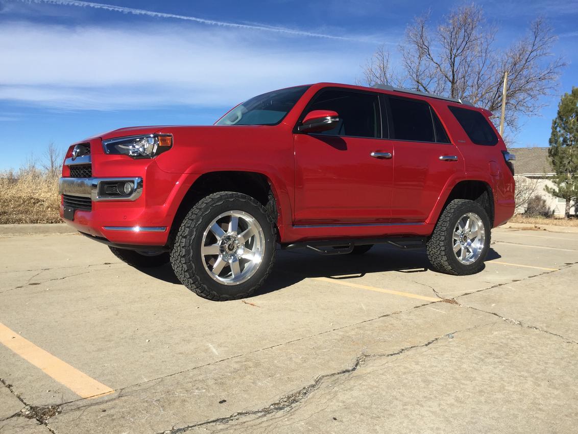

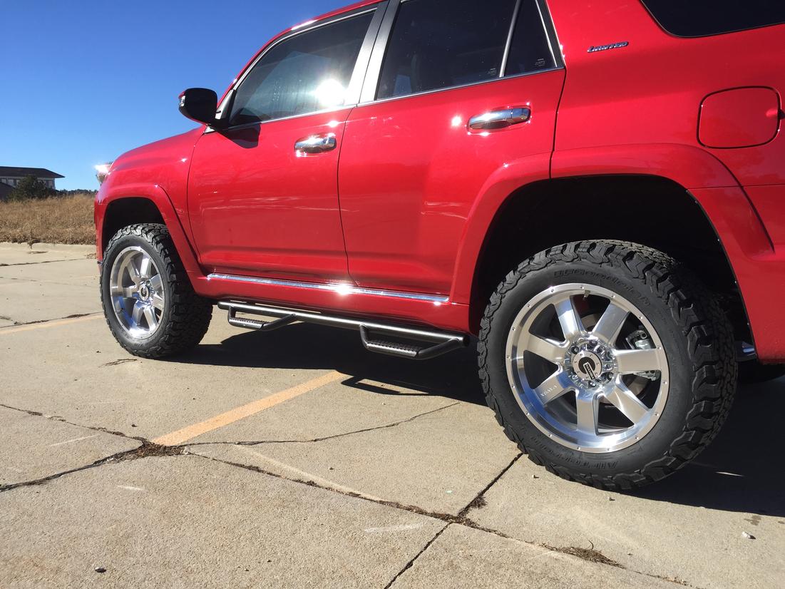

Perusing older posts - but anyone running 20x9 with -12 offset and a spacer lift... what size tires did you get away with?
FYI I'm sharing to add to the collection of knowledge and experience with going bigger on the stock 20" wheels...
Just put 275/55r20 on my '13 Limited stock rims. Continental CrossContact LX20 as a few others have. Tire shop seemed willing to put whatever tires that I wanted. Maybe that would have changed at install time. In any case, they seem great so far and definitely improve the look. Looks "normal" now. Ride quality is marginally improved and noise is same or quieter than previous Bridgestone Dueler HL Alenza plus at 245/60. Snow traction this past weekend was good to great for all-season tires. Overall I'm pleased with the change.
Thanks for all the great info in this and other threads.

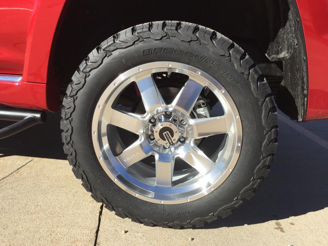

Mamba M14 20x9 -12 Machined
BFG KO2 275 55 20
Pro Comp spacer lift

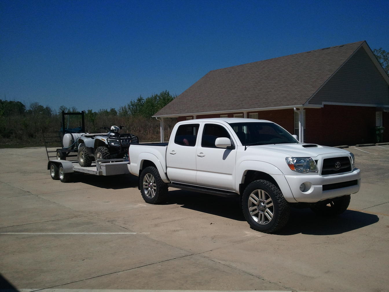

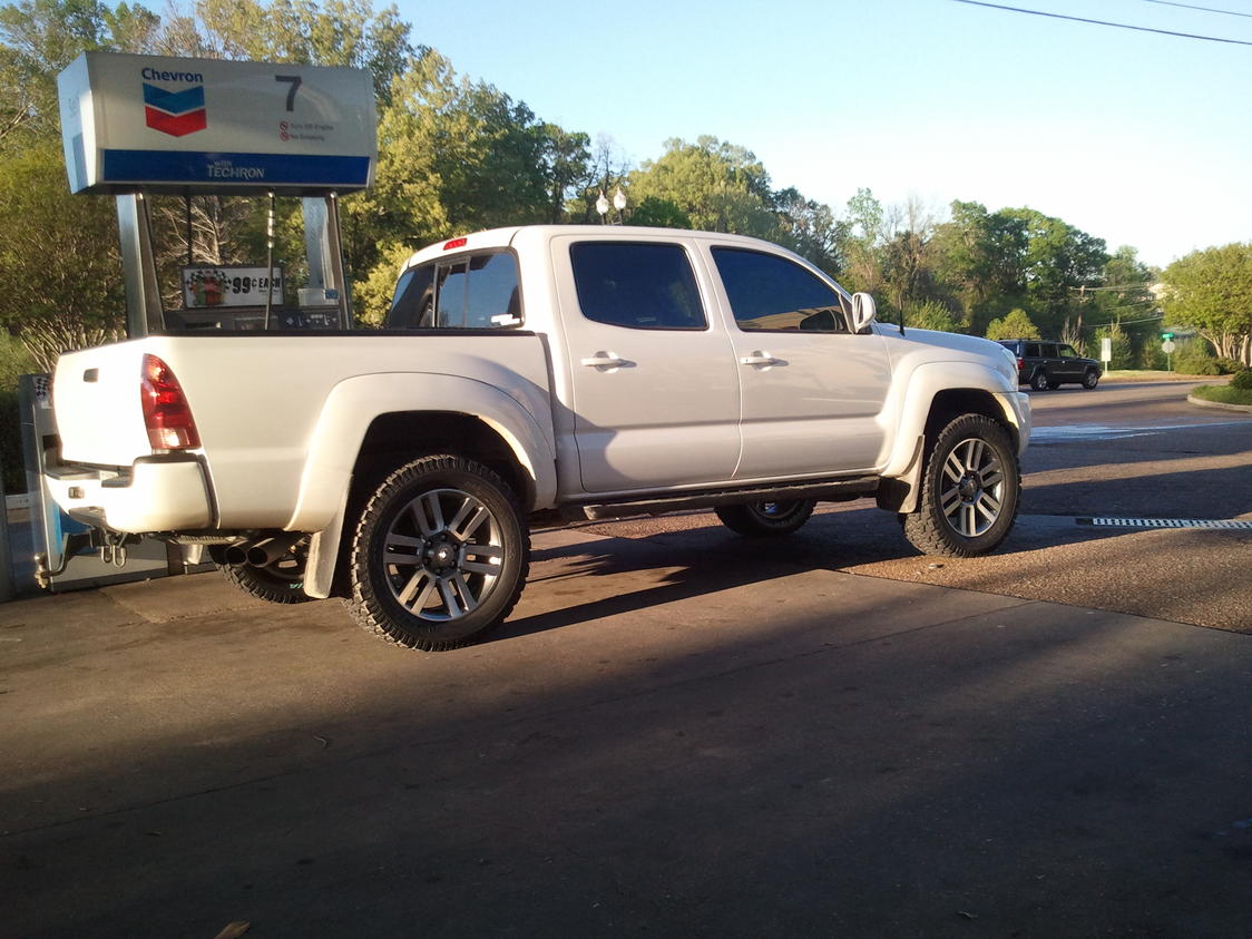

I put 285-55-20 on my wheels on my Tacoma back in March of 2012. After i bought the 4runner in December of 2012 i lifted the front in mid January 2013 and put a set of 285-55-20 BFgoody AT on it as well. My wife drives more than me and wore her set of BFgoodys out so i replaced her BFGoodys in January 2015 with a set of 305-50-20 General AT2 since BFgoodrich changed to the new AT design i didnt like them and i switched tires. Now i run a 305-50-20 General AT2 on my truck as well since i finally wore out the BFgoodys on my tacoma.
the 305-50-20 Generals ride WAY better than the BFGoody and i dont have to rebalance them every few months. i havent touched the set of 305-50-20s on my wifes 4runner, havent had to rebalance them or anything. they have been running flawlessly for almost 50,000 miles and have plenty of tread.
we both have been way wider and bigger than the OEM says you can and almost every tire shop in the world says you can. and we havent blown a wheel like we were told it would. i have about 80,000 miles on my truck with the stock limited wheels, wore out a set of 285 BFgoodys and then replaced with the wider 305 Generals and have about 15,000 on the generals on my truck. my wifes 4runner went about 65,000 on the BFgoodys and she has about 50-55,000 on the generals now. not a care in the world just smooth riding.

those pictured were the 285-55-20 BFGoodrich TA KO and surprisingly i have never taken a picture of the current 305s i looked thru my phone and didnt see anything. i will try to remember to post a picture tomorrow.

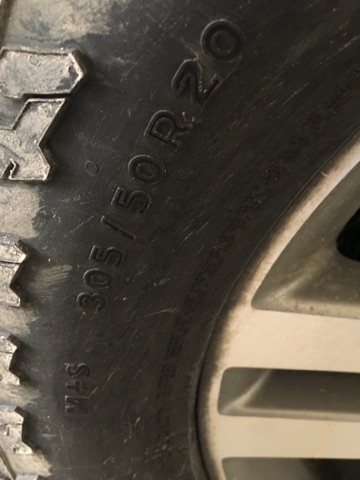

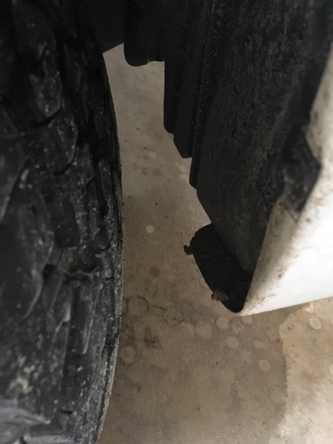

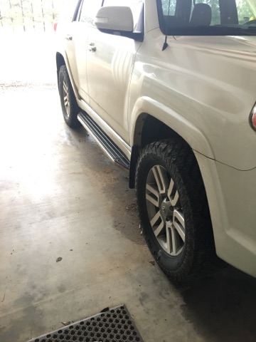

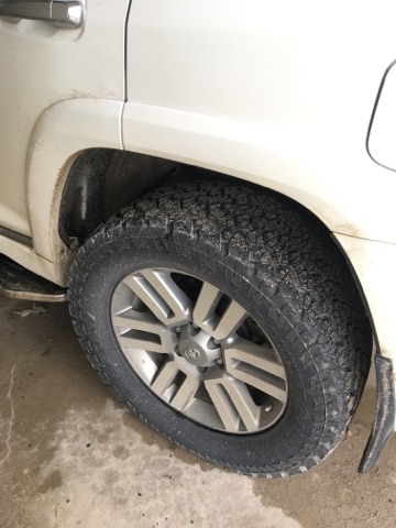

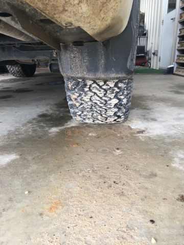

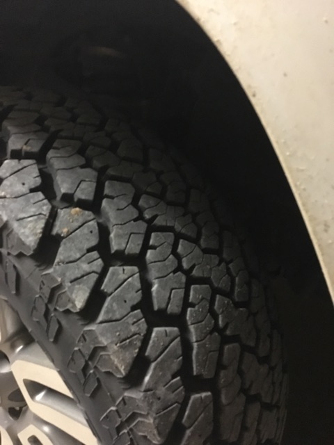

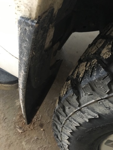

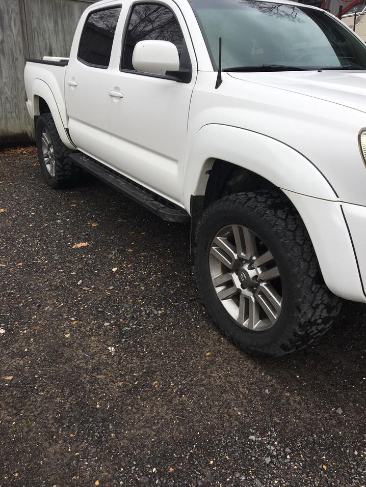

here at the General 305-50-20 on both of our vehicles. they ride great, last a long time, and look good. running 26psi in front on 4runner and 24 in the rear. the tires lay flat on the ground and wear evenly. sidewall temps are low even on hot days running thru the desert i think the highest i have seen was 130 degrees in arizona last summer when it was 115. sidewall temps are typically 110ish.
