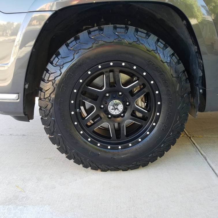

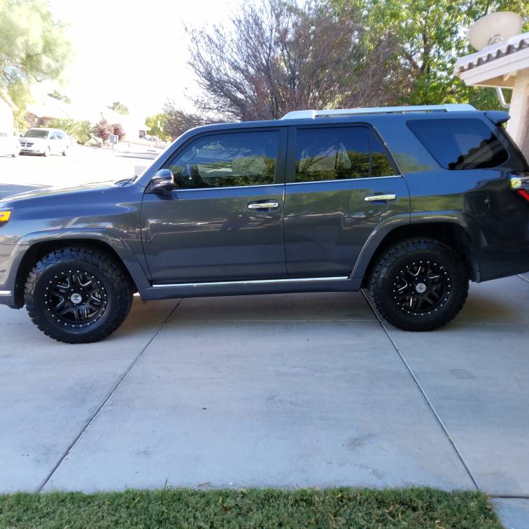

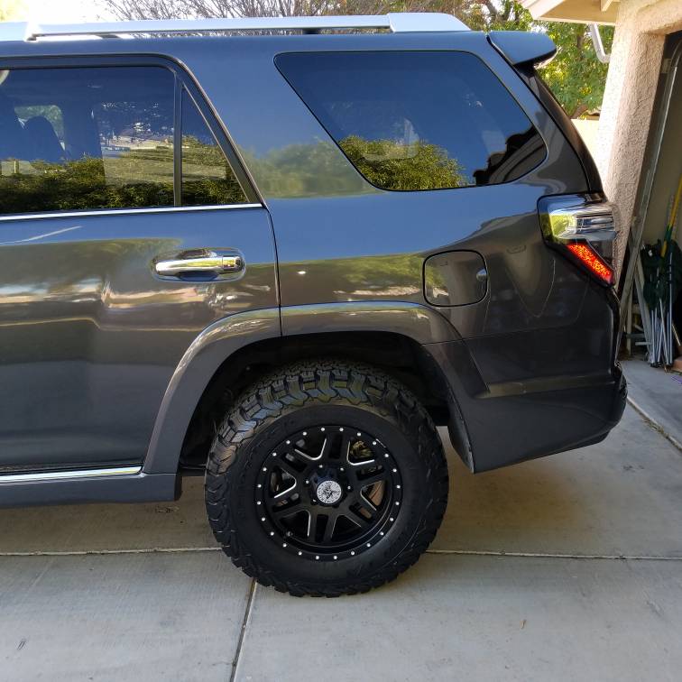

Thanks for the pic's!! I'm sold on some 275/55's! They totally change the look of the truck. What Toyota was thinking when they put such a skinny tire on a big truck is beyond me... :shrug:
Fuel efficiency most likely. Skinny tires = less friction = less effort to roll.
After seeing those pics, I know what my first major upgrade will be!
Couldn't stand the pizza cutters any longer. Went with BFG 265/60/r17.
