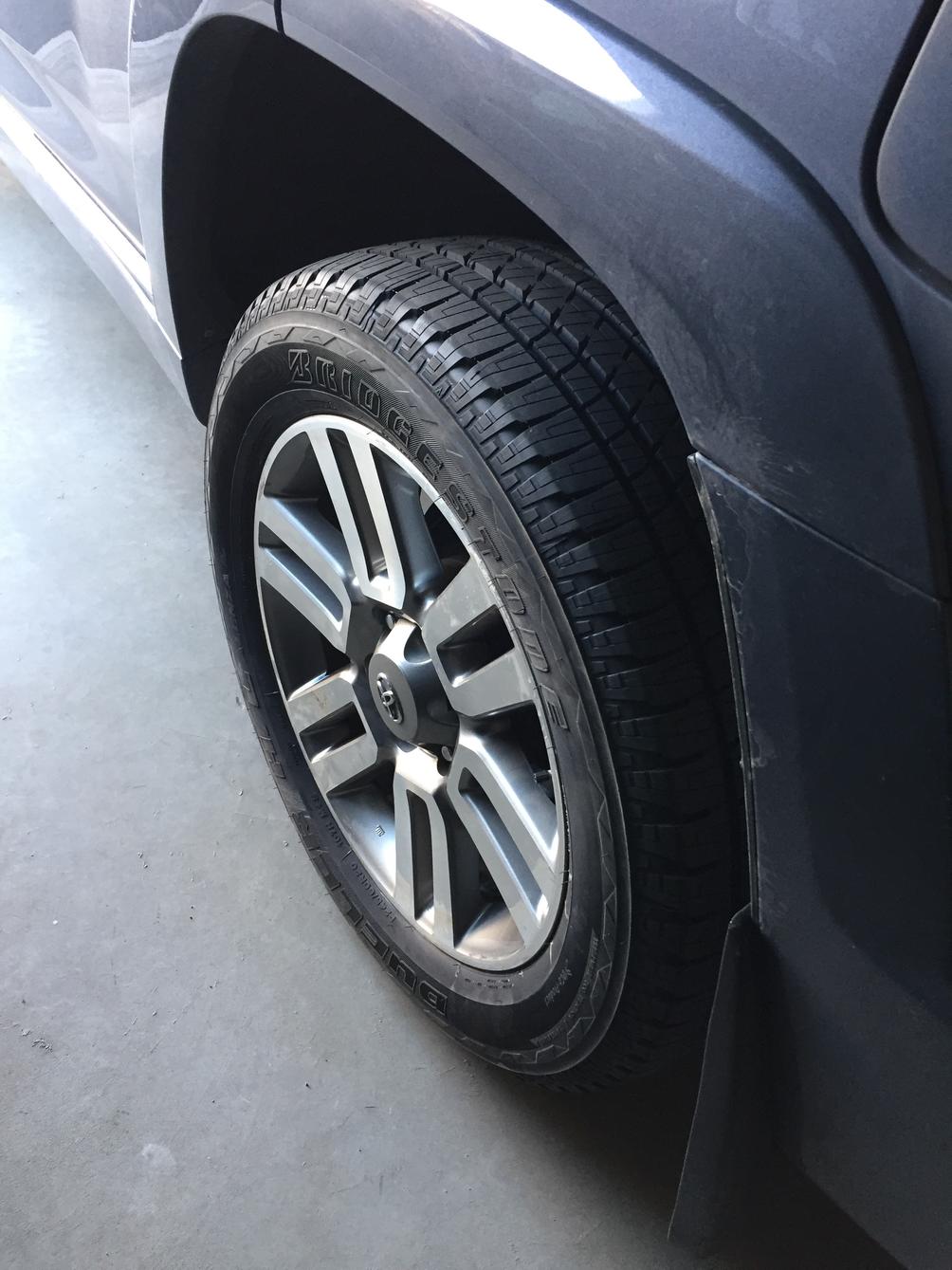

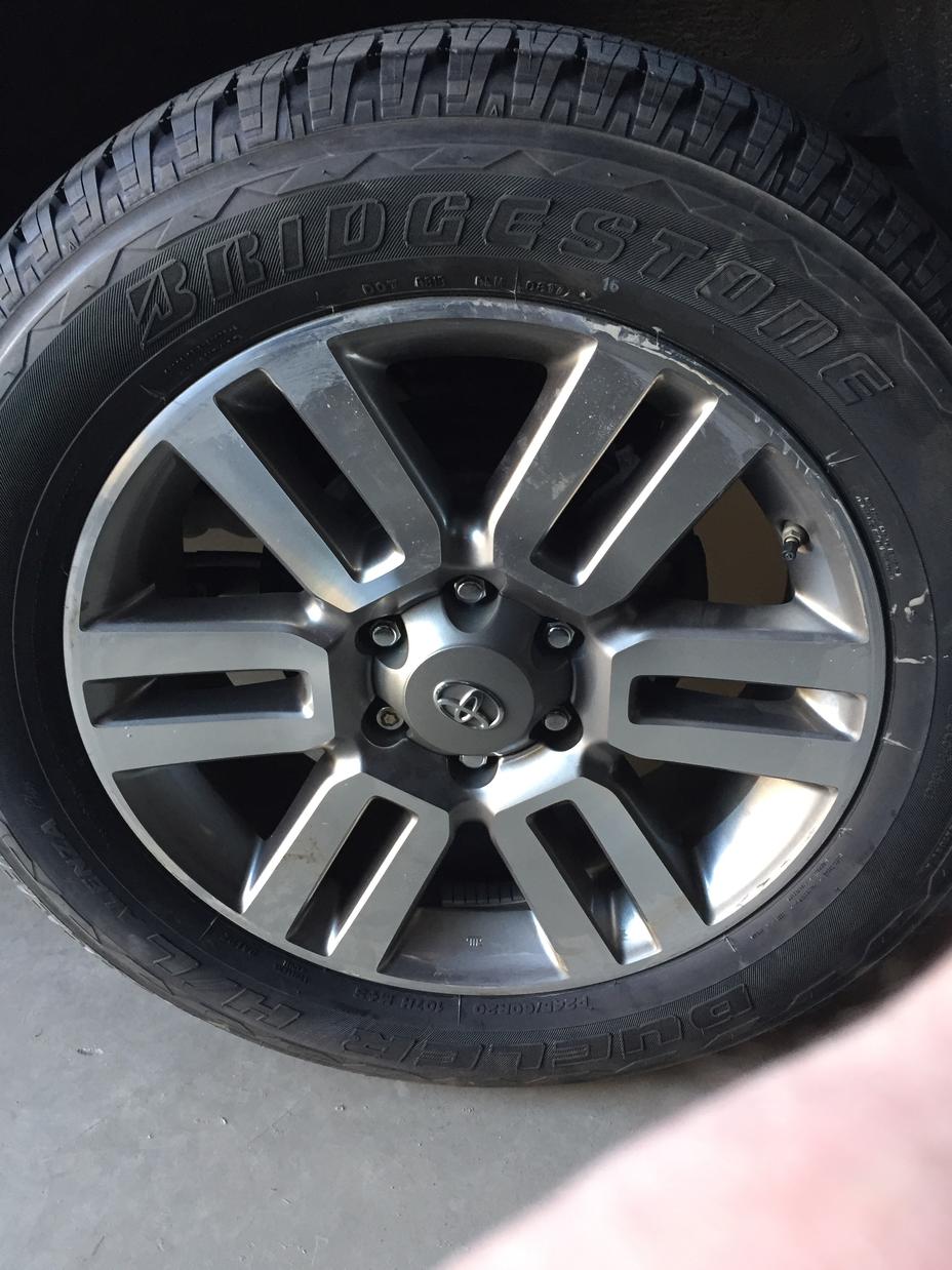

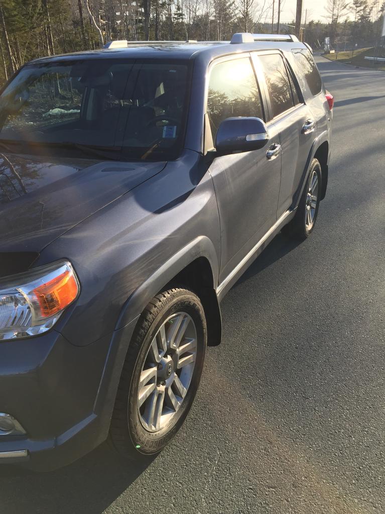

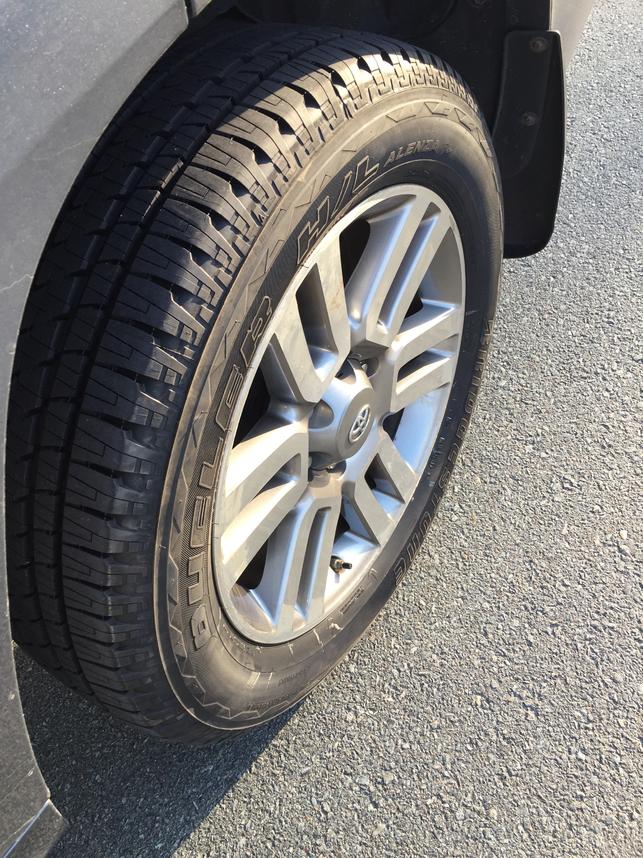

Got my Bridgestone Dueler Alenza Plus put on my 20's today (first day with the 20's back on post winter) and very happy so far. Had to spend a few minutes on the highway. Minimal wander, soft, good handling, and quiet. Was going to get Michelin Premier LTX's but the reviews online for the Alenza Pluses justified the lower price.
EDIT: I got OEM spec size (245/60/20). After a few more days I can say these tires are smooth. They really absorb harsh bumps/cracks in the road nicely, even on the highway.

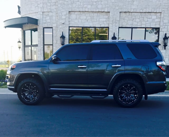

275/55/20 KO2 no rubbing. I've got +12 offset. Just got the front leveled today in this pic. But even before front level no issues.

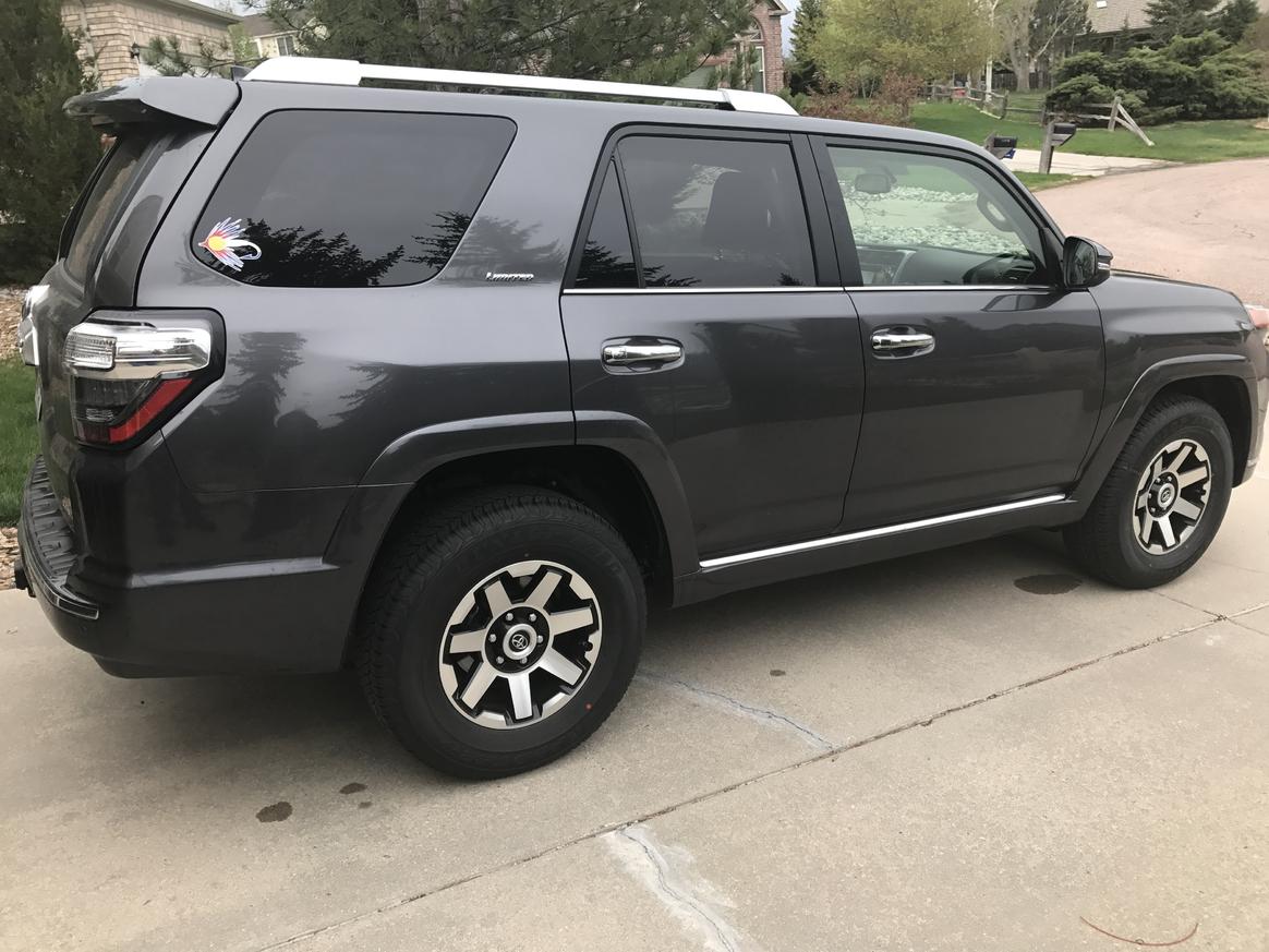

I didn't want to chance the extra width as I'm off-road somewhat frequently. I originally ordere 275 65 18 tires and level 8s from discount, but came across these takeoffs from a 2017 trail while getting an oil change. I paid 600 for wheels and tires at the dealer, the tires are serviceable for now. I think the wheels are more my style than the stock 20s...and it left nearly a grand in the bank to spend toward a proper lift.
