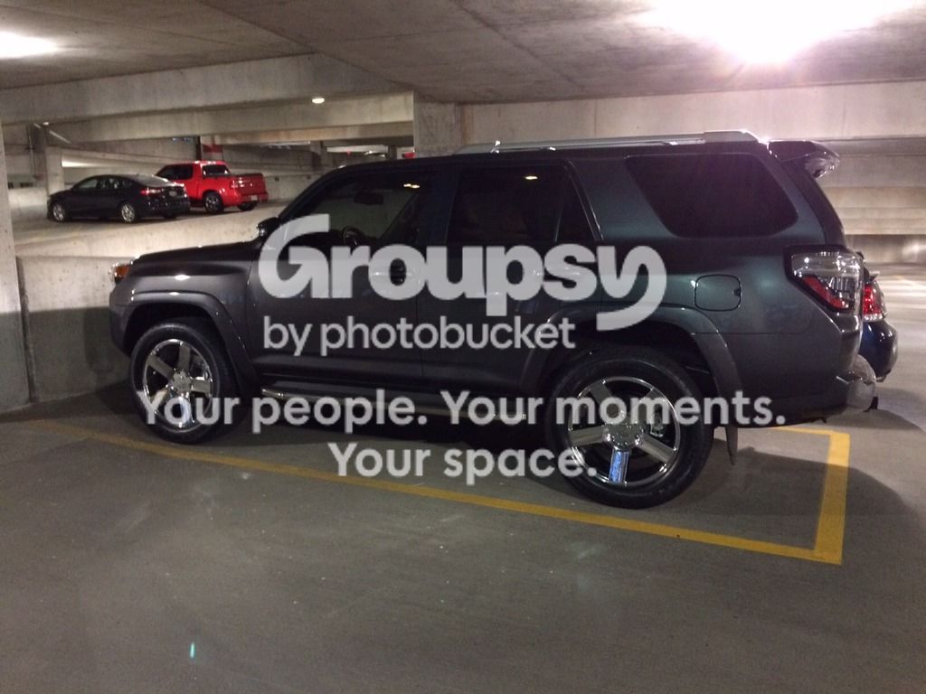

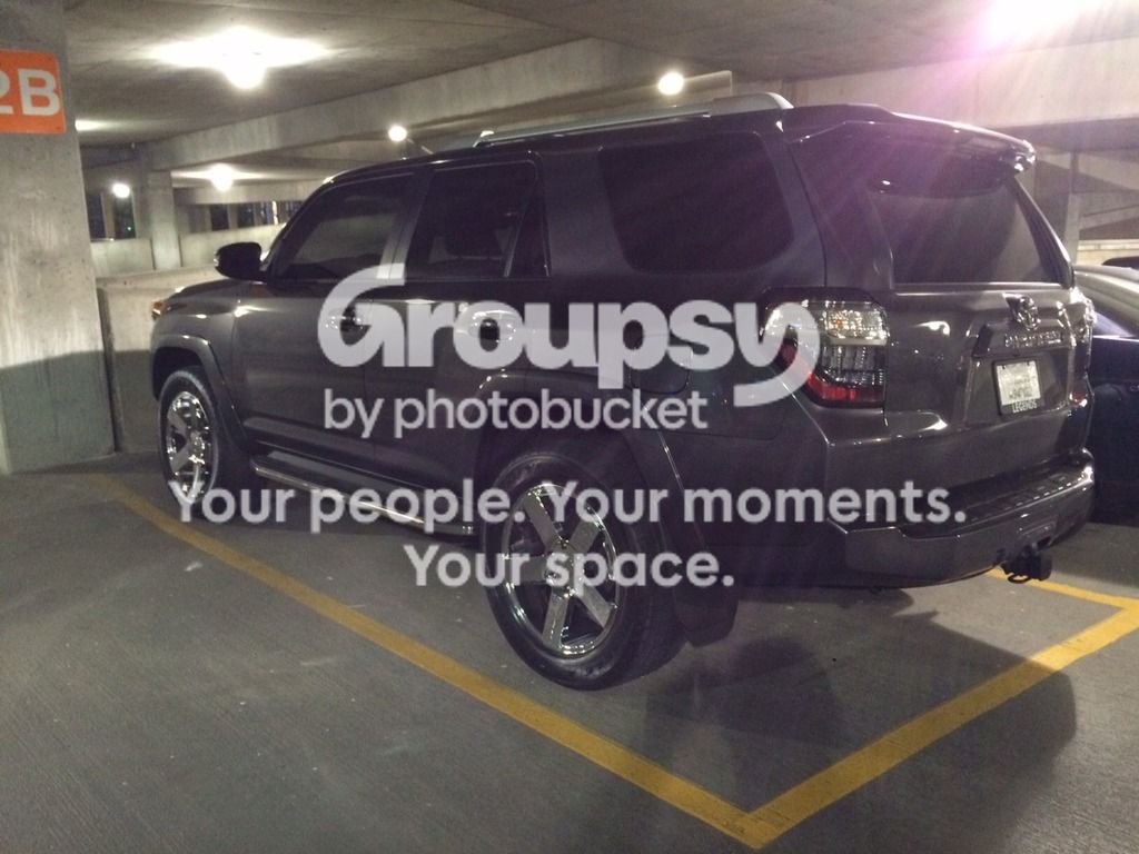

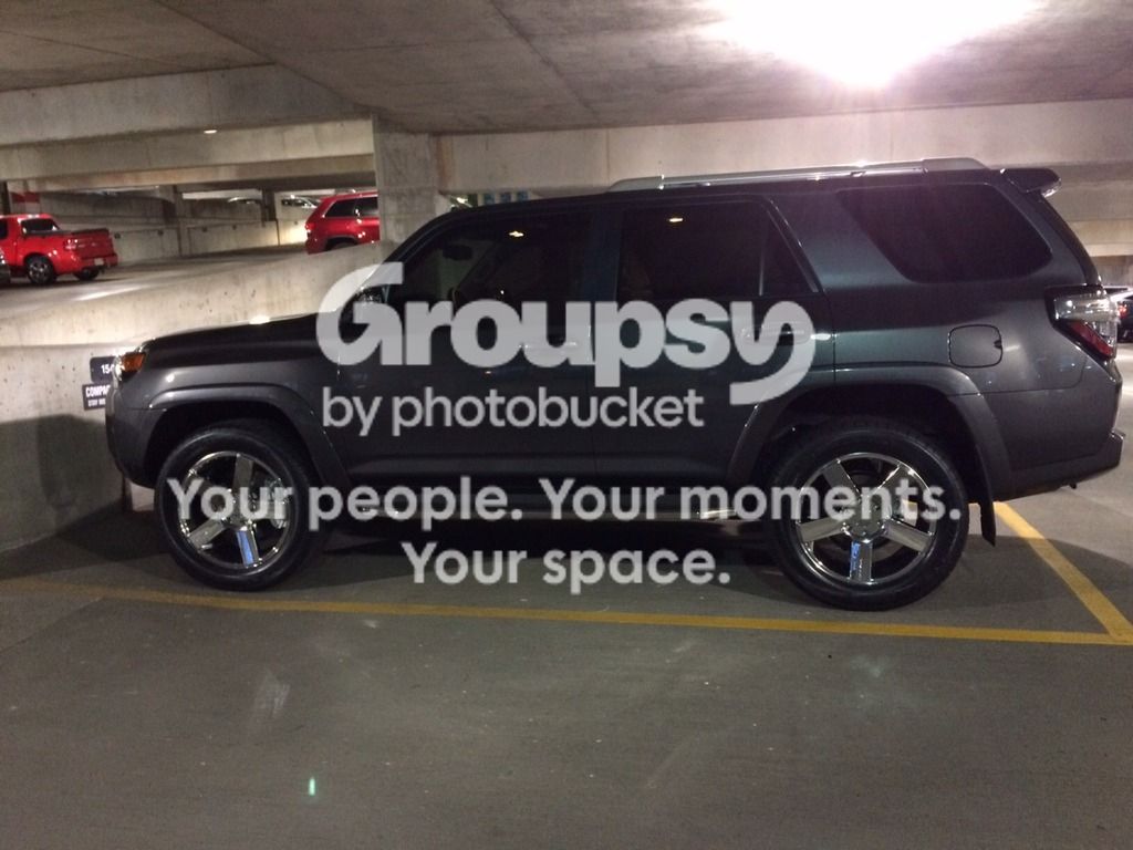

I've had no problem running Goodyear Eagle LS2 275/55/20 on KMC 20x8.5 +15 offset.
Sorry for the dark garage pics.
IMG_0832_zpsljk4knc8.jpg~original
IMG_0831_zpsnm16iwb1.jpg~original
IMG_0830_zpstjoybei1.jpg~original

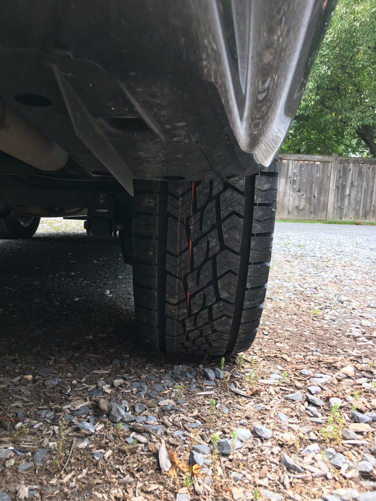

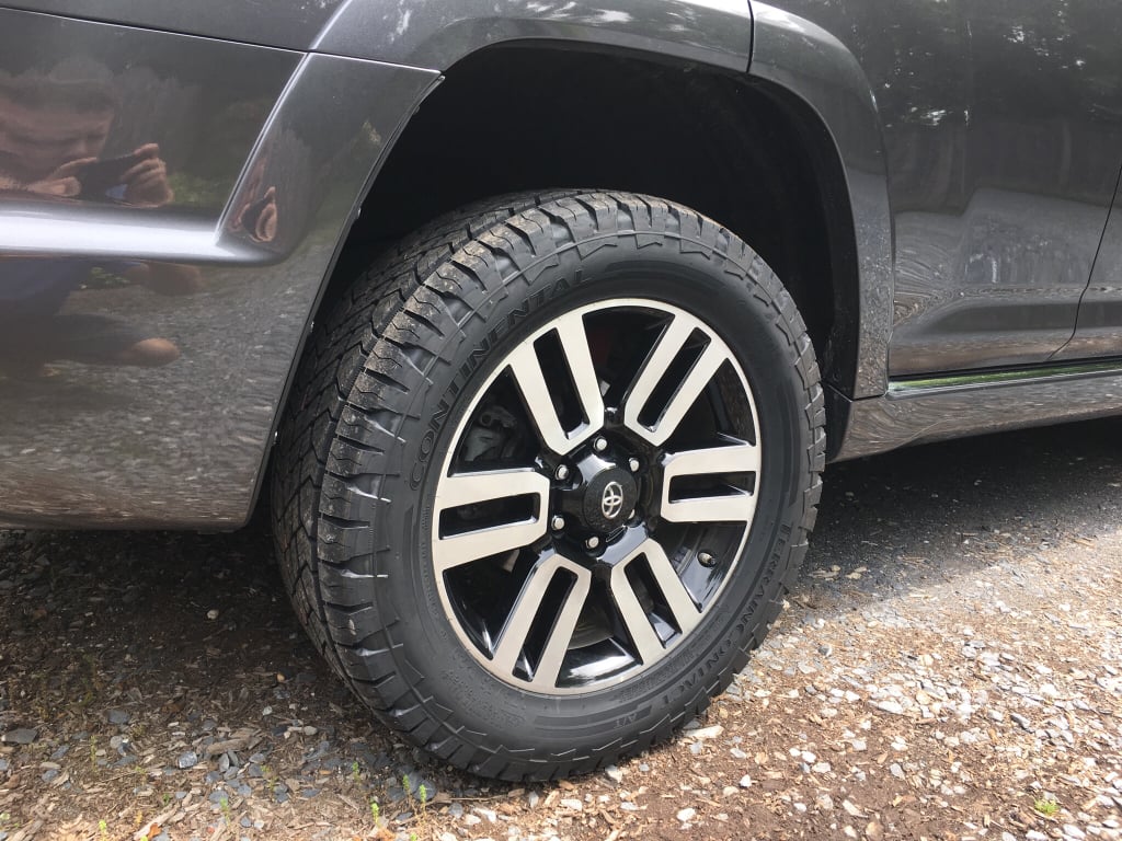

I just installed 275/55r20 Continental Terrain Contact tires on my 2015 Limited (stock wheel). Tires look great, but no real impressions yet because the OEM tires were very worn and any comparison wouldn't be fair. They aren't any louder than the Yokos which was a concern.

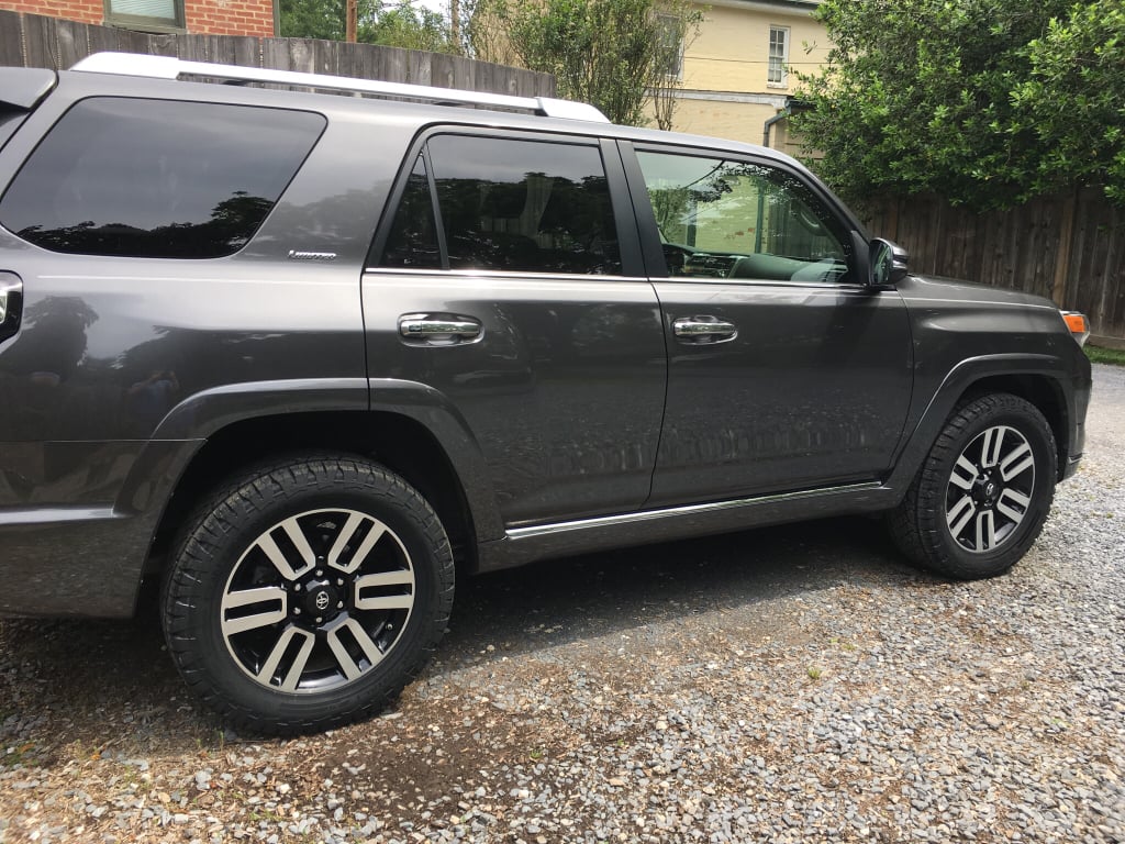

These look nice; I'd be interested to hear if they're capable off road. They certainly look better than the Geolanders, but are they enough for light duty?
They look really good in person, and I've been really happy with how quiet they are and general road manners. 1500 miles only, but off to a good start. Your 'light duty' definition might be different than mine, but I do drive gravel roads to get to bike trails and these have been fine. More confidence inspiring than the Michelin LTXs on my old GX470. Hope that helps!
