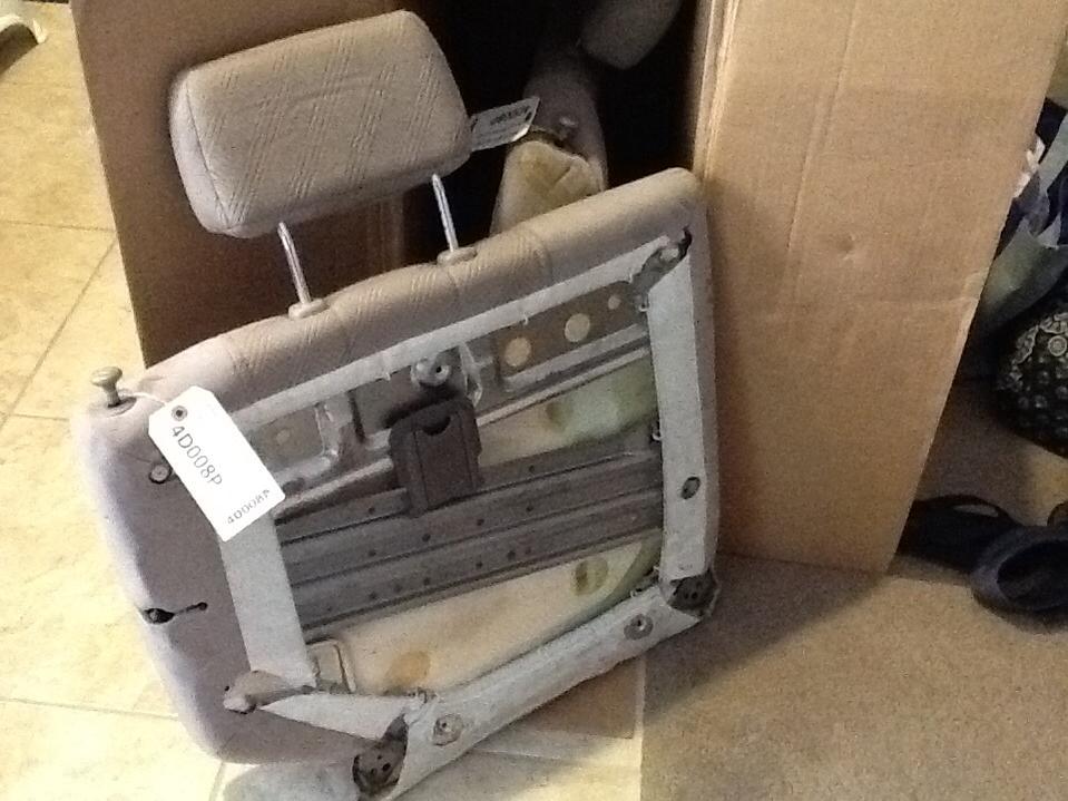

I don't know if there's an option for installing LATCH anchors in the seat cushion, but I have been on a quest on getting the rear tether anchors in my ride. One option is in my post which involves ordering the anchors from Toyota (use the part number in that post I referenced, not the one in your owner's manual. Already went down that road) and bolt them in the bolt holes in the middle of the cargo area.
I have ordered the upper rear seats from a '01 off ebay which will give me tether points for the rear outboard seats just like using the anchor points in the cargo area, only I won't be giving up any cargo space. I still have to swap my leather cover from my seat on to the new one, and cut out the anchor area from the carpeted and cardboard back cover.
What I haven't been able to figure out is the top tether anchor for the middle seat. I haven't been able to figure out if it's integrated in to the center pivot bracket, if it's part of the floor or something else. I've asked for pictures or clarification from someone with an '01 or '02 and I hope to get an answer soon. I have a feeling it's part of the rear center bracket, as the '01 & '02 have a different part number for that bracket compared to the '99 & '00 and it's more expensive, but the '98 has a different part number than the '99 & '00 and I don't know why. So I haven't ordered the $70 bracket yet because I haven't had confirmation that it will have the tether anchor.

Project tether install will be commencing shortly
