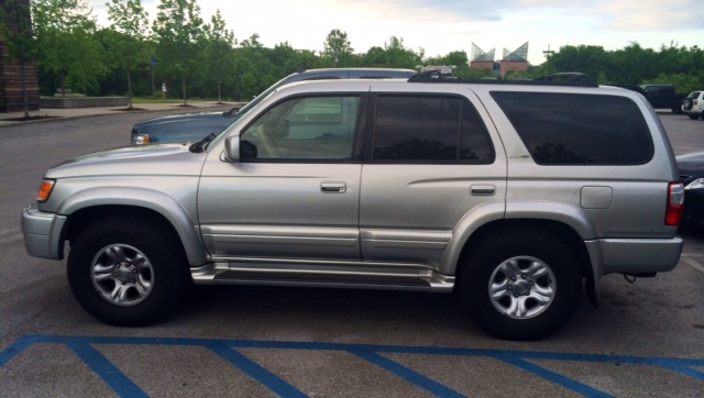

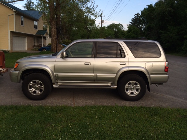

Update: I took the advise of MStudt and ordered the OME 880/906 complete setup. I also had TOYTECH assemble the struts and to my surprise everything was delivered in 4 days. Anyways here are the before and after pix.
BEFORE - look at that sag...
AFTER - up and level
Once the work was done I couldn't wait to drive it. I have to say I love it. I've put about 300miles on it so far and honestly I hope all the settling is over. I like the way it sits and rides as is.
