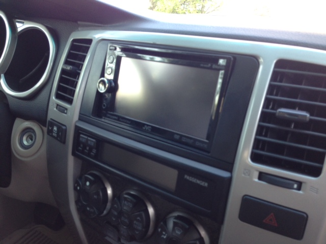

I have a JVC KW-AV61BT
used a Scosche trim kit. I am ok with the fit. Yes the new HU does not match the dash lines exactly, but it is aesthetically appealing nonetheless.

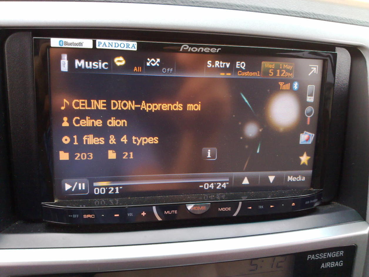

this is the pioneer avh4400, 2012 model, sitting in my 05 sr5........learnt the 2013 models are better
