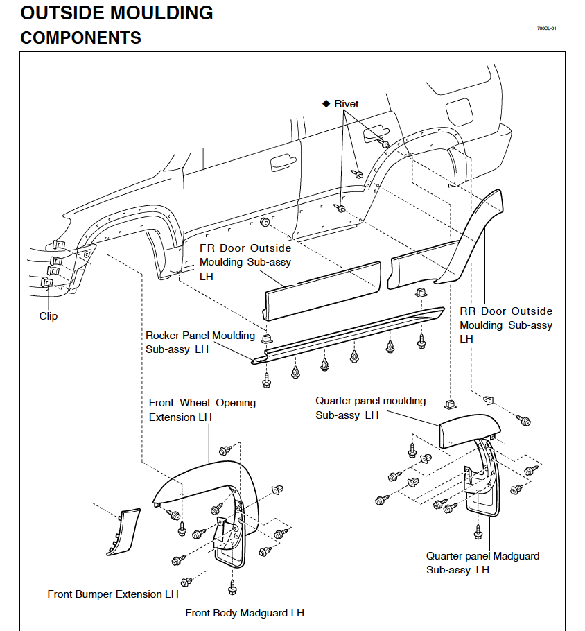

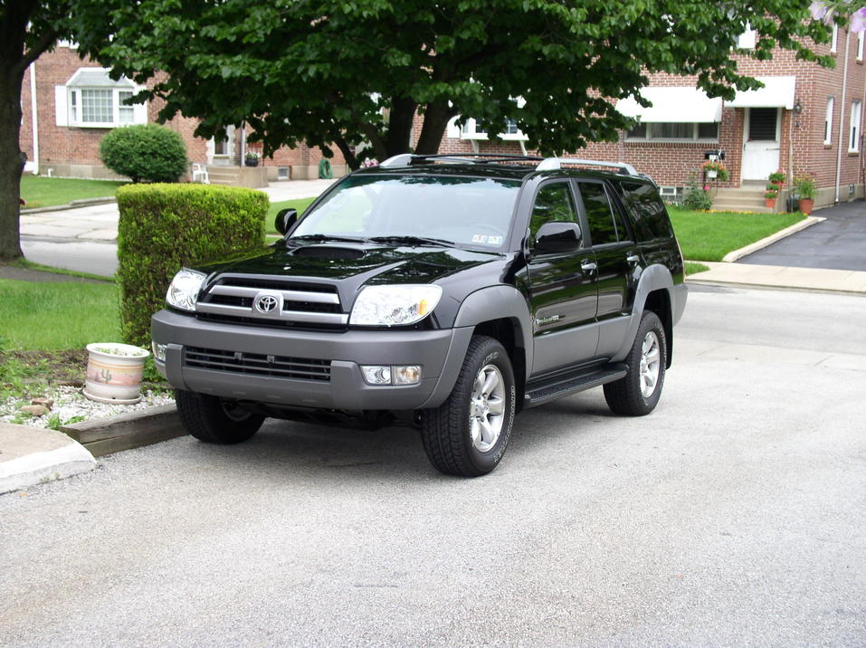

Hey, I need to remove the plastic moulding because the clips are breaking on the door moulding or flares. what tool should i use to remove the clips without scratching and what size clips ? I can see them and they are blue buts thats all i can go with when looking for them. The moulding is just the gray color and not painted.

Might want to post a pic because that's the least descriptive sentence ever.
I was just looking for a pic after I wrote it, new it was hard to understand.

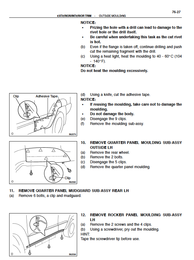

wrap the end of a pry bar with some electrical tape to pop them off? I bet your local auto shop probably has a part # to order more clips. just call em with your vehicle info

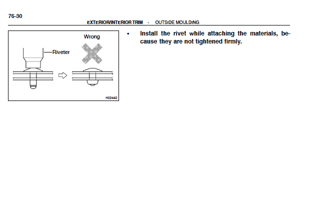

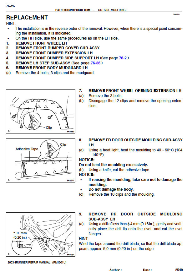

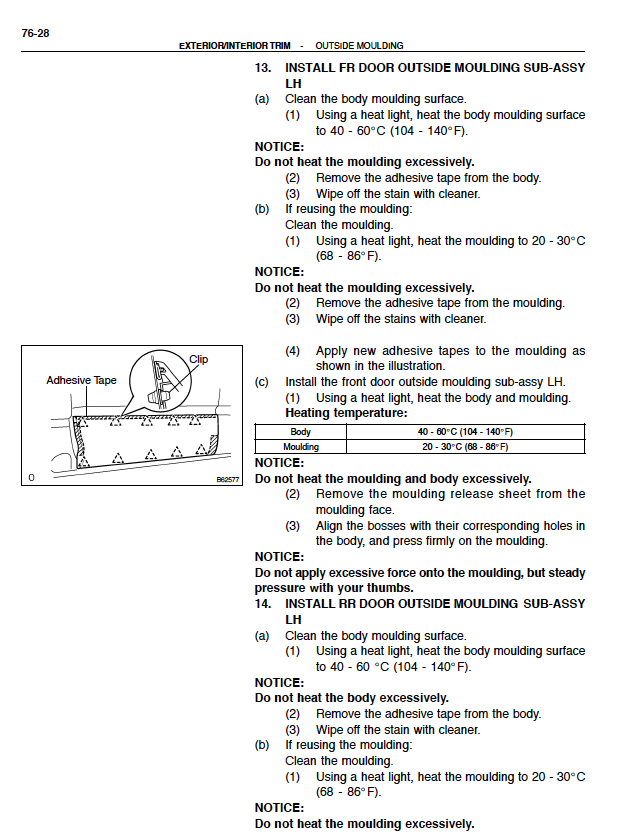

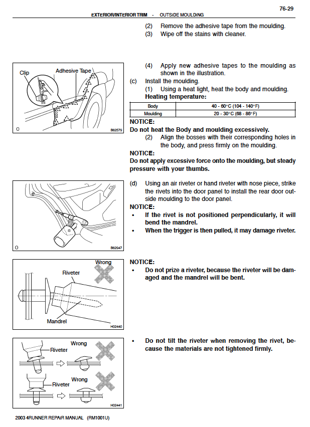

I agree with calling the local Toyota dealership for the parts you need. See below to get them off.
