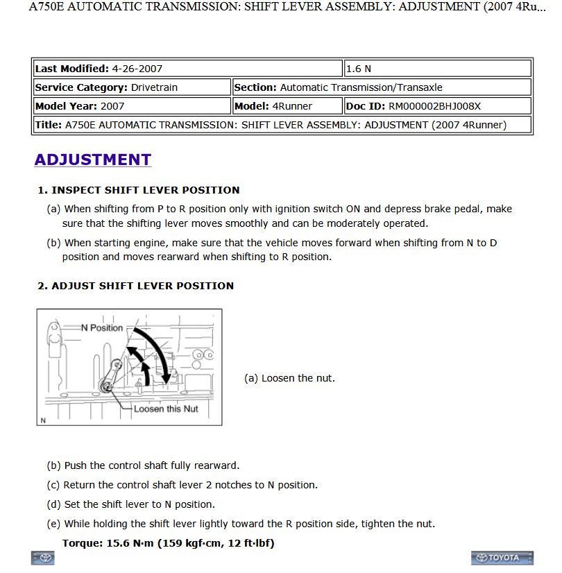

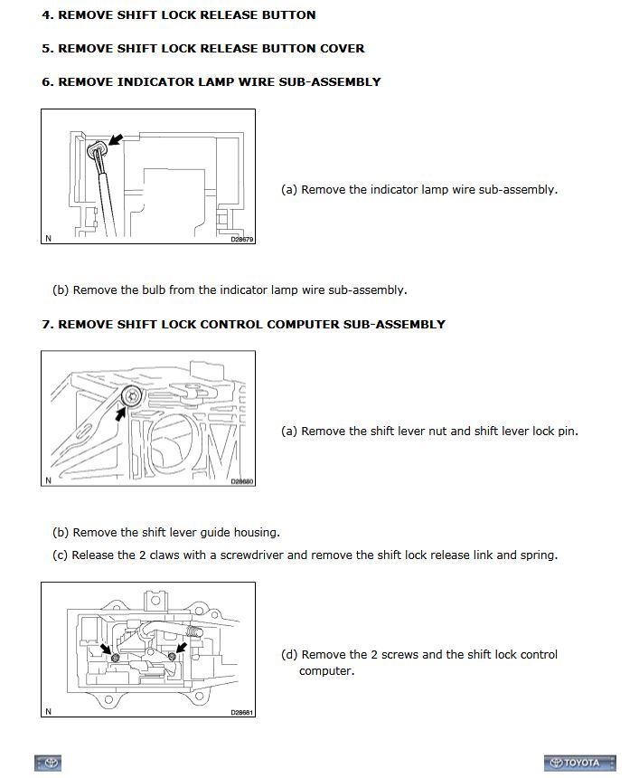

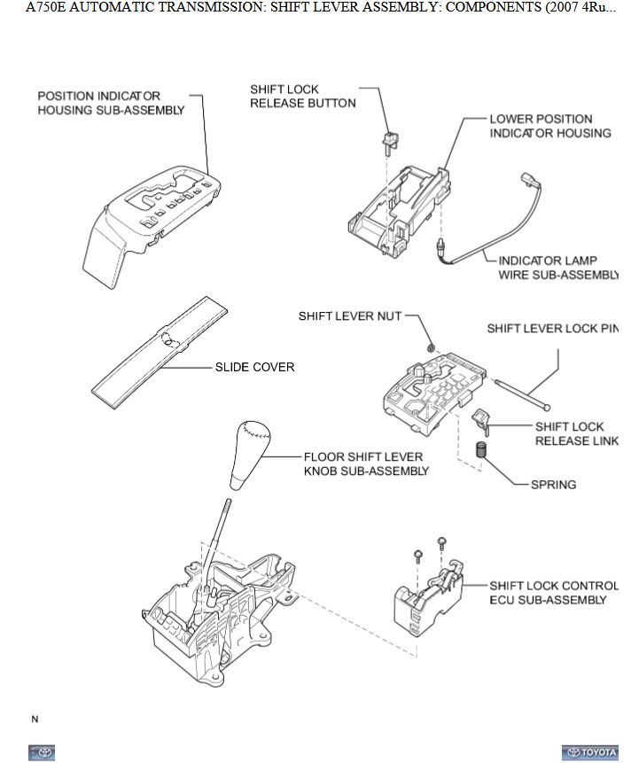

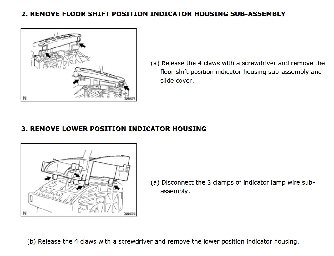

Recent shifting issue has my eyes open on these threads.
Thought i would toss these in here, 2007 T4R schems.
