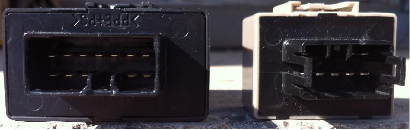

So it warmed up a bit and I pulled my dash apart and got to the flasher relay and realized I bought the wrong one as a replacement.

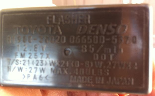

The stock OEM flasher relay is a 12 pin unit. I had an 8 pin unit, so I had to abort.
I quickly checked ebay and can't find an equivalent 12 pin LED flasher relay. What relays have you guys used to replace the stock one?
The stock one is 81980-35020 066500-5570
Here is a pic of the OEM one and then a comparison between the 8 pin and my stock one.

Hey SilverG's, I'm reviving this thing to see if you ever came up with a resolution regarding this? I'm going through this myself currently. Bought the old Tridon EP35 relay to start and realized that it was a fix for the 3rd gen. Now I'm coming across the 8-pin that you're showing above, and it clearly doesn't look like it'll plug with the harness.
So what now? In-line resistors?

Yep its down to in-line resistors
