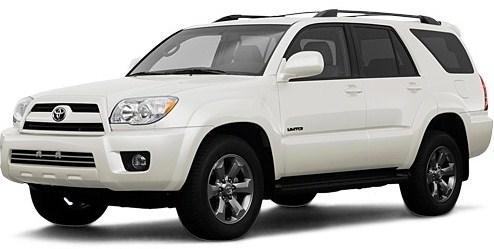

Need help please, sorry if this question has been asked before. I've done a lot of searching on this and was unable to find the exact answer I'm looking for. Here goes I have a 2008 limited 4runner with nav, its the V8 model with the tow hitch. What i want to do is put the RAS system on it, the 2 blank spots are there for the system. I do tow a motorcycle occasionally on the back, its not a trailer as all the weight is on the tongue. I'm not over weight on the tongue, but the 4runner really squats with it on the back. This does cause me stability issues at highway speeds. Also I do mild off roading nothing crazy just weekend warrior type stuff, dont wanna damage it. So i'm looking for a some help with this.:ybrick:
1 - With the RAS or (comparable) system will I lose the nice suspension ride I currently have with the stock setup on the 08 limited 4runner?
2 - Does the air ride system replace the springs and struts etc with air bags?
3 - Can you provide me with part numbers for the kit, and or anything that I would need to install a complete OEM system in as if it came from the factory with this option; Websites, part numbers, old links with this info, etc?
4 - Is there a better air system in the after market that you would recommend instead of the OEM one? If so can you provide a link or part numbers so i can research?
5 - This truck i just purchased within the last 6 months; it has 14K miles and the extended warranty. So i'm thinking it probably will have to be the OEM system as to not void the exteneded warranty on bumper to bumper & power train
Any help with this will be greatly appreciated, part numbers, website links, toyota pdf's, manauls, etc old post with all any info that coulfd help me. I apologize if this has been answered many times before, like i said i searched before and couldn't find something that fit exactly what I'm looking for that matched the setup I'm looking for. If you need any more info from me I will do my best to try and answer u. Thank you for all your help.:thanks::thanks:
