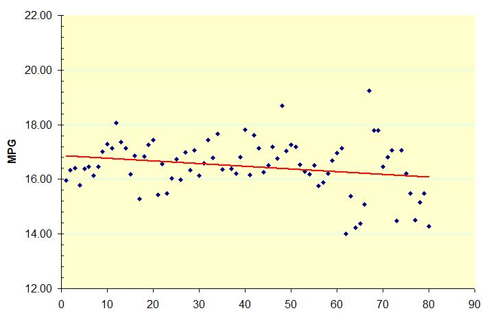

Anyone have any ideas why this is happening to my fuel economy?
This is the last 25k miles and 2 years, all maintenance done regularly. Driving habits haven't changed.

For the sake of statistical ease, lets pop out those outliers. Bad math or weird circumstances that cannot be a. repeated or b. nailed down can cause them.
Once we throw out the outliers, you have an obvious trend. Your slow, gradual down curve could be caused be a million little things that occur over time, that alone may not matter, but in combination add up to the percentage drop you are seeing.
Older tires, that have off inflation? Dirty air filter? Plugs?
I am obviously spitballing. You do not appear to have an instant, dramatic change (outliers disregarded)... and therefore it is really hard to speculate.
Edit: On second thought. Your mid graph highs are clearly outliers, but I am now not so sure about your end graph low scores.. You continue to see your average highs, but your lows are popping down.
If you get me the actual data. An excel or comma delimited file; I can run some numbers and see what is up. Also, can you get any more data points after your last set?
What I would like to see is some more data Further Along....... to see if those are outliers or in fact a new trend.

I can throw it in my stats program and take a look. I can already tell you, that those end point lows are skewing your average down. That we need to figure out. If you pull those several points out, I can already see just from spit balling, that you are well within accepted average. You have to assume that there are literally a thousand variables working at any time to factor in your MPG, so an up or down is expected. Which you see.

After looking at your numbers again, you may have an O2 sensor beginning to fail on you. Most of your numbers were relatively close to what I average in my 08 V8 until recently.
