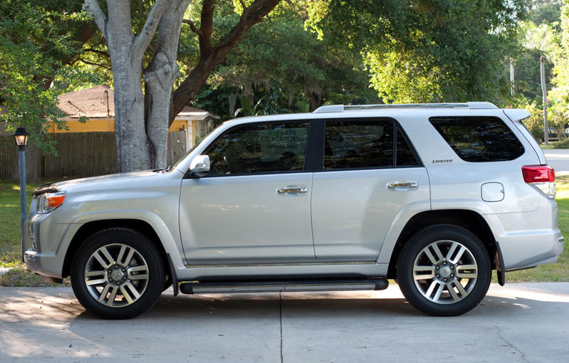

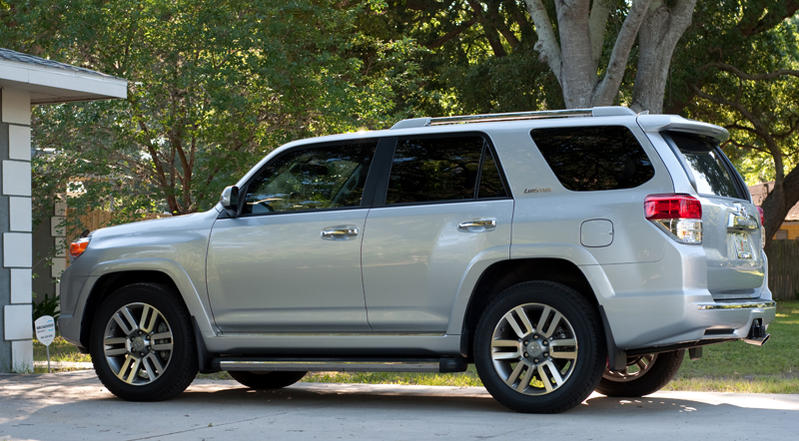

Here's my pics to prove it!

Looks nice, left the perfect gap between the front guard and sidestep, what is Toyota thinking, maybe I'll email them, there are other 5th gen owners unnecessarily being denied mudguards. It is so simple even a caveman can do it..:shrug:
