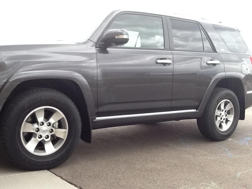

Thanks for the help. I got the front ones on this morning. I suppose pretty self explanatory once I got everything apart and lined up the guards on the 4Runner. Of course I received the instx after they were on, but good to know I did it right.
I do like it much better without the running boards, but I'm sure there are those that like it the other way around.

I purchased my T4R brand new and it came with the running boards. At the dealer in the parts department, they only have one type of running board for 5th gen which are the ones shown in my post. I purchased the mud flaps from Sparks Toyota. So as far as I know everything is OEM on my T4R.
Not sure how else to convince you. I'm in FL, but if you look at my pics, they are the same running boards on Terminators rig. And we both have pics of OEM mud flaps on a 5th gen with "OEM" running boards.

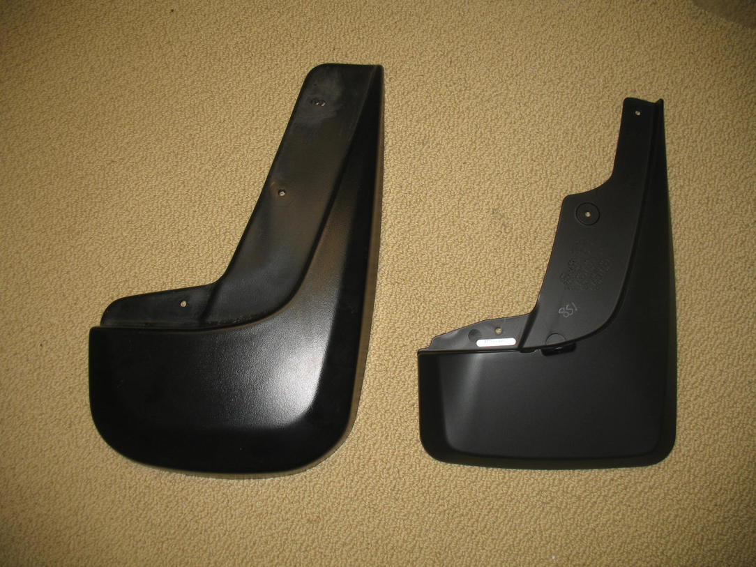

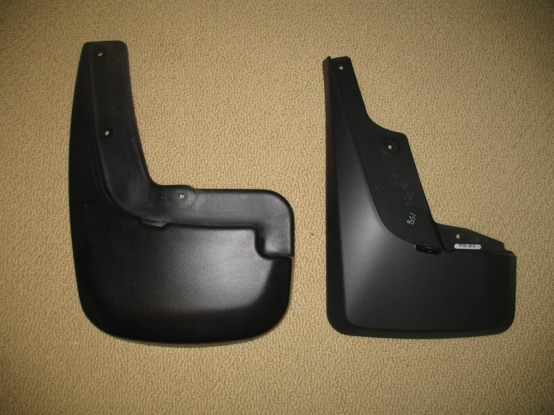

Last summer I installed the Husky mudflaps. At the time I beleive they were the best option available on the market. Today I installed the Toyota mud flaps. I do prefer the toyota mudflaps as they fit more securely and are a little smaller then the Husky's. The toyota mud flaps have an extra screw or pin on the back side that really makes a difference. I also measured teh ground clearence - 7.5 inches in the front and 10 in the back.
I do have the Husky mudflaps for sale - they are in great shape, no scratches on the outside and minor road stuff dings on the inside - $35 with free shipping if anyone is interested.
I also scratched on of my new toyota flaps during the install with the drill - front passenger side. So I ordered a new set. If any of you pull an oops like me I will have both rear and the driver front available for sale in about a week - say $25 each and free shipping if you need one.
I attached two photo's of the Husky and toyota mud flaps next to each other so if your considering which one to buy you can see the design and size difference.
