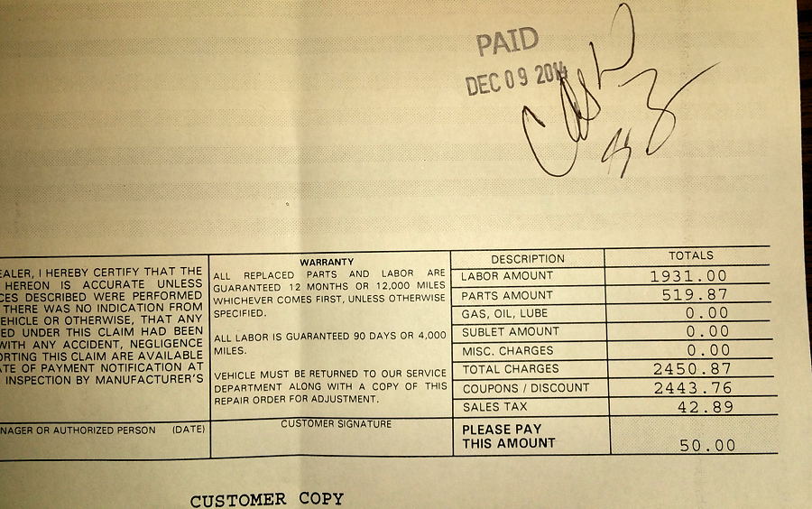

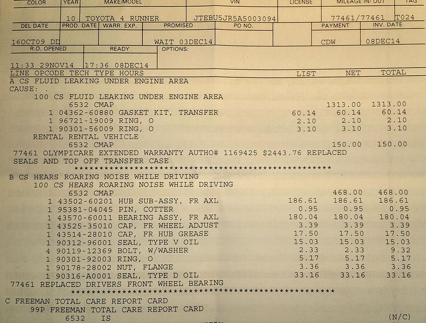

I just had my drivers side front wheel bearing replaced under extended warranty to go along with a transfer case seal kit at 77k miles.
I have severe dealerphobia and I finally got up the nerve to take it in with about 3 hours to spare on thee very last day of my 5 year warranty. I knew the wheel bearing was going for the last 5k or so miles and had transfer case front seal leak/seep. The front transfer case seal had been seeping for a couple of years but not enough to even drip on my garage floor so I was thinking they would say it was within leak limits.
I talked to the mechanic after his analysis that the transfer case leak was coming from the shifter actuator to tell him it's just the front seal and oil was being slung up there from the driveshaft. He rambled on about some shift actuator TSB seal kit that replaces them all anyways so he would just pull it and replace them all to make sure. Fine with me as I wasn't paying and it's not leaking now.
Also ,tried to talk him into to both front bearings to no avail as he said he ckecked the pass side and rears and they were fine.
Here are the parts used and what it would have cost without the extended warranty. You can see most of it is labor charges and I ended up just paying my $50 deductible . Back to running smooth and quiet!:dance:
