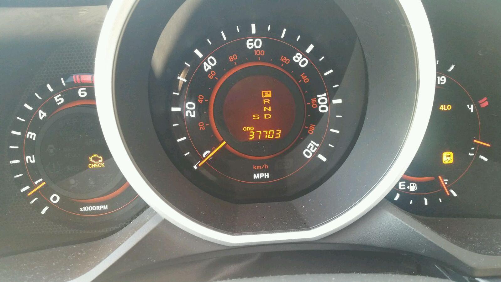

Are you sure about the 4Lo light being on? Because that is an oddball out of the usual ones.

No recent work...no aftermarket alarms....changed the battery out about 3 months ago. Here is a pic of the dash...

With the VSC and 4lo lights on, I think you have stored codes other than just the misfire. If you don't have access to techstream, I would take the vehicle to a Toyota dealership for diagnosis. Being under 60K miles, you are well within the powertrain, and possibly within goodwill of the bumper to bumper warranty.
Swapped coils, checked plugs and fuses...cleared codes, and disconnected battery....same code and lights came back....bummer. I guess I'll have to pay the stealership to figure it out... : [

Just wanted to give everyone an update on this issue: seems like a rodent of some sort chewed thru the wiring to the #4 cylinder coil. After looking close there is a spot on top of the engine, under the engine cover that is a really good nesting spot for small rodents. I will have to try and figure out a way to keep them out of there...
