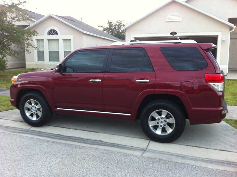

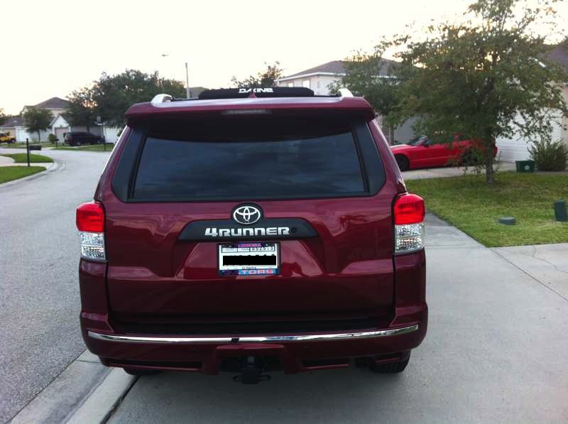

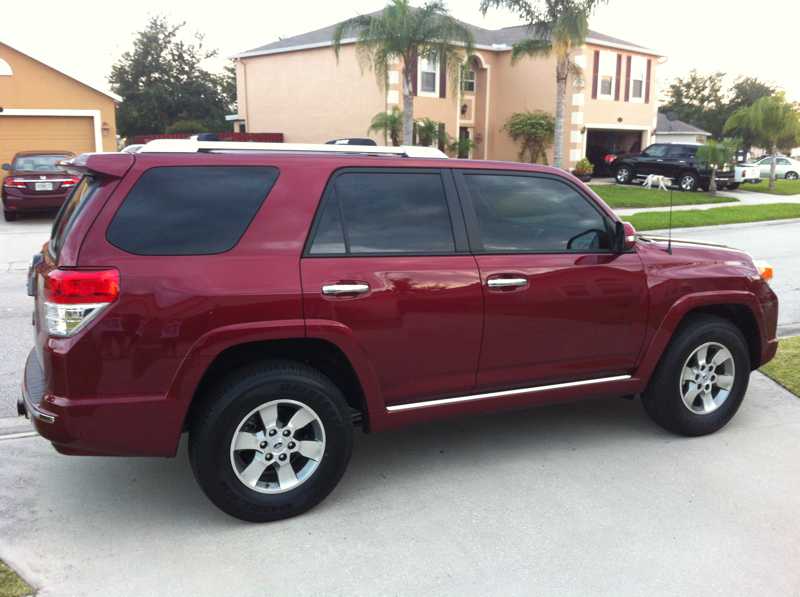

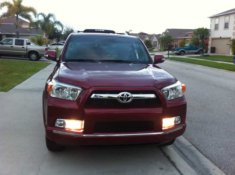

Hope this helps. The pics don't do it justice but it looks perfectly uniform in person and during the day I can not tell any difference from the front to back (and I have a mild case of OCD).
We had 15% Llumar ceramic installed up front, 50% Llumar ceramic over the rear factory tint, Air Blue windshield/sunroof with 5" 15% strip across top of windshield. Everything looks uniform and keeps it sooo much cooler. All for $310.

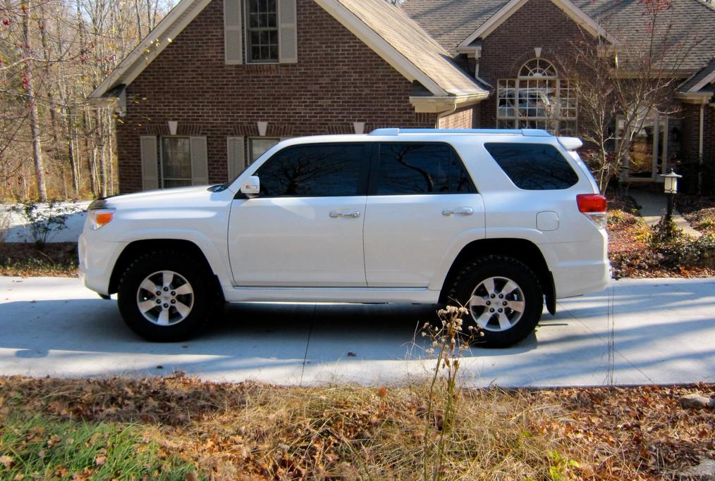

I had 30 installed over the windows behind the driver, and 15 up front. Not going to lie, it is hard to see at night for me..... but it sure cuts down on sunshine and prying eyes.
