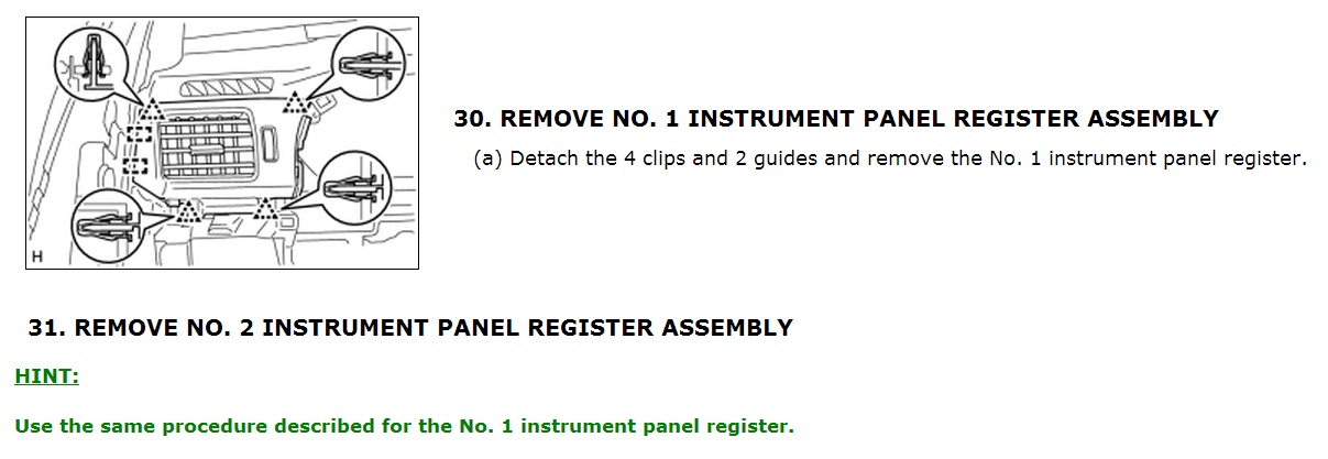

the clip is the one that moves the ent side to side and up and down.
the veen is queation is the passenger side vent for the the hvac and stuff.
it is at the window in corner at door.
I think this is what you are talking about? If so get a thin nylon removal trim tool and try to pry at that and see if it comes out, it seems to be attached by 4 clips and no screws. Don't force it because technically the manual says you need to remove the glove box before this piece, so there might be some kind of flap on the vent unit that is held under the glove box. I don't remember what it looks like back there because it's been a while since I pulled the glove box.
If you need to remove the glove box it's a straight forward but tedious process, you need to pop off most of the passenger side garnishes, temporarily unscrew the airbag and then finally unscrew the glove box, so you might want to let the dealer handle that if you are not comfortable.

Yes THANKS
thats what i am speaking of.
I will try, and if I cant get it, let the dealership do it undwe warrenty.
