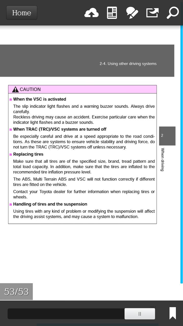

According to the manual VSC should beep and get the VSC warning light when activated . It has on mine when playing in the snow in a parking lot trying to throw it into a slide but only a couple of times when actually driving on the road. I hit loose gravel on a on-ramp one time and once on a icy road. It seems TRAC is what operates and also makes alot of noise unless the sensors indicate a slide and then activates the VSC .
This must be a change in 2011 and later models then. In my manual it states the beep will happen if the vehicle is rolling backwards. It does not mention any beep when the VSC is normally kicking in. People must have been complaining about the beeps.... shrugs...

Mine says it will beep then too and does. Look at the last few pages of section 2-4 in your manual and see if it reads the same as mine. I doubt they would change that but who knows.

When traction control kicks in, no beep (just a bunch of ABS sounding noices). When VSC kicks in, you get the beeps.
