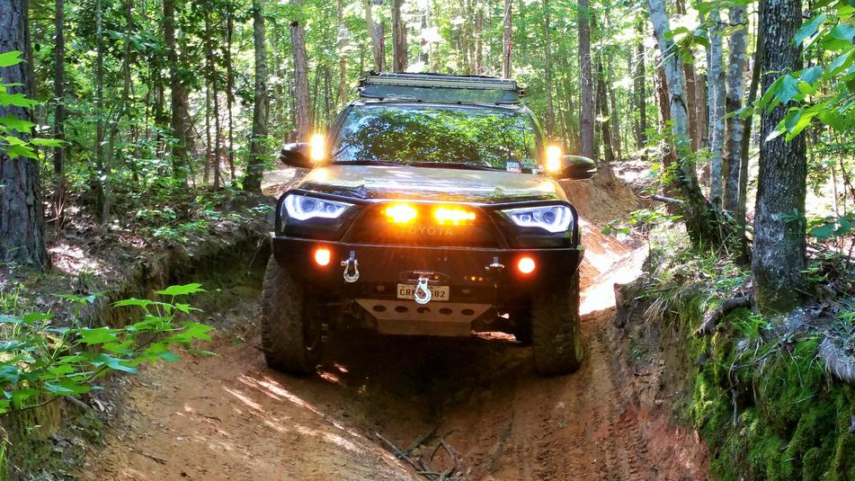

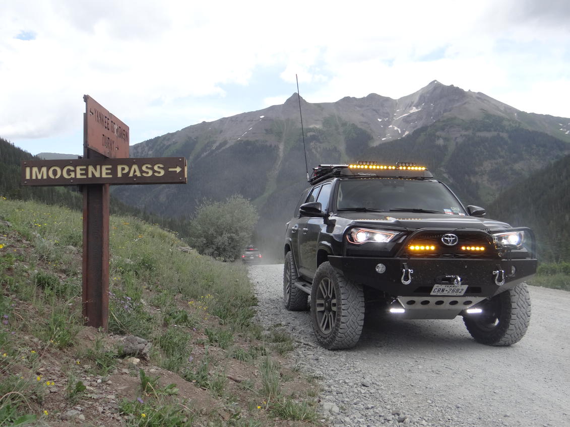

And all this time, I thought I WAS serious about offroading :(
Let's not overlook driving skills here. [MENTION=78318]RiDE[/MENTION] is right, but you are just proving that the threshold is further than many think. Honestly if I tried to drive some of the trails you do with 20's I'd destroy the wheels as I don't have the same level of skill picking lines.
