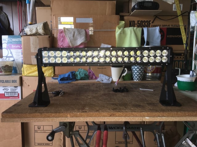

Painted the mounts and attached them to the light bar for a test fit and to see how it would look behind the grill. I can't wait to install and wire the damn thing up!

Got mine installed this weekend. Didn't take pictures because well, I forgot and was drinking beer instead. Pretty easy install though. It took about an hour. Just make sure your marks for your holes are exact. I had to bore out of the holes on the mount because I messed up but it all worked out.
Also, the steel support for the bottom of the grille, make sure you re-attach that before bolting in the mount and light bar. Believe me, it makes it very difficult doing this backwards.
The only gripe I have is that the bar pushes on the inside of the grille. Which isn't a huge deal I suppose. It just makes adjusting more difficult as it always wants to sit flush with the grille.
I might do something like what Saker did with his grille and cut it out and have a trim piece made so it doesn't just look like an open hole. All in all, very good mounts.
