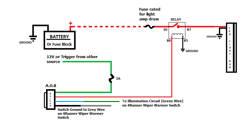

About to wire my switch. Only thing left is gray wire on AOB switch. What color wire should I tap into on windshield de-iced switch to get dash illumination?
Hope this helps!
