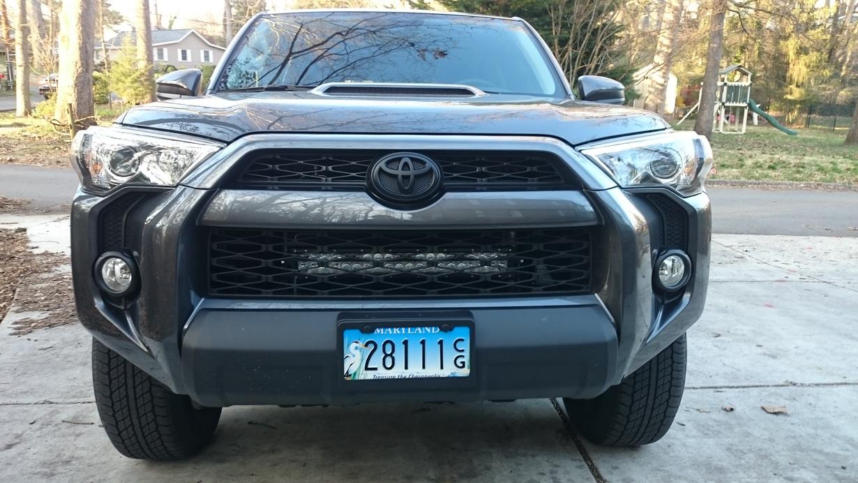

Hi all, Just wanted to share my experience with these brackets from [MENTION=133346]BradBrad619[/MENTION]
I asked Brad a few questions before seriously considering them, and he was really helpful. I thought the price was great for a custom fabbed item, and I sent payment via PayPal soon after talking with him. I told him I wasn't in a big hurry, and I still received them within 7 days of sending payment (I live on the east coast).
Super high quality stuff. I thought a few times that I could just make my own brackets and save a few bucks, but I'm so glad I didn't. These take all the guess work out of mounting the lights. Everything centers up so nicely, and fits right in place. A lot of thought went in to these. I have a 16TE, and couldn't be happier with fitment, build quality, and appearance.
I sprayed mine black before mounting, and reamed out the holes where the light mounts to the bracket, because my mounting bolts are a little big. Was no problem, since it's aluminum. Once dry, I removed the plastic shroud at the front of the engine compartment (done with no tools in about 90 seconds). I set the two brackets on the aluminum cross member behind the bumper cover, and then slid the light bar in place. I connected the bar to the brackets, centered it left to right, and marked the holes that are pre-drilled in the bottom of the brackets. I took the light bar out, so I'd have more room to work, and attached the brackets with 2 self tapping zinc screws per bracket. Never even took off the grill insert. I slid the light bar back in to place, tightened the bolts, put the shroud back on, and done. Now I need to wire it, but that's for another day. This job was stupid easy, thanks to the brackets. Anybody on the fence should pull the trigger. You won't regret it. For the record, my light bar is sold as a 24", but that's from end of bezel to end of bezel, so the lit surface is a little smaller. I couldn't have gotten away with much bigger, but I'm very happy with this one. Thanks, Brad!
