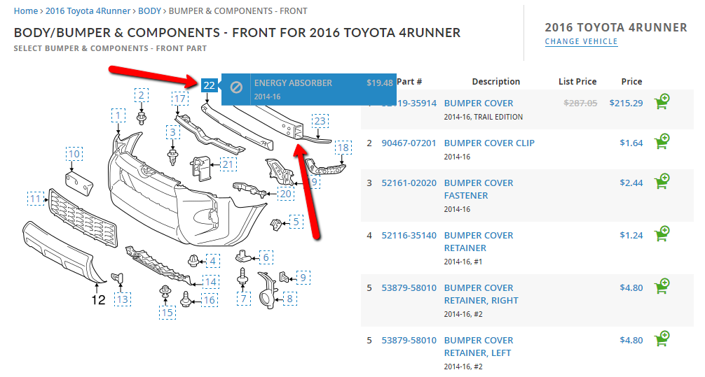

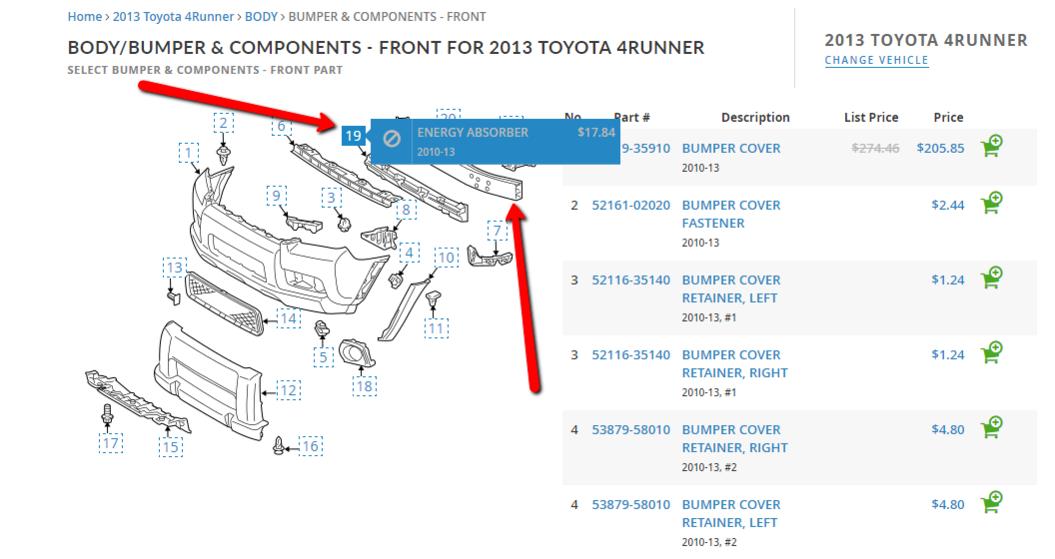

So will you have to replace the sub-reinforcement and the energy absorber as they look different between years.. however on the Toyota sites I have scoured I cannot see where anyone sells the energy absorber.
