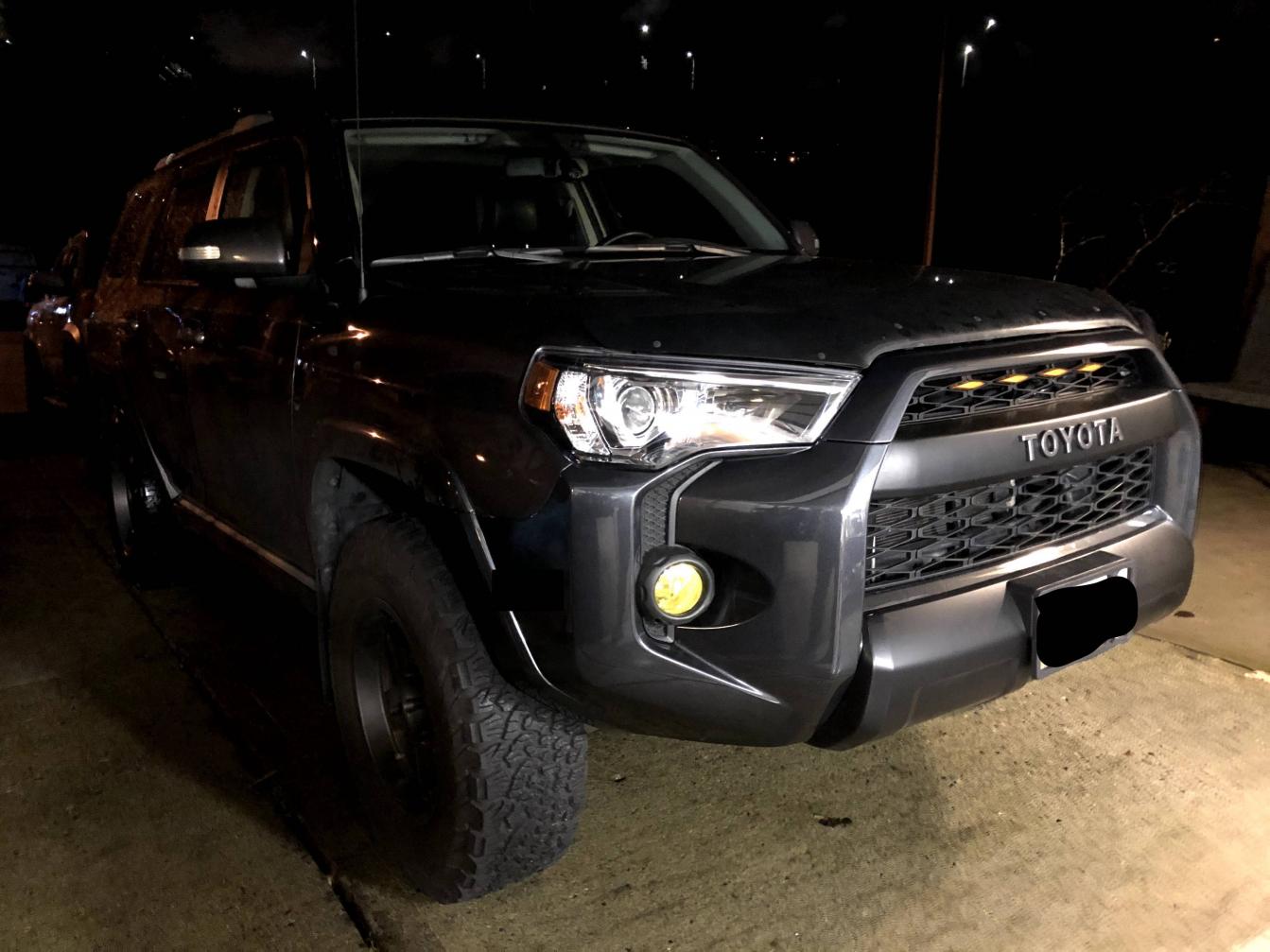

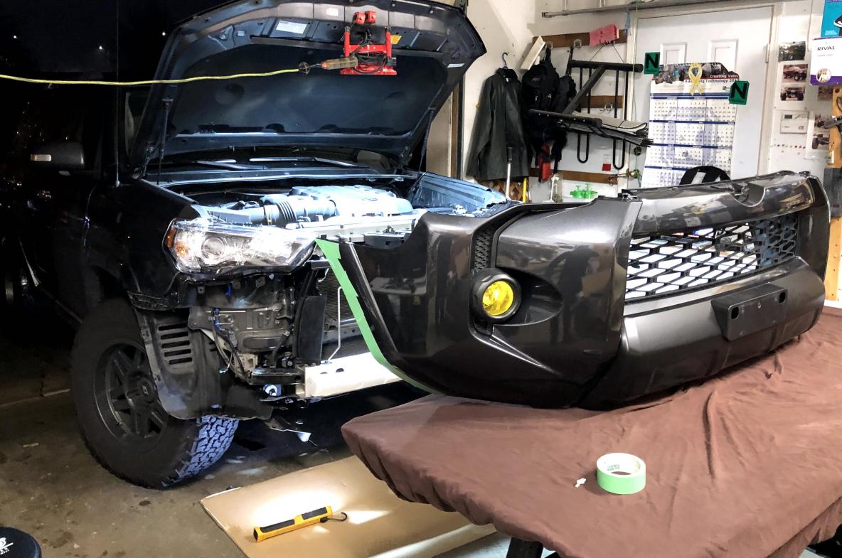

Just want to give a shout out to the guys on here that replied [MENTION=119582]Jeffy[/MENTION] and the OP coconut4runner now known as _seek.adventure_ on IG.
I got some before and after shots of my truck and I also took pictures of the wiring for those wondering about the conversion.

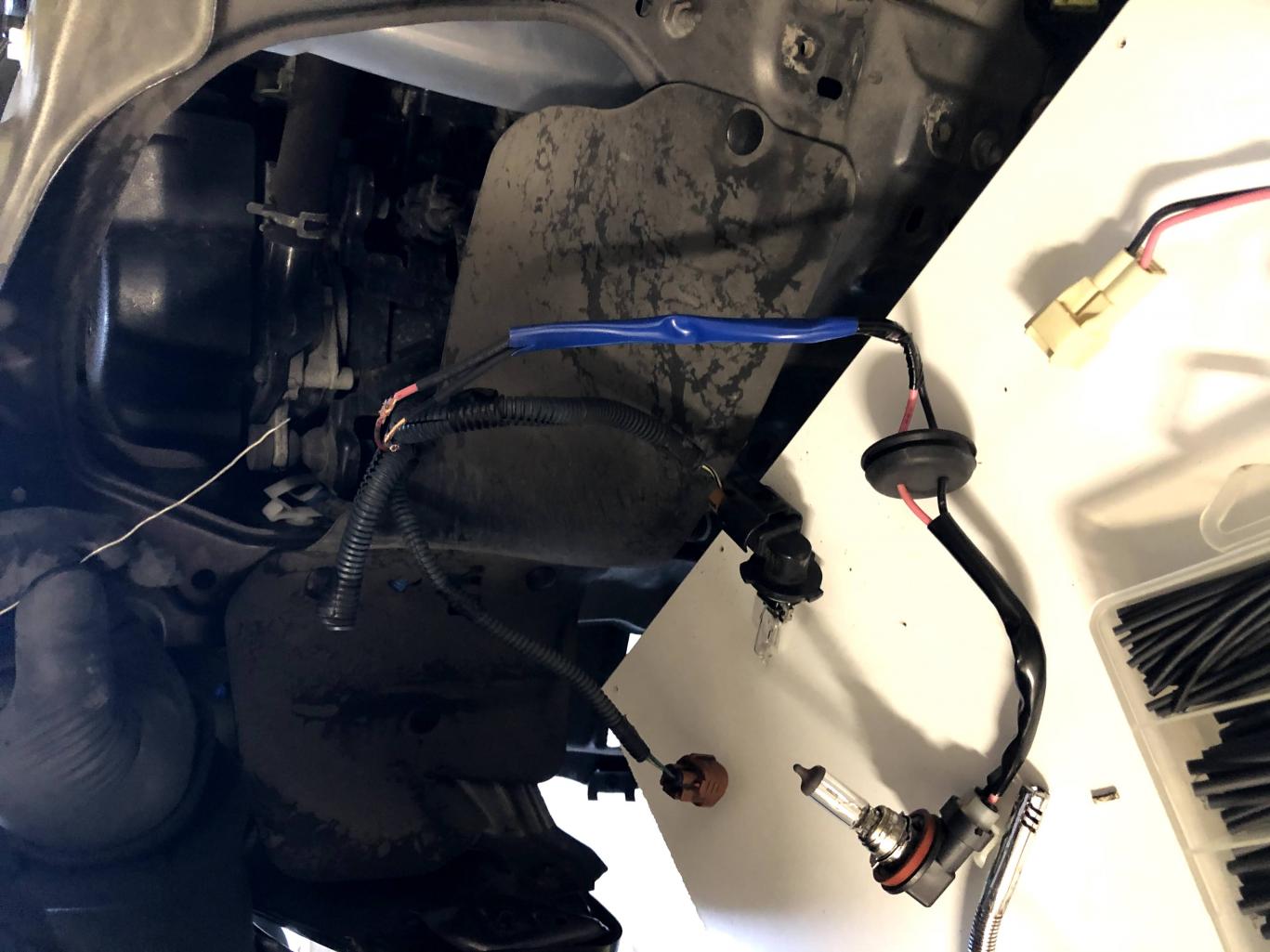

It is super simple if you have any basic electric wiring skills. Haha I say this when my dad is the one who wired it for me. But we basically cut the new blue housing cable and cut off my old socket. Then we stripped and soldered the wires together. That way, we can save the dust cap and rubber grommet.

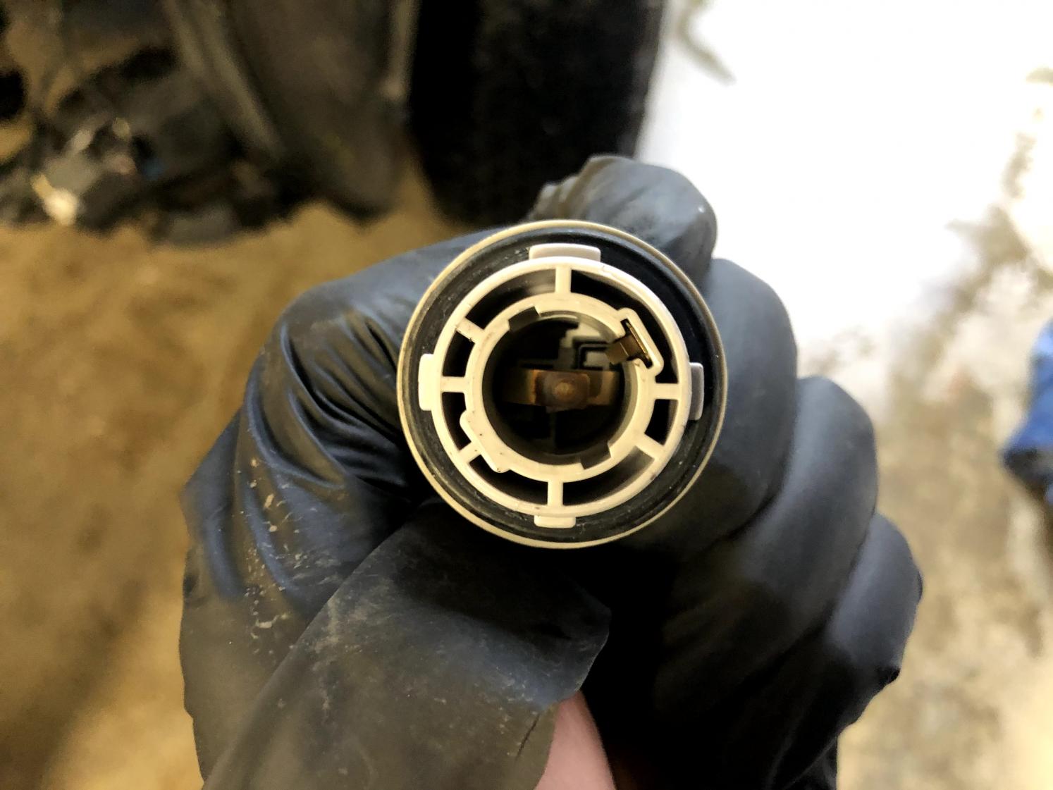

One of the last photos shows the adapter with 4 legs you need to insert and twist. All you need to do is trim the 4th leg of part 90075-60028. This is the your DRL you relocate up top and becomes your DRL and turn signal.
Anyways, thanks again for all the help!

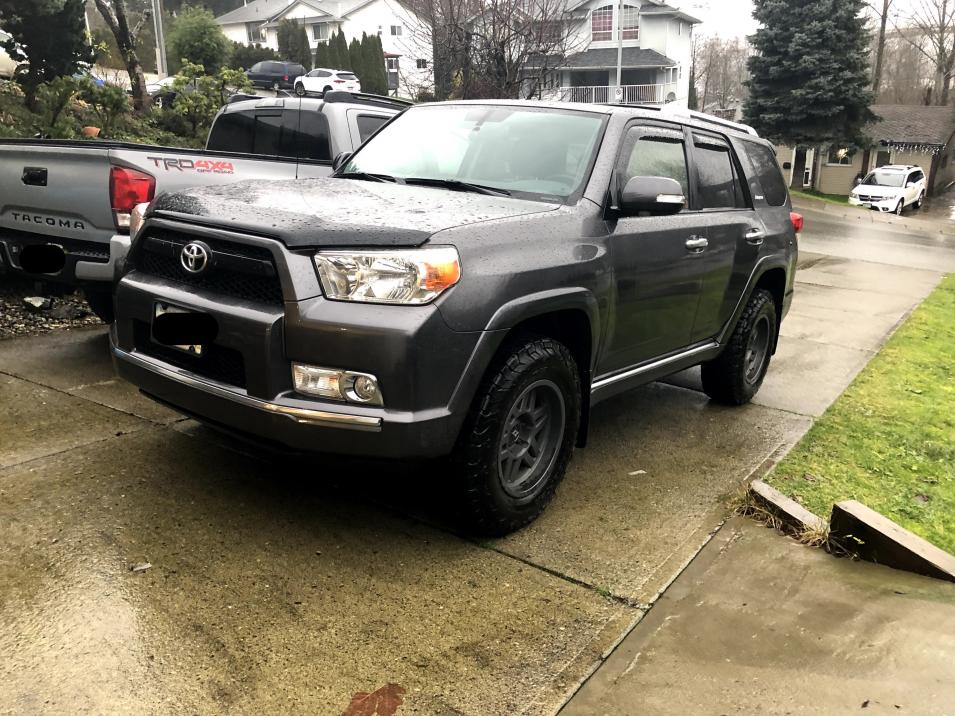

This weekend I finished the swap on my 2011 SR5. I hit a deer and it was minimal damage, but this insurance check was plenty to pay for everything needed for the project.
I made a fairly thorough video of the process. Here's the link. The parts list and cost are posted there too.
Thanks to all of the information in this post and others to help get it done.
