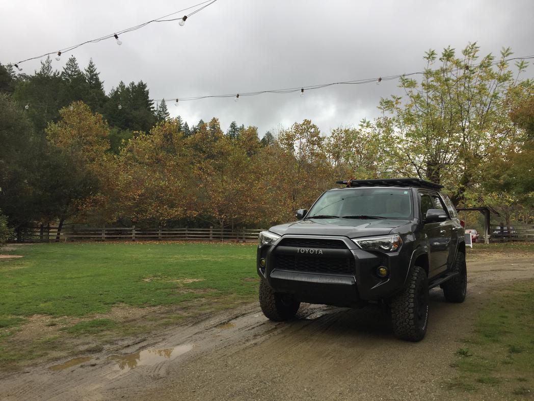

Just converted mine as well. Thanks all for the wealth of info available here. The job was not difficult, just took patience and multiple partnorders! Loving the look though.
Nice job! It looks great! Did you have any issues that you weren’t expecting or was it pretty straight forward?

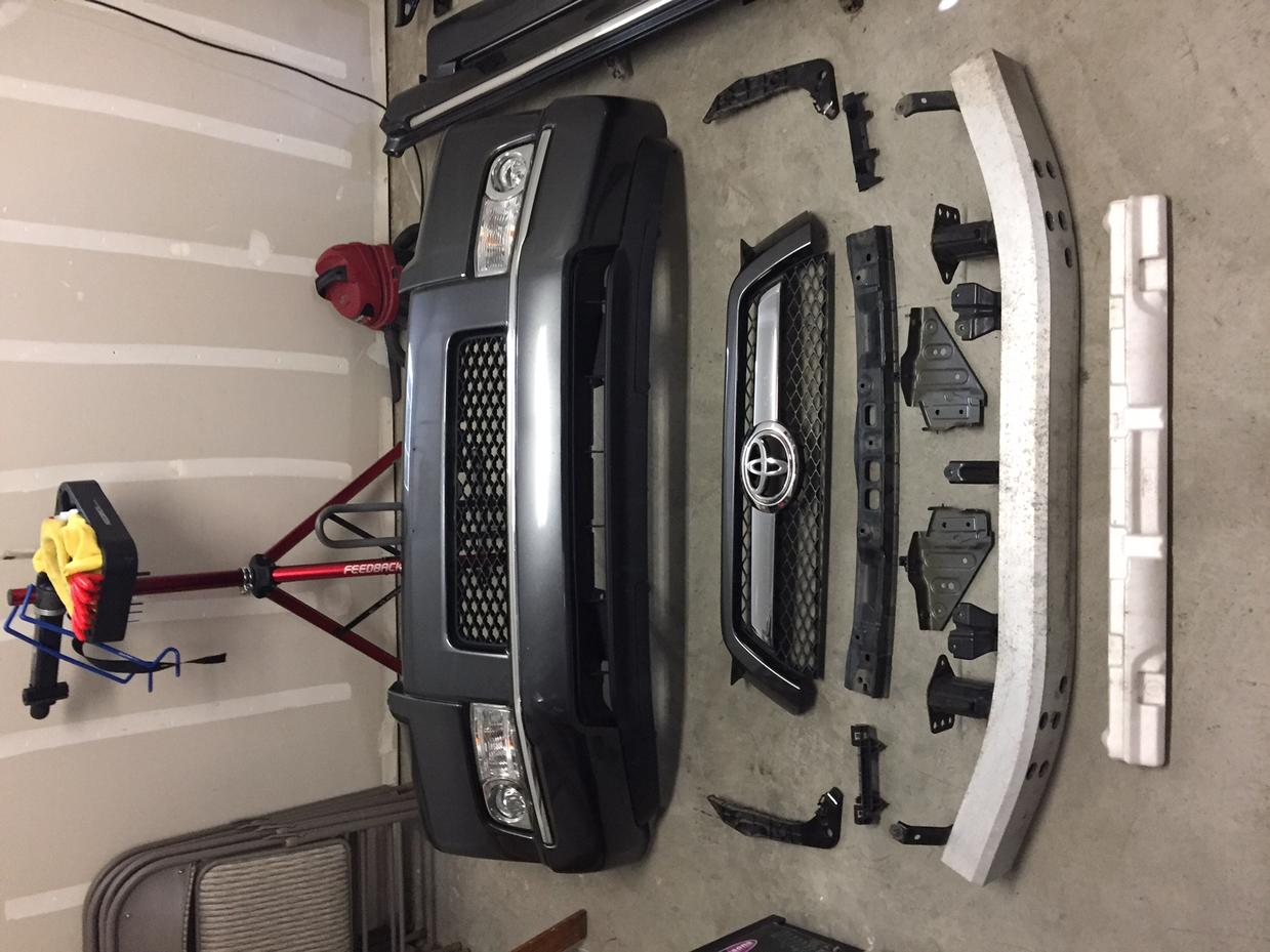

I just did the swap and have 2010 front end parts from a magnetic grey SR5 if you're interested, you'd just need to get the headlights. Located in San Jose area also!

Had some minor issues including: the 2010 radiator grille support bracket is not at the right height but I managed to use a long screw and washers to build a support for it. headlamp wiring harnesses required some splicing to get the correct receptacle. Ebay'ed it. Also the headlamps have these plastic support pieces that the bumper cover hangs off of which I didn't realize I needed. Trimmed the fender liner on both sides and threw out a ton of underbody plastic. other than that, it was pretty straightforward. Once u get all the pieces off of the car, it's easy to tell what needs to be done. Recommend having a second car
Thank you for the offer but I wouldn't want the hassle of repainting, and I don't like the SR5 front end. Black trail or bust, in exchange for a 2016 black trail front end.
