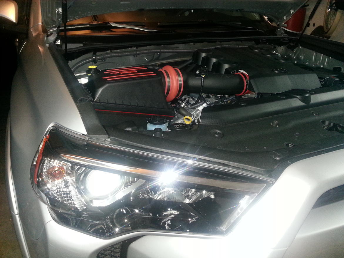

TRD intake installed on my 2014. Toyota part #PTR03-89100.
Yup, direct fit..no modding. The installation instructions dont account for the "air pump thing" so the harness re-routing is slightly different. Other than that...no probz.

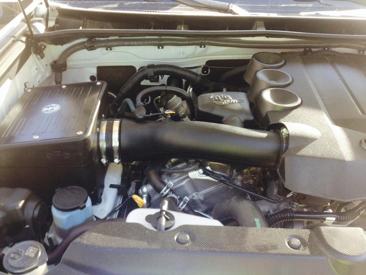

I installed a 2012 AFE-CAI in my 14 Trail today. Bought mildly used out of the for sale thread in here. Still a direct fit, but I did have to relocate the horn back along the fender well. Just flipped the bracket and moved it to another pre-threaded hole. I've run K&N filters for years on several vehicles. I'm more interested in a cleanable and reusable filter for the life of the vehicle than in any performance gain. This one was about half the price of a brand new unit and I've never had a full CAI, so I thought i'd give it a try.

Could you post a pic from the top? I am trying to see the back side of the hose going in to the air box
I assume you're asking me since I have the only picture posted so far. So here ya go. Best I can do with the phone out here. Sorry about the dust, we're in a silt bowl right now. As suggested earlier I have seen no appreciable power or mpg gain. I am still looking at adding a Magnaflow catback system somewhere down the road.
