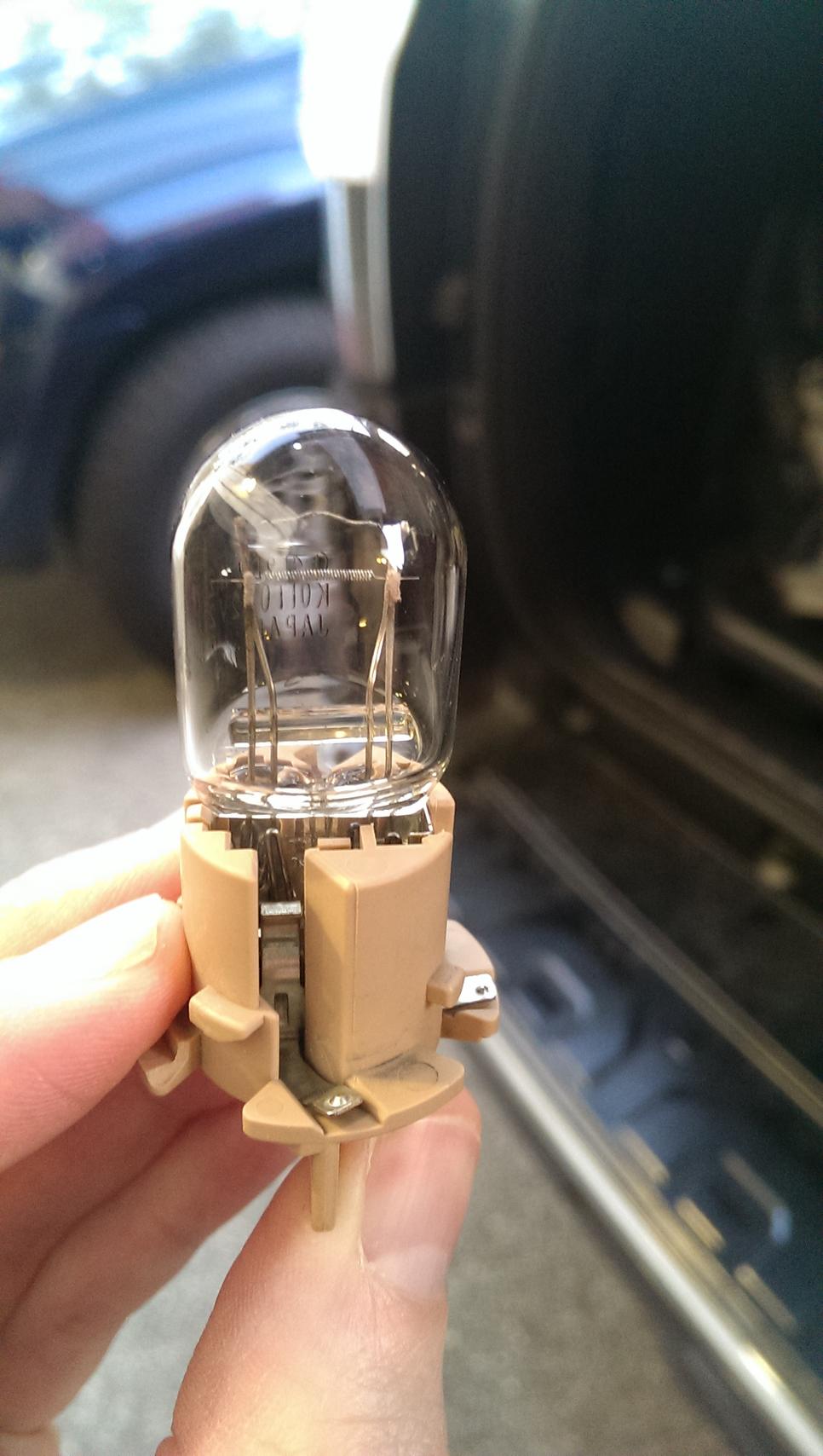

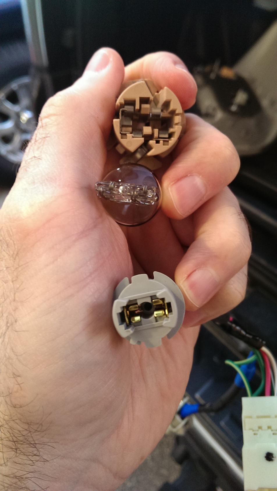

ok. i started this thread couple months ago and slacked off and just now getting around to finishing mine up. Tail lights came in couple months ago, wire harness just came in. I have a 2011 Limited, and the turn signal and back up bulbs are not fitting. Call the dealership anticipating this and they didn't have bulb numbers. Can someone verify that clear back up bulb and amber turn bulb?

They are a straight swap. Probably putting it in backwards? The backup light is small and goes in the bottom hole. Blinker top. The wire harnesses are different. This means you have to actually remove the bulbs from the plug! Took me a second to figure out. Let me know if I just confused you. In other words, the bulb is separate from the portion that plugs in...
As Ben mentioned, the bulbs swap straight across. The old bulbs from the original tail lamps in to the sub-harnesses. If you have different bulbs than everybody else then you have on of them "white elephant" 4Runners!

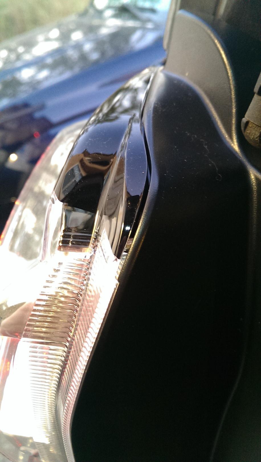

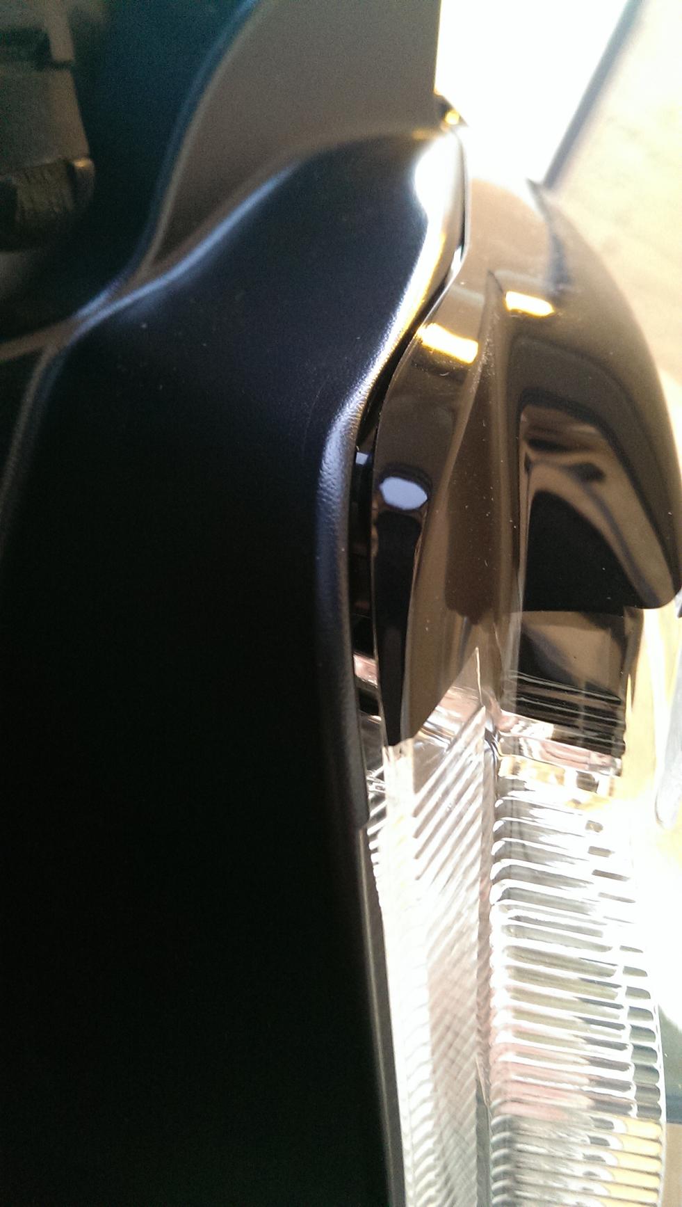

I think you have the break light in your hand dude. The small clear one is the one you want... and the amber bulb. BTW, don't touch the bulbs with bare hands as it can cause premature bulb failure... The housing on the other hand looks bad. I'd get them to replace that.
Ya I am replacing all the bulbs anyways. I usually install with gloves to keep skin oil off then wipe down with alcohol swab. I got rear ended in a parking lot last summer and tail light has been cracked. So replacing both sides with the LED set up and new bulbs
My turn signal bulb is amber. My reverse light is clear
