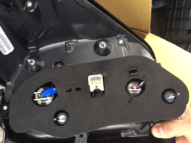

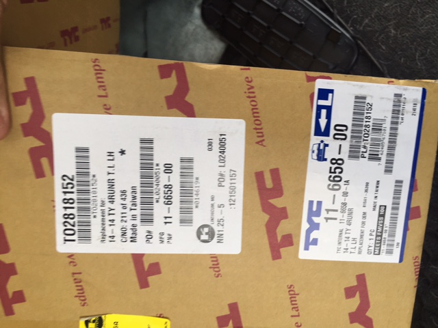

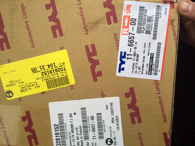

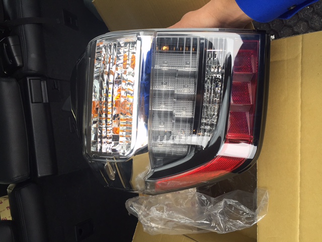

One of my friends owns a body shop. He suggested trying the TYC tail lights instead of the Toyota ones.
Long story short, I had him order me the TYC ones with the intention that he would take them back if I didn't like them. The TYC ones showed up and had the harness, bulbs and gasket already installed and included.
I did a quick test of them by unplugging my current light and plugging this one in and it worked but more testing is needed to confirm that everything is working correctly (I did the quick test in the parking lot at work).
In a nutshell, this mod costs about $500 if you use Toyota parts (light, harness, bulbs). If you do it with the TYC lights (harness and bulbs included), they can be bought for $117 each off amazon ( Amazon.com: TYC 11-6658-00 Left Replacement Tail Lamp for Toyota 4Runner (Pack of 1): Automotive ) with free shipping making the total cost about half of doing this with the Toyota parts ($240 vs $500).
I'm going to install them tonight and can post pictures after if anyone is interested. I haven't been able to compare them side by side but they appear to be identical to OEM.
TYC Part #s:
Right: 11-6657-00 replacement for 81551-35400
Left: 11-6658-00 replacement for 81561-35390
Pictures are attached of the parts.

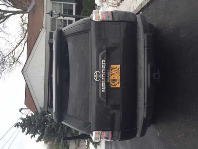

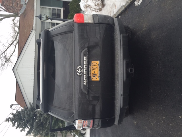

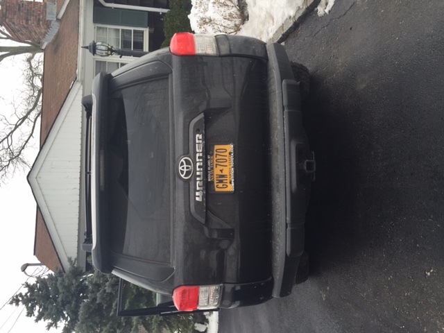

Alright, I ran home on my lunch hour to change out the tail lights. Worked great, everything is working as expected.
Here are some before and after pics with the TYC tail lights. (Please excuse the salt covered truck, it seems like its been snowing every other day.)

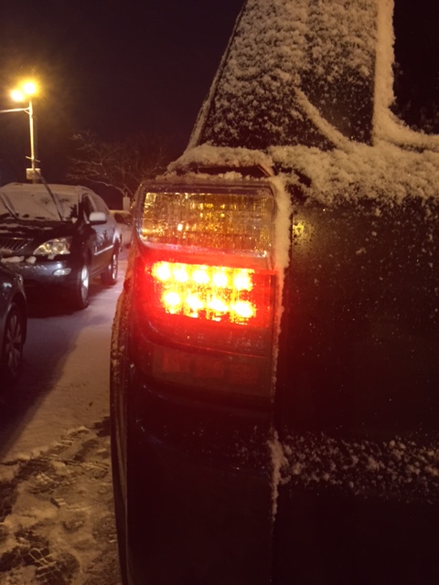

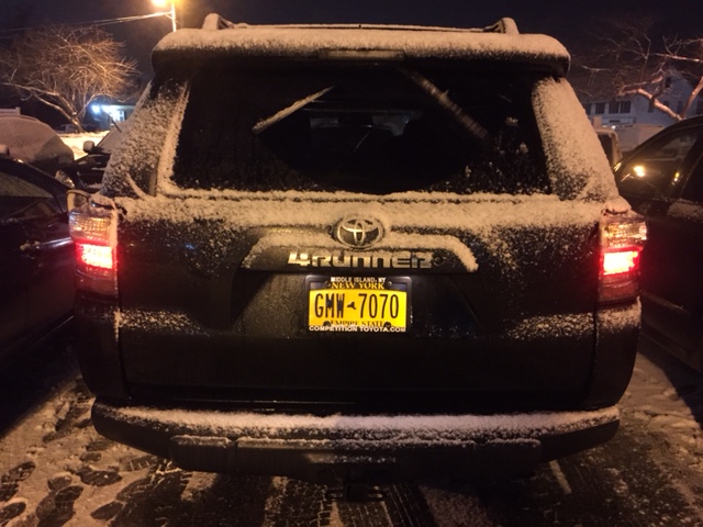

Here are some pictures of the TYC lights at night, its snowing here again so the pictures aren't the best. I can take some more tomorrow night once it stops snowing if you want them.

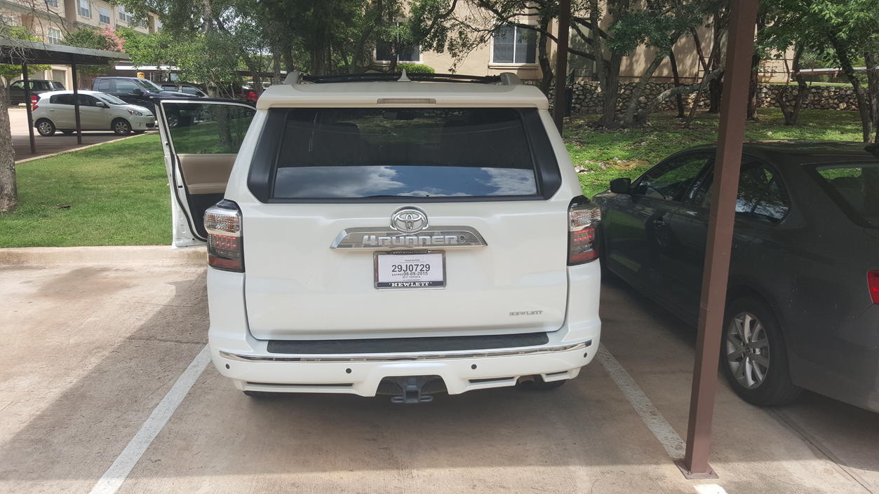

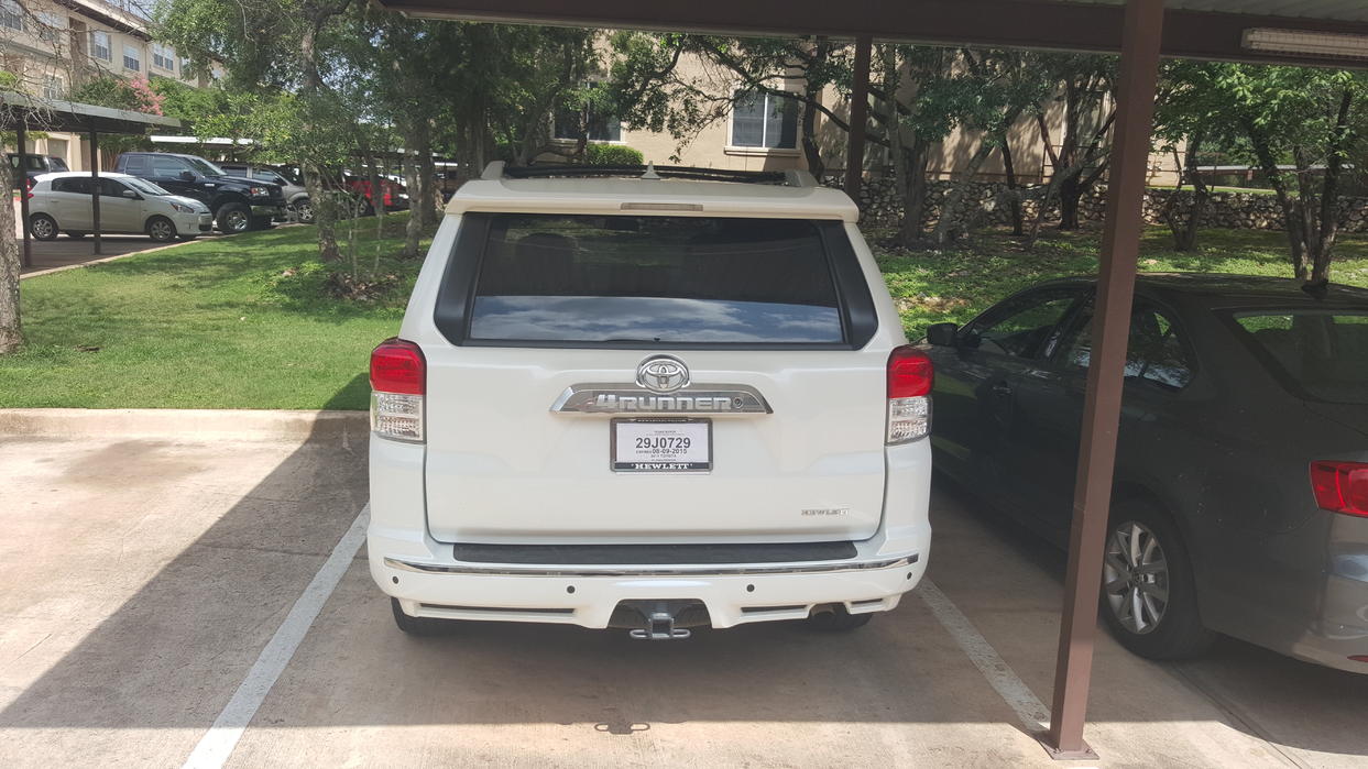

2014 Tails on my 2011 SR5 4x4

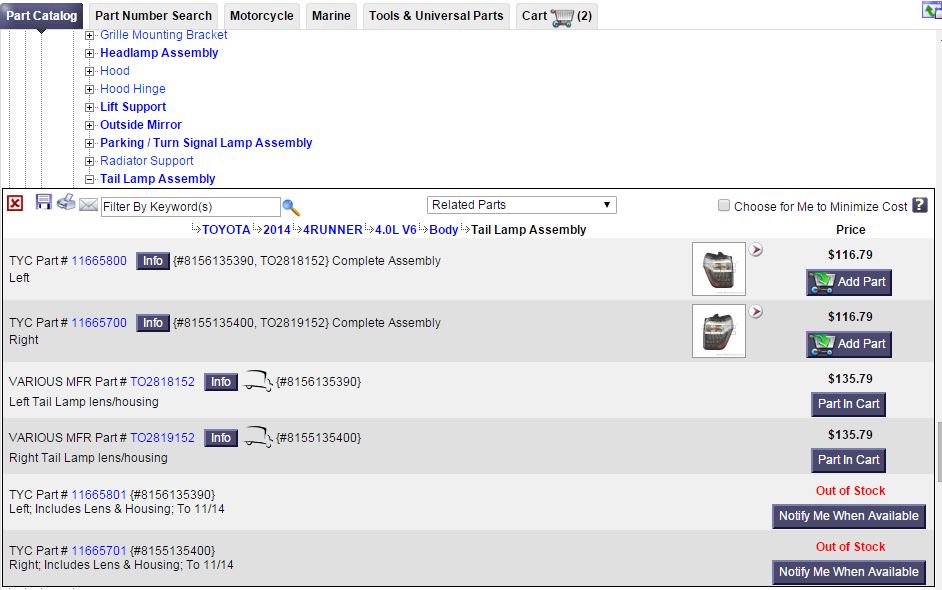

I went the cheap way too. The TYC a exact replica's of the OEM..
I got mine from RockAuto Parts Catalog as a full assembly with bulbs, harness and gasket. It took around 10 minutes to replace..
