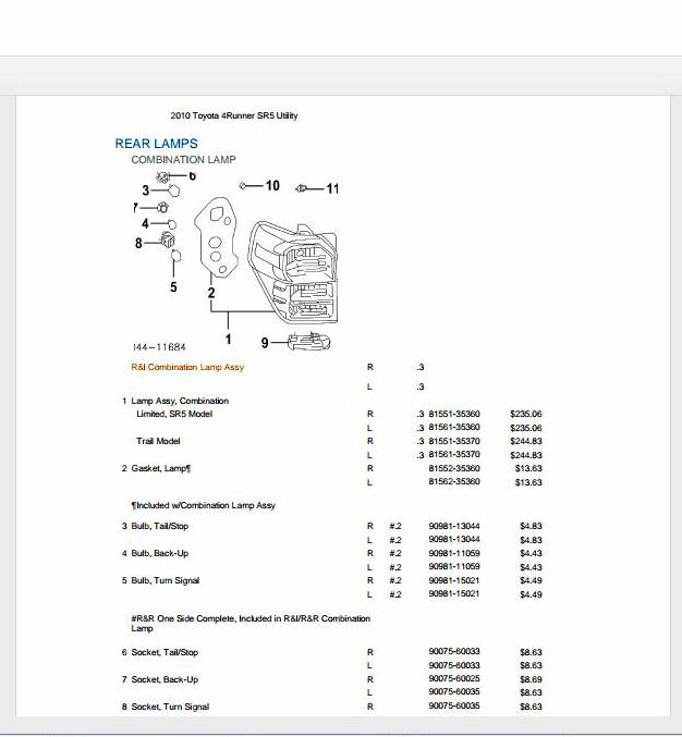

Your probably right that there is a subharness for the LED sockets that feeds off the main harness. Here you can see the parts break down for the make-up of the 10-13 tail lights so we'll probably need that subharness and at least some sockets specific to the new ones.

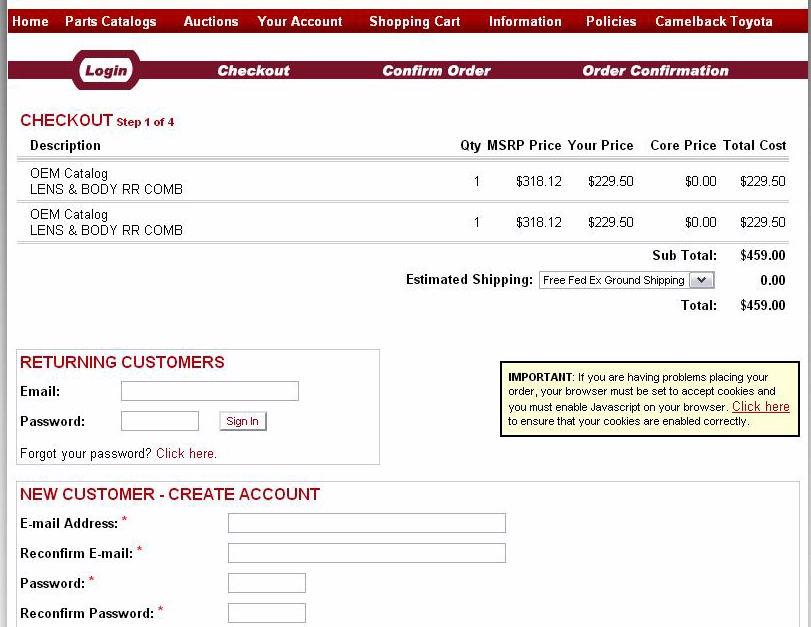

Camelback Toyota has the cheapest place I found for those part numbers that N2GLOCK listed and free Fedex shipping and they do have a return policy. Now we just need a guinea pig with some extra cash!:bump2:

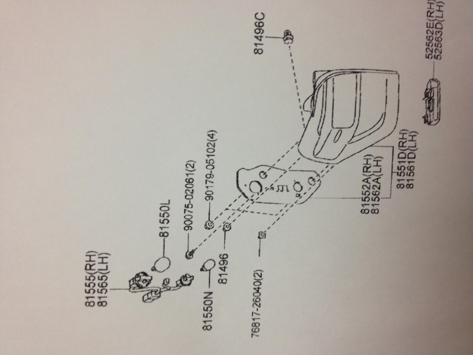

Okay guys and gals, I had a schematic faxed over to me this morning. When compared to the one that harper7 put up you can see some differences. It appears that there is a seperate sub-harness that needs to be purchased. I don't have a scanner so I took a pic of the schematic of the '14 tal lamp for all of you to see. Hope this helps.

If you look back at the first page and the pics of the back of the lights....it looks like that subharness is IN the light. There is one plug on the truck side for both the 10 and the 14. It looks like there is one plug on the new light in exactly the same place as the old light and its the same 6 hole molex style plug with the same 5 wires.
