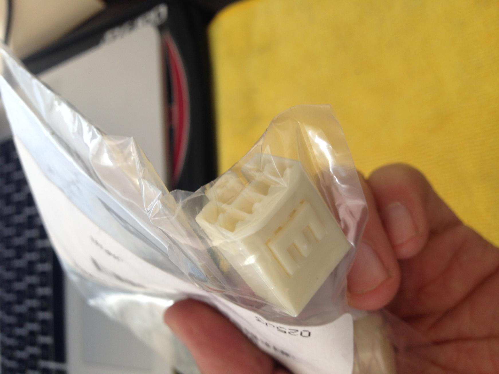

I have a 2013 4 Runner Limited and just picked up the 14' Taillights from the Toyota dealer. The sizing of the lights are slightly slimmer and less bulky than the original but they do fit right in. The only problem is that the plugs are different and are NOT plug n play. Ive also purchased a light socket fitting for the 14' but It came without the harness so I couldn't even hotwire it if I wanted to.
Any input/suggestions would be nice. The taillights are really sweet and I would love to have them installed and not returned.
This was the $9 plug that I purchased, it didn't come with any wiring harness so i'm stuck trying to figure something out.

I purchased the female plug 90980-10797. I tried to order the suggested harness : 81555/81565 but they said the part no. wasn't good. still trying

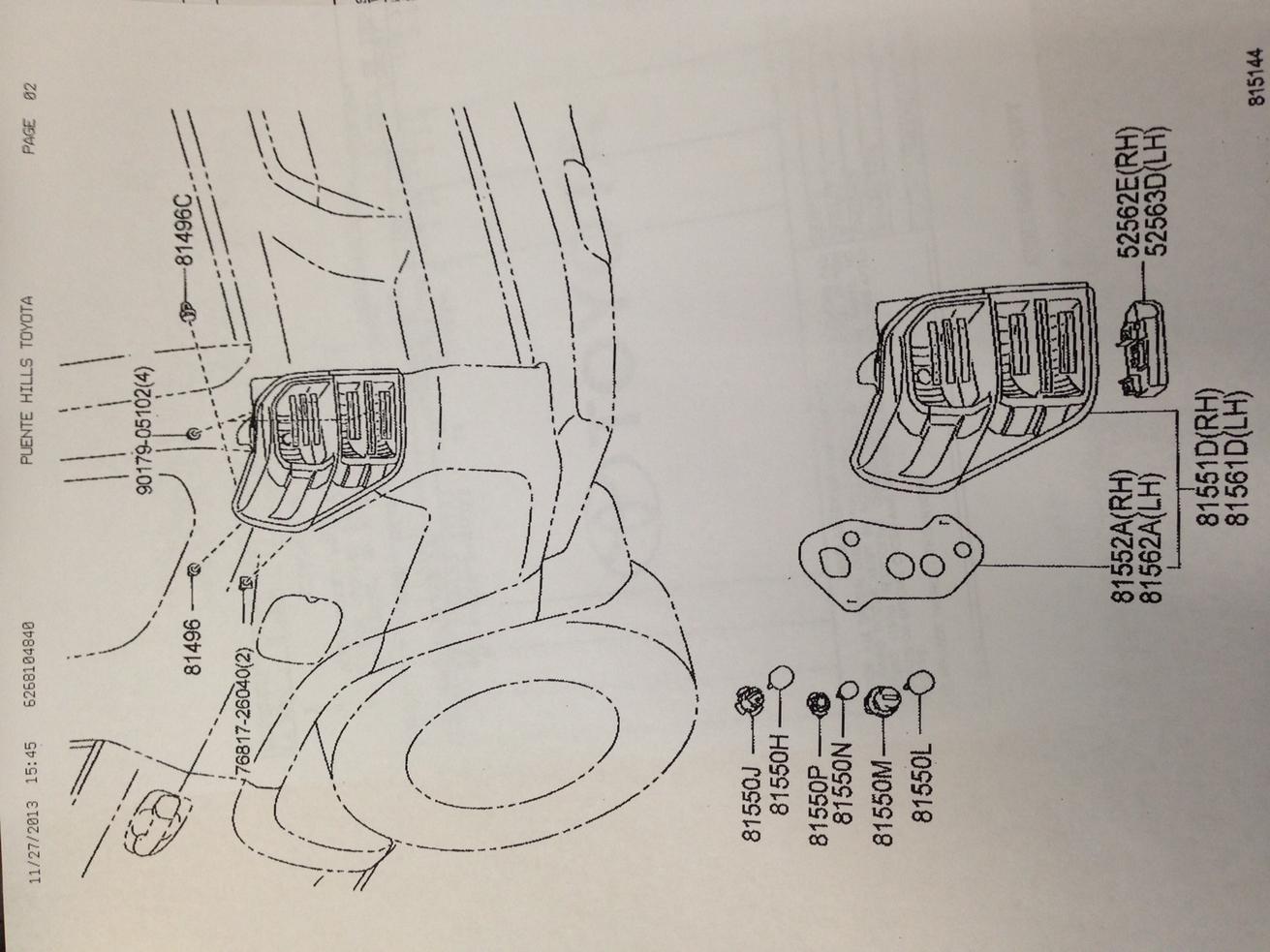

That plug will not work. Tell your parts guy to bring up a schematic of the tail lamp section on a '14 When he does, the harnesses in the schematic will come up. The schematic shows the short number as opposed to the long. When he brings up the schematic and clicks on the short number he will then be switched to another screen that will give him the long number. The harness you need has a 5 pin connector on one end and a 3 pin connector on the other. The end with the 3 pin connector has 2 light bulb sockets as well. This is the side that plugs into the '14 tail lamp. The harnesses are right and left specific. Hence the different part #'s. Let me know if I can help.

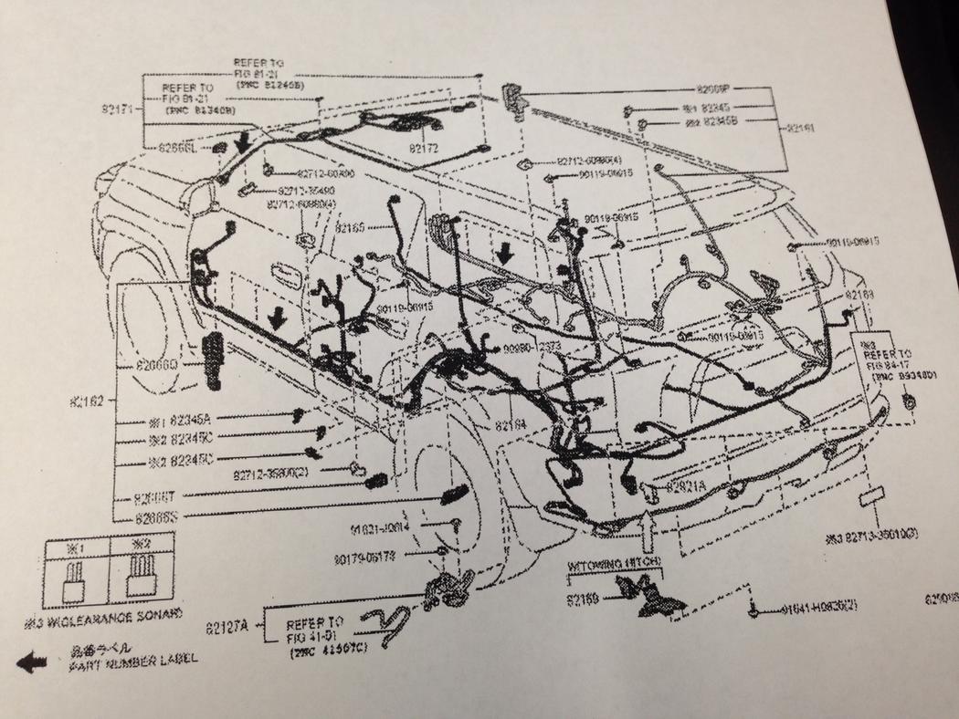

My Toyota parts guy is still having a hard time finding the suggested harness 81555/81565. He's sent me the schematics below and It doesn't list the harness. I'll send an update once he looks into it. Attached is the part's list that he has.

I would show him a pic of the schematic that ip posted in this thread. I believe that it's on the 2nd or 3rd page. I know it exists. I was quoted a price of $19.50 per side w/ a wait of about 2-3 days. If all else fails, I will get you the long part #'s on Friday as I'll be @ work.

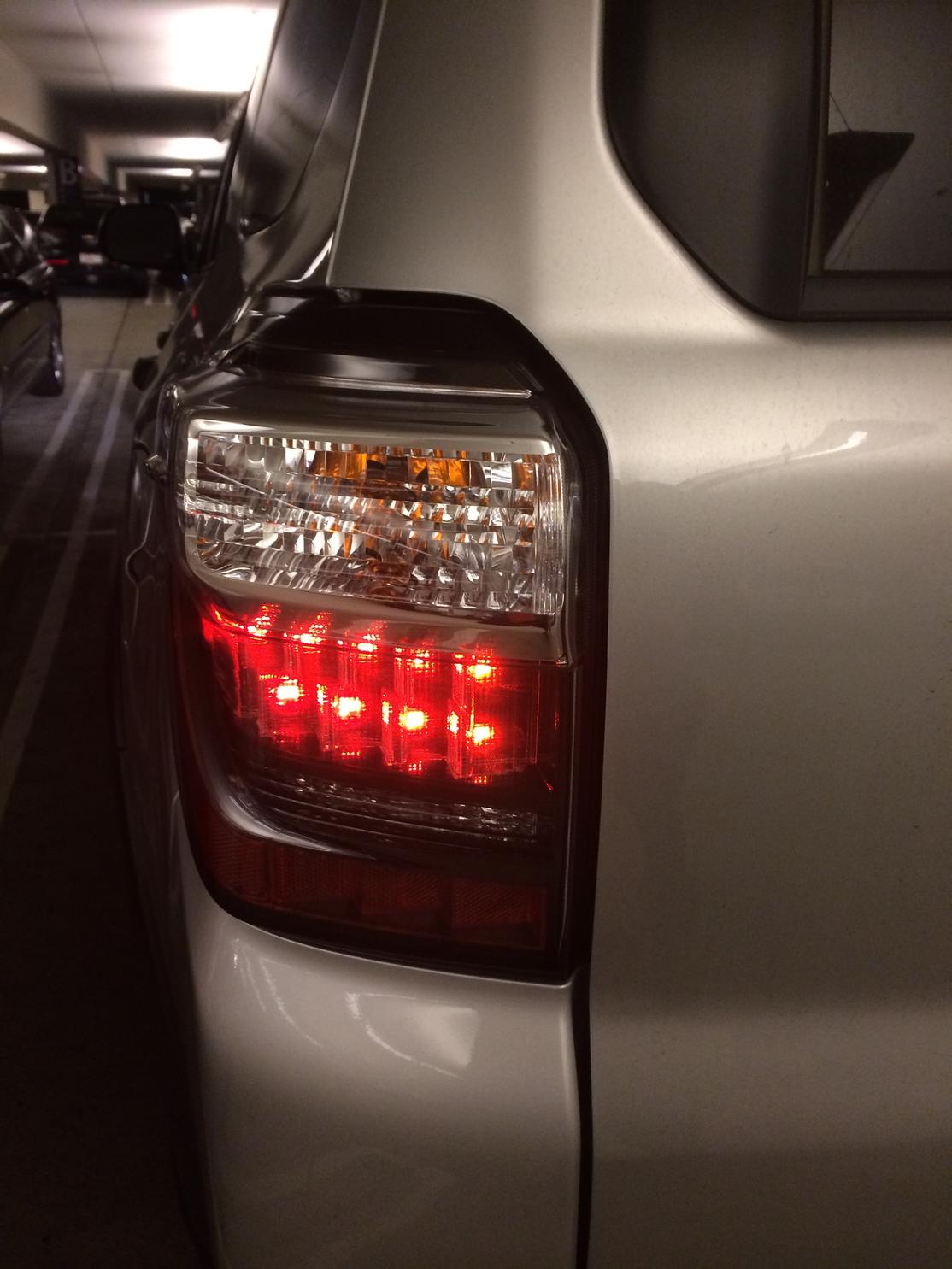

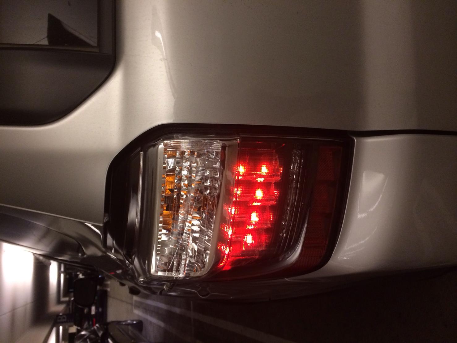

2014 Lights installed on 2013
Here you go Gents. Enjoy. Was really easy once i received the Harnesses. Most dealers will tell you they're on back order, tustin toyota CA. has them.
