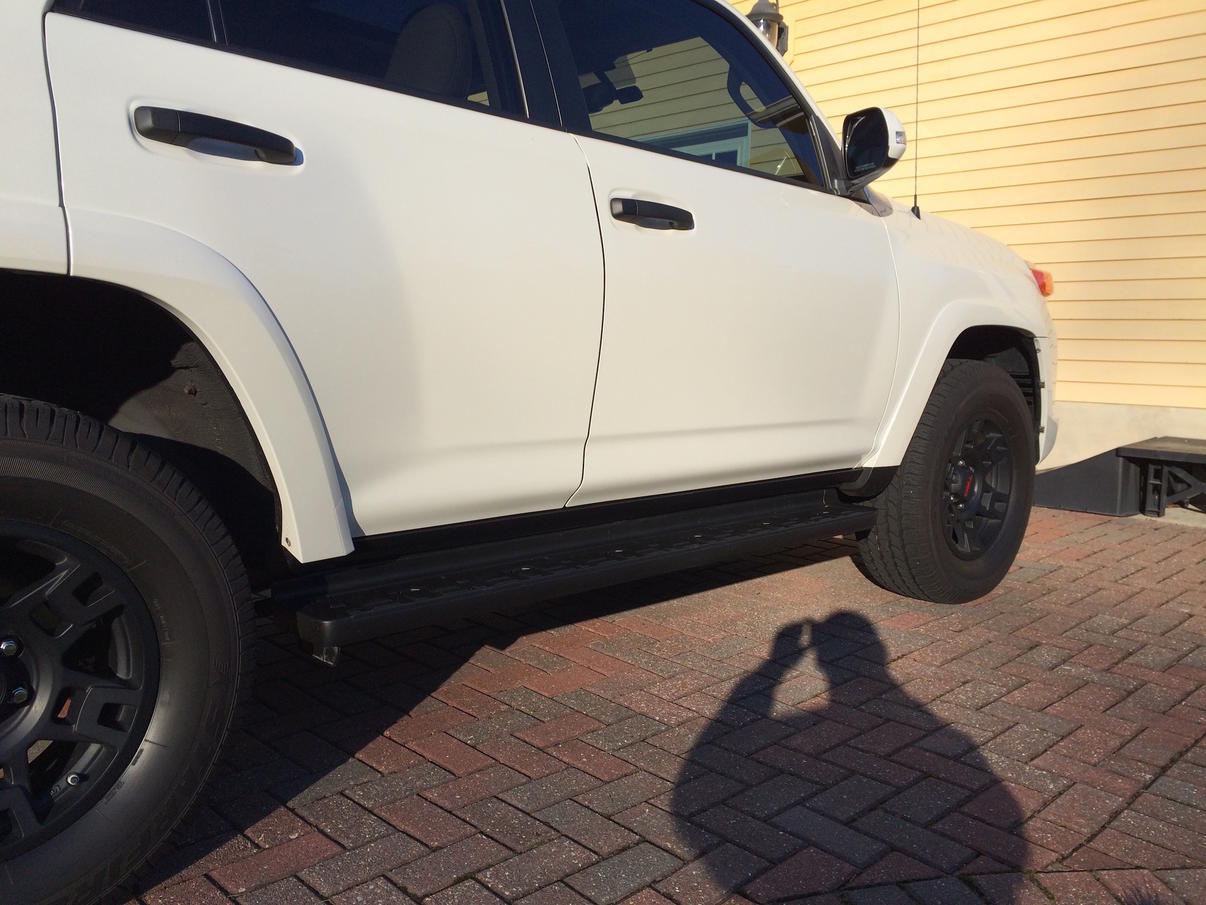

Here's what they look like installed. As a reminder, the truck is a 2013 SR5 with 2014+ rocker trim.
