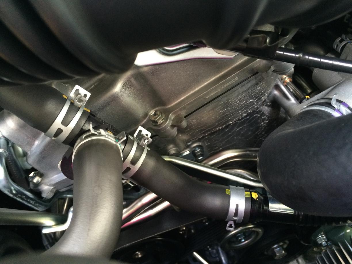

I just bought a new 4runner , drove it home and just noticed this on the engine block. It seems to be only on the bottom end. Does this look normal? I have never seen an engine like this new and I can't imagine driving it will cause this. Seems like a manufacturing defect? :noidea:

Those are casting marks. Maybe more pronounced than normal. If they bother you, you can sand them down with a soft block and fine grit wet or dry.
The chances of Toyota letting a truck leave the factory with an externally cracked block are slim to none. There was a thread on this months ago... it's normal. Part of the casting process as I recall.

These cracks are just casting deformities (only superficial). It happens when the boiling metal cools down after being poured into the mold and left to form... not a very scientific explanation "I'll admit", but it's all I got. lol! This is normal!
Enjoy your new truck, regards!

FYI.....That's not even the engine block!
That's the timing chain cover and those marks are usually indications that it was pressure injection molded and you get those from the mold release agent so it doesn't stick to the mold.
Pressure injection molding makes a stronger part then regular cast moldings.It's stronger then cast aluminum but not as strong as forged.
Gotta love how some people talk shit about Toyota cutting quality when they are actually looking at an upgraded part.It's not a show engine that they are going to polish the timing chain cover on it, so who cares what it looks like as long as it is stronger.

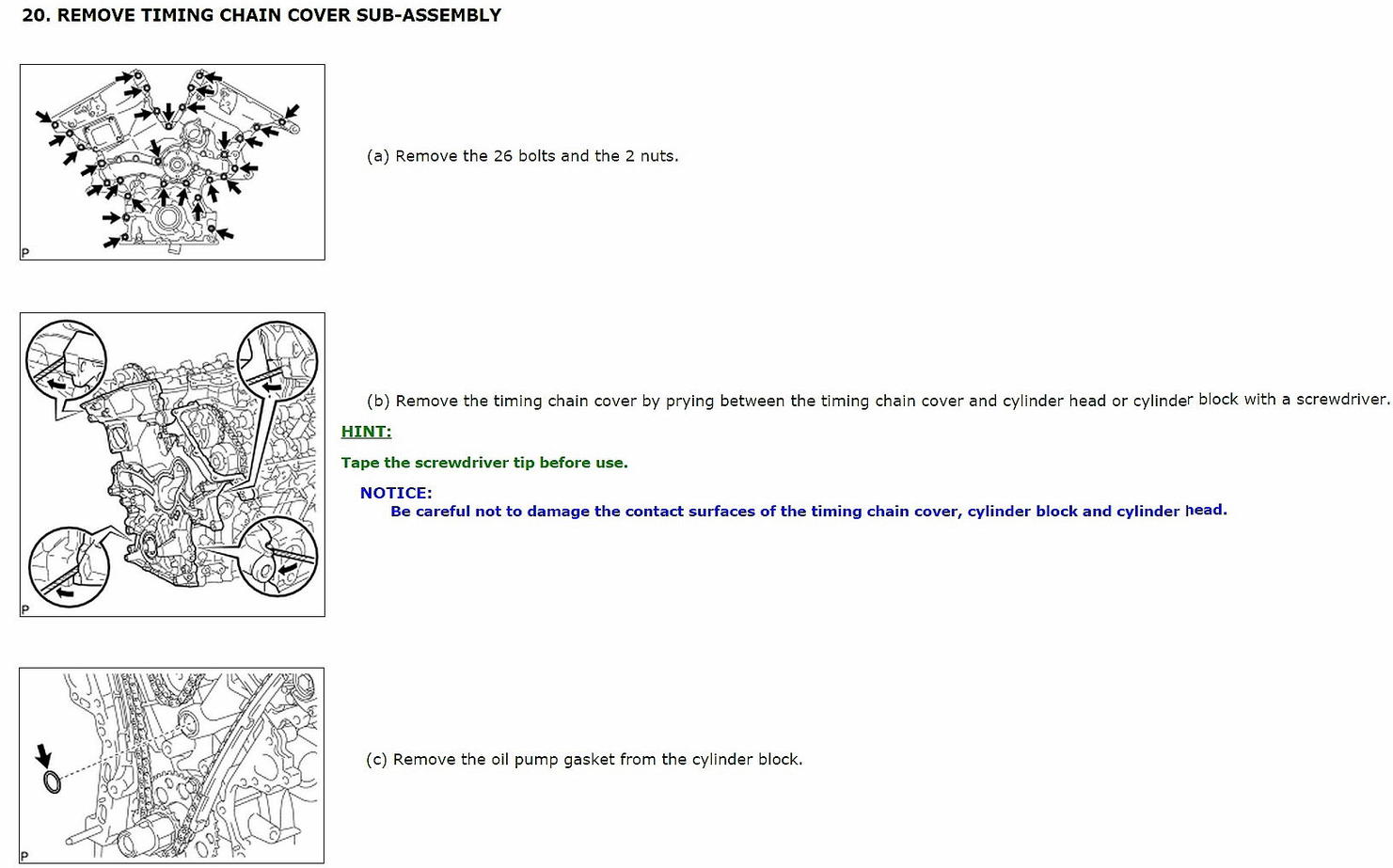

Here is the timing chain cover shown in the pics and what the marks are on .Untitled.jpg
Here is what the engine block looks like and you can't see any part of it from above in the engine bay.
