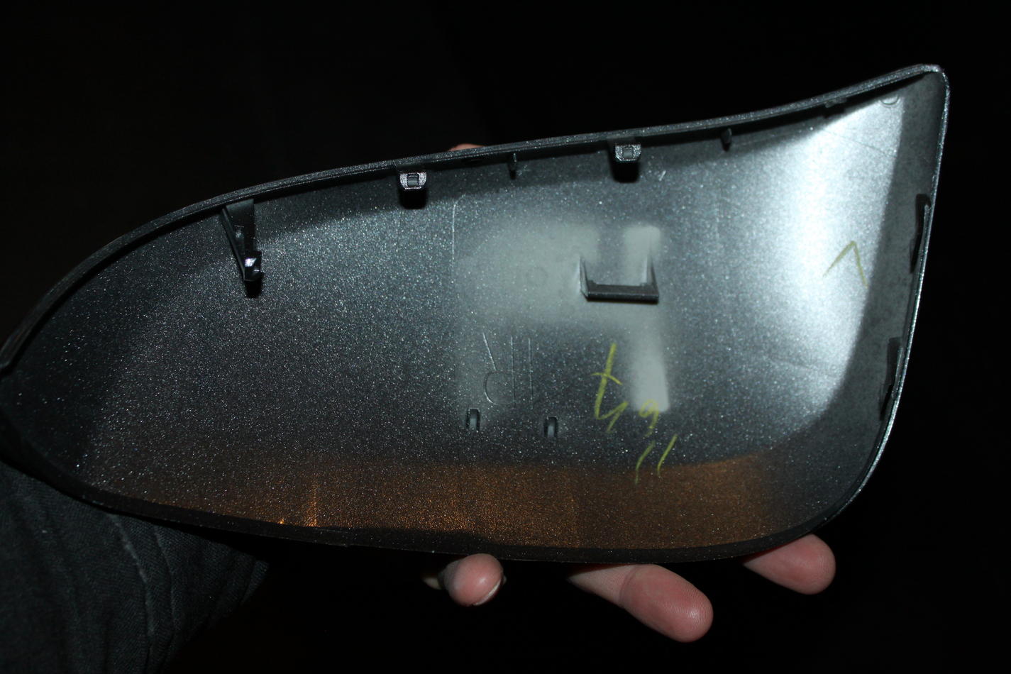

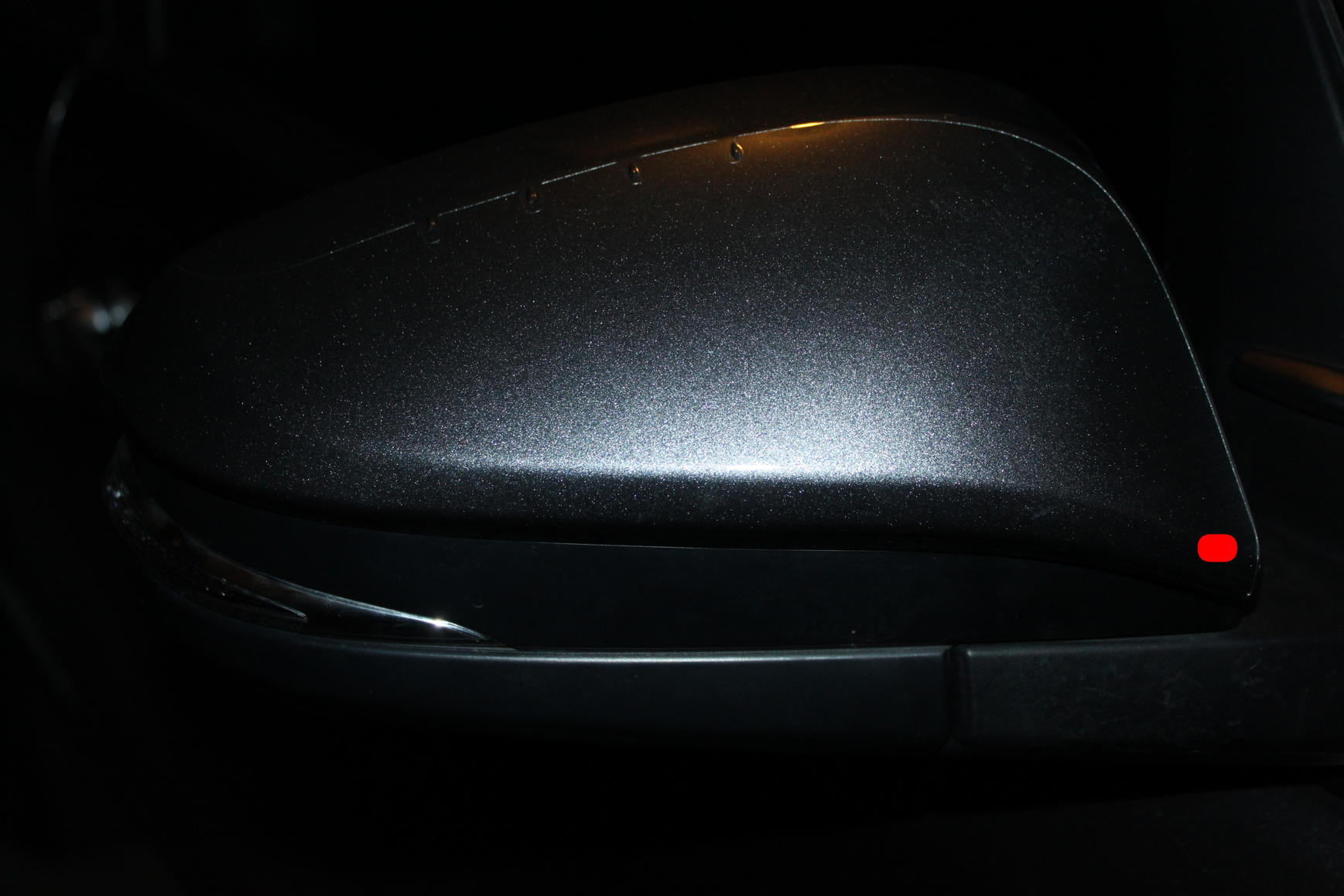

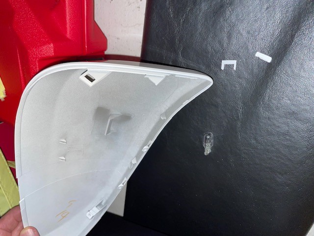

Step 1: remove back cover of mirror assembly. I marked the area with a red dot where you should start. Pull back and up with a slight pressure and the cover will pop right off. The tabs are strong, so dont worry about breaking them. Just be careful not to let it go flying and scratch up your paint.
Photo showing back of cover:

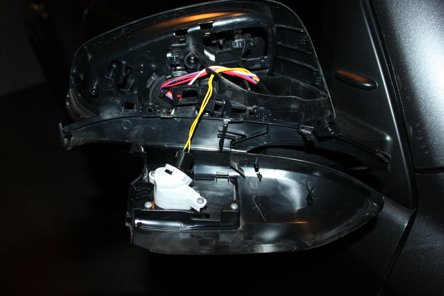

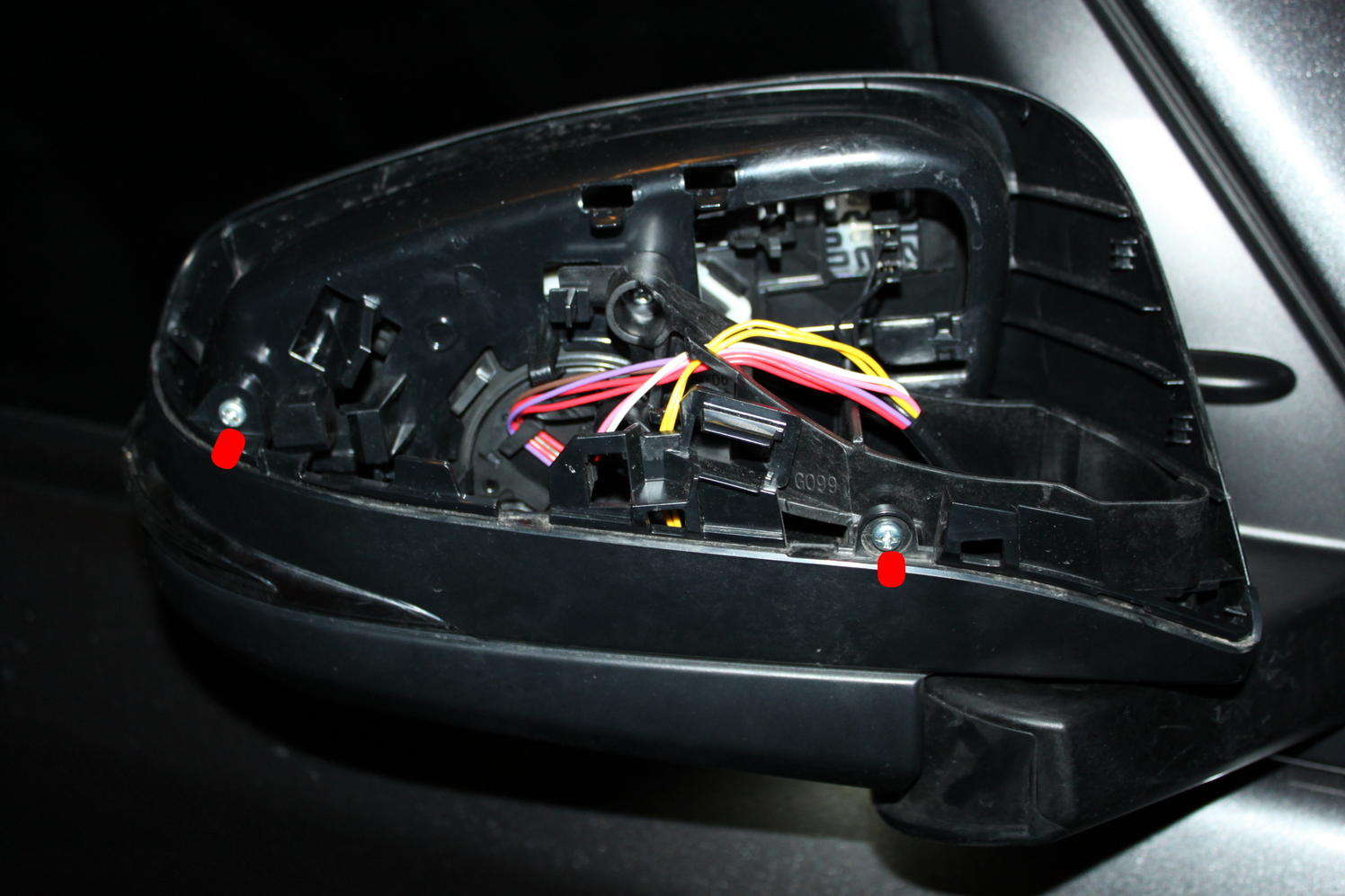

Step 2: that yellow wire leads to the puddle lamp. Remove the 2 screws from lower cover assembly. Next you need to pry off the lower cover. It's attached at several points, so the way I did it was wiggle it free on the right, then middle and then left and it came off pretty easily.

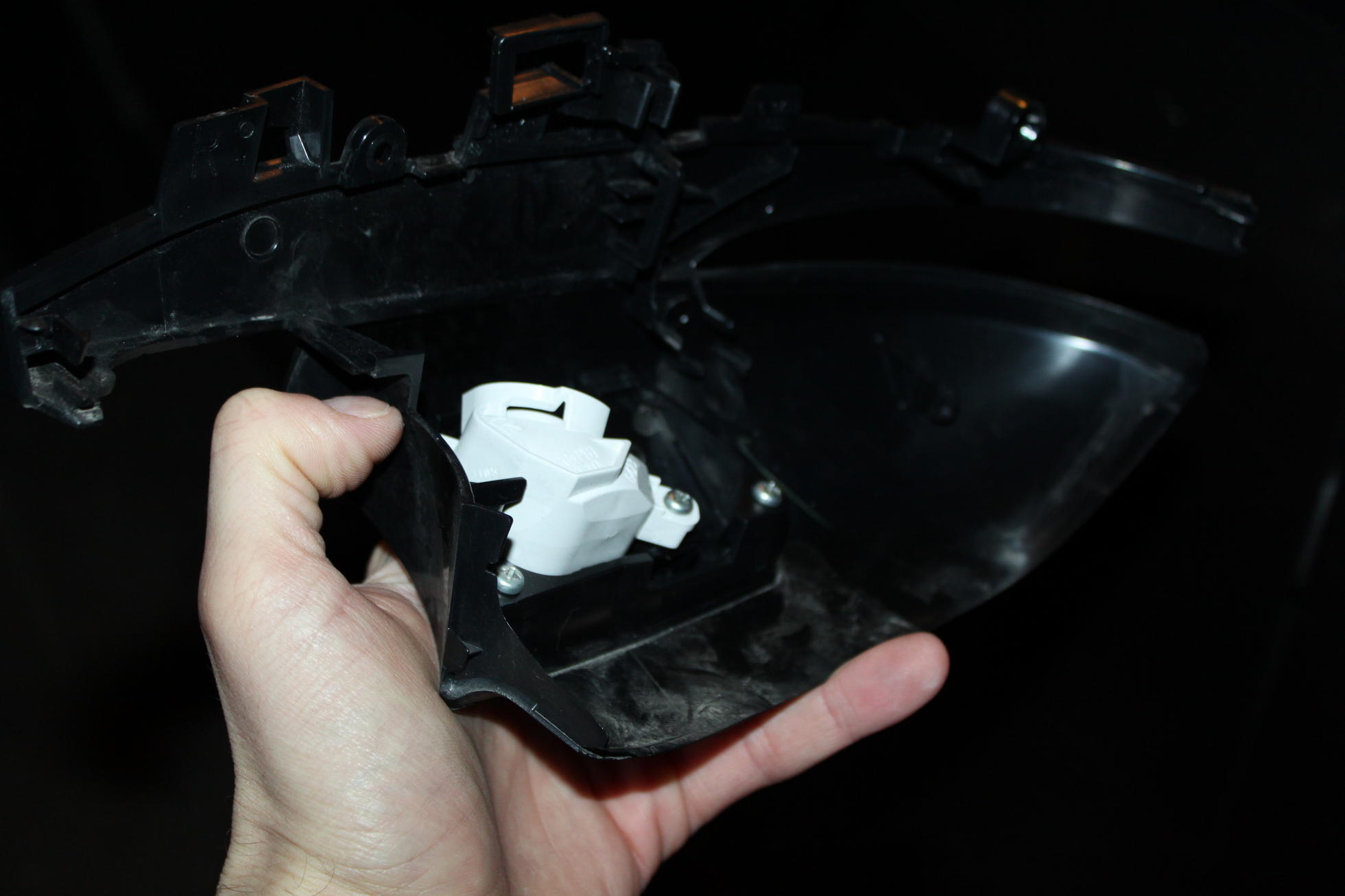

Photo showing back side of lower cover assembly, once removed from mirror housing.

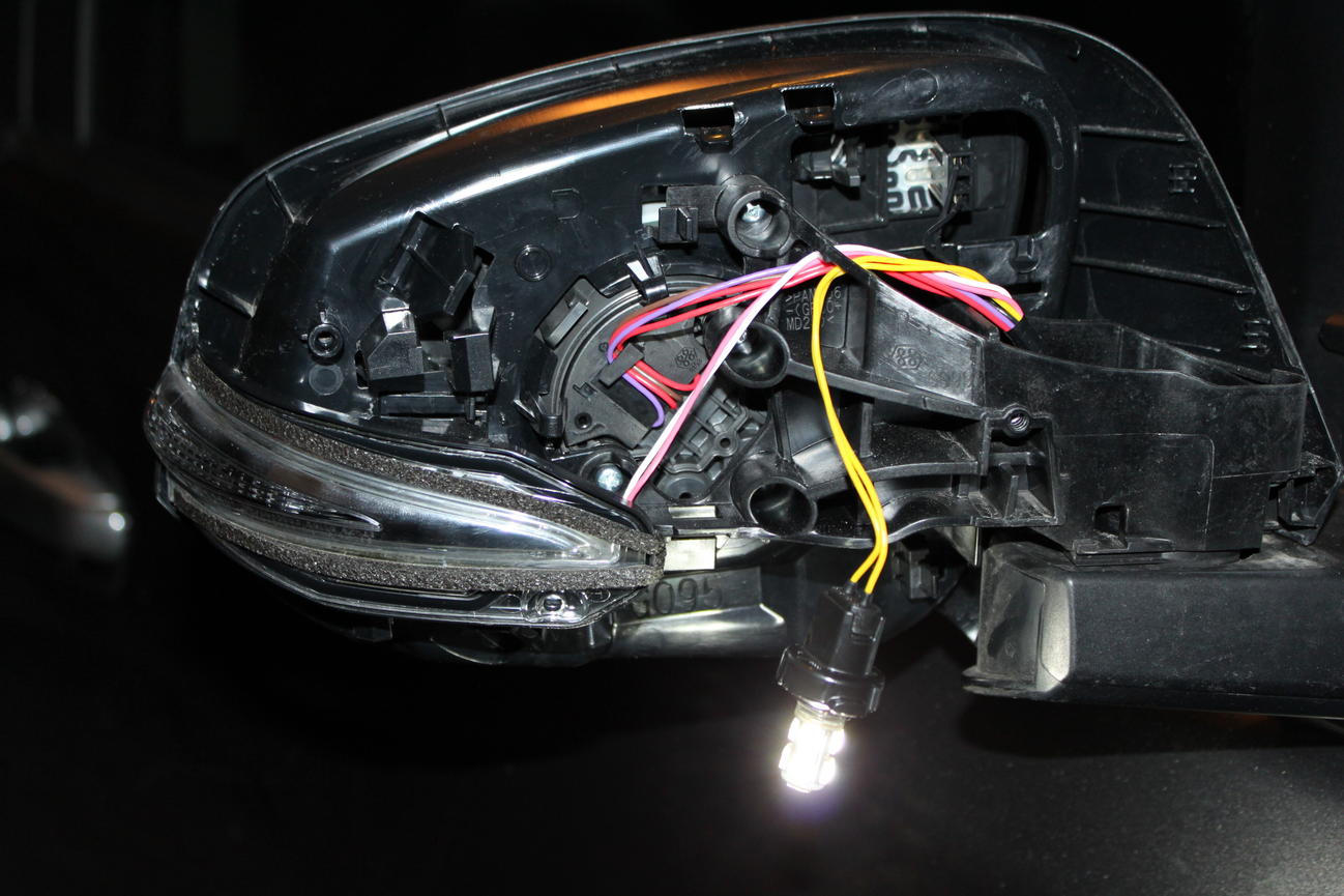

Step 3: Twist the light socket from the lens assembly to reveal the old bulb and replace with your fancy new LED.
Reverse the process, reassemble and boom, LED puddle lamps.
resurrecting an old thread: been trying this all afternoon and I can't get these outer, painted shells to budge. On youtube I saw a guy pinch with two fingers and the thing comes right off.
*anyone whose were on tight, have luck with plastic pry tools?

Just had both sides off to install power folding mirrors - yes they can be on there good and I had to use plastic tools, no way was I getting it off with fingers alone (:eyebrows:)
Update: gently used the plastic pry bar, slowly working all the edges. Broke at least one clip so far. ugh

I was able to get it off the ROBSCOOL way. You have to have clean fingers that grip the plastic well (or maybe put on some snug grippy rubber gloves). Use two hands, two or three fingers of each hand to grip the pointed edge close to the window. Pull back and up in a controlled manner. It would probably help if everything was warm. Maybe use a hair dryer to heat it up. The other method is to pop off the mirror. That way seemed too dangerous to me.
garage was about 60 degrees, got out the hair dryer and warmed it up a bit after I broke 1 clip on the first headlight.
Second headlight - exact same clip (innermost) broke as well. Just a heads up for those doing this in the future.
*still clipped back on
