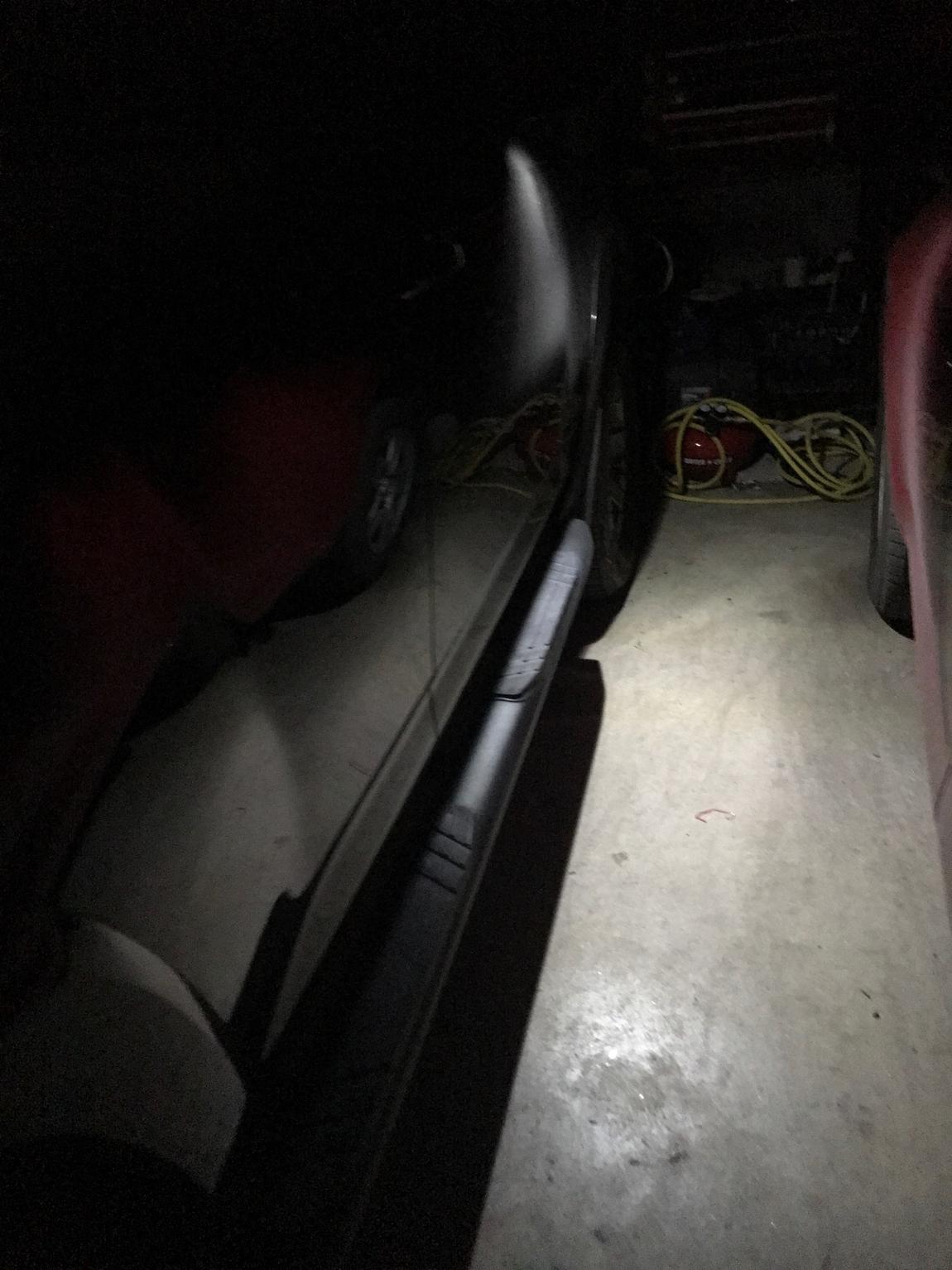

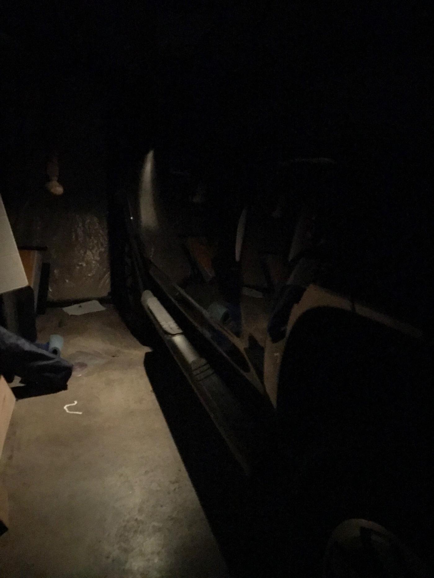

Just completed the install following ROBSCOOL's instructions. Covers popped out easily, no damage to the clips, and 20 minutes is about right on the install time. To answer the question above regarding the difference in LED v. Stock, I took pics with the stock bulb on driver's side and LED in passenger side in a dark garage. Very happy with the results. Many thanks to ROBSCOOL for the detailed instructions!
