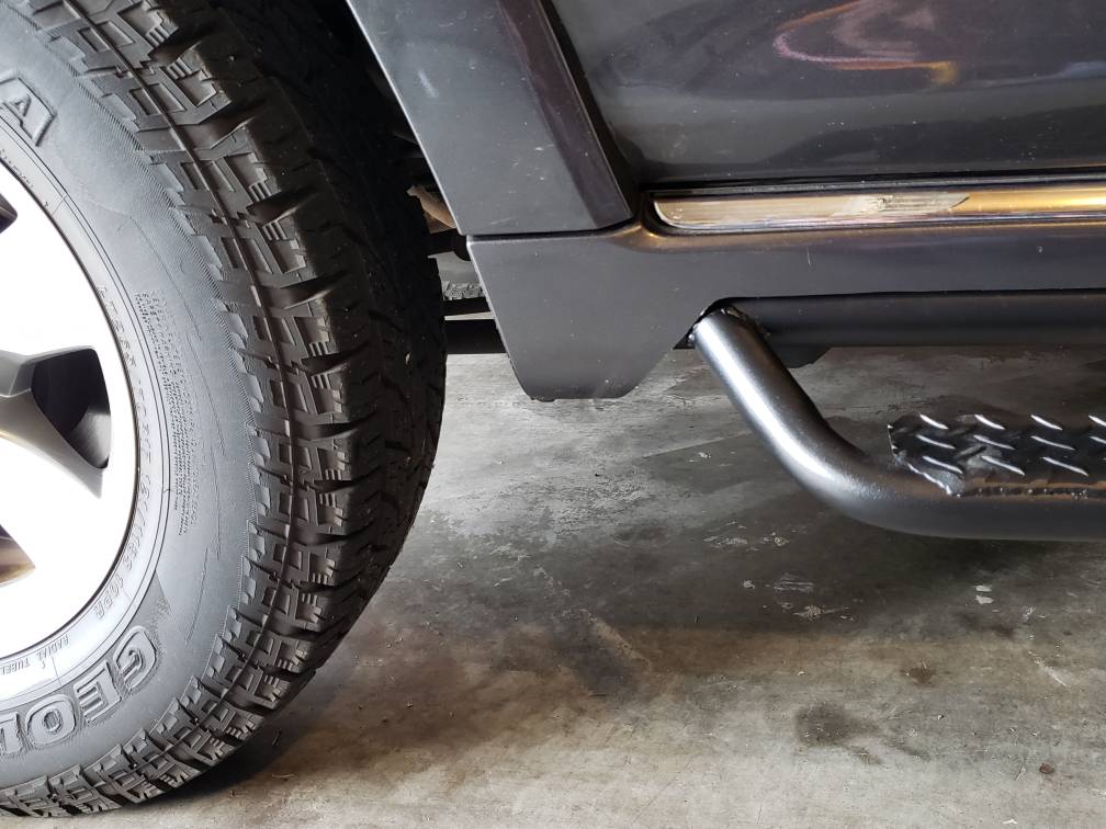

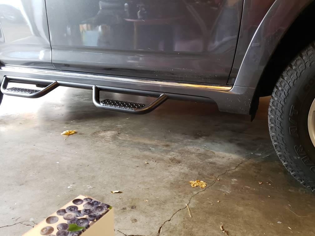

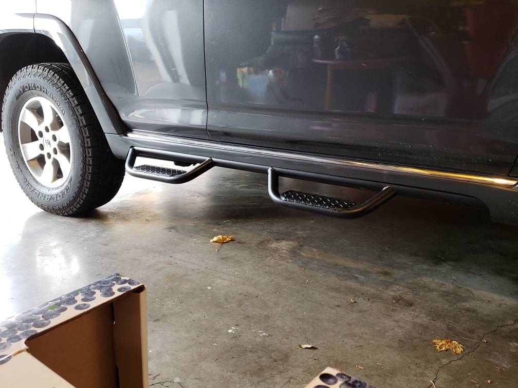

[MENTION=140439]Decipher[/MENTION] finally got this done. Went a little more custom at the front and rear tires. 20201212_113235.jpg20201212_113227.jpg20201212_113224.jpg20201212_110558.jpg

That looks super clean. Did you cut the plastic with a Dremel like Decipher described, or did you use a different technique? I'm thinking about ordering the Shockworks sliders and just cutting my rockers instead of replacing them. I think I might be the only person on this forum who likes the look of the chrome stripe on the trim.

[MENTION=140439]Decipher[/MENTION] - Your N-Fabs with trimmed side skirts, lift, and wheels all add up to an awesome overall stance/look for your 4Runner.
Could you give me details on your wheels (size and offset) and brand of lift kit you used? My shocks are warn out and its time to address my issue. I saw in other threads where you were talking about changing things up so I wanted to ask you specifically what you ended up going with to achieve the look you have in these pictures.
[MENTION=140439]Decipher[/MENTION] and [MENTION=623996]Robsha[/MENTION] Thank you both for posting pictures.

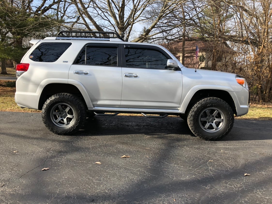

Thanks. I really loved that truck. I’ve moved on and lifted a Lexus GX460 now but here are the details.
Lift: Bilstein 5100 front and rear shocks. 2.5” front setting. 1.5” daystar rear coil spacer. OEM springs. This was a cheap route to get lift. This was my first lifted truck so I wasn’t sure I’d like it but absolutely fell in love. The Bilsteins perform way beyond their price point. I loved everything about them and I wheeled them hard. That’s what I used. Are there better lifts? Yes. It just depends on your goals but I loved the ride and capabilities of those shocks.
Wheels: Level 8 MK6 17x8.5, -12 offset
Tires: 285/70-17 (33”)
This setup ran with stock upper control arms and required a good amount of plastic trimming especially in the wheel well. No body mount chop needed. Nothing else needed. Hope this helps.

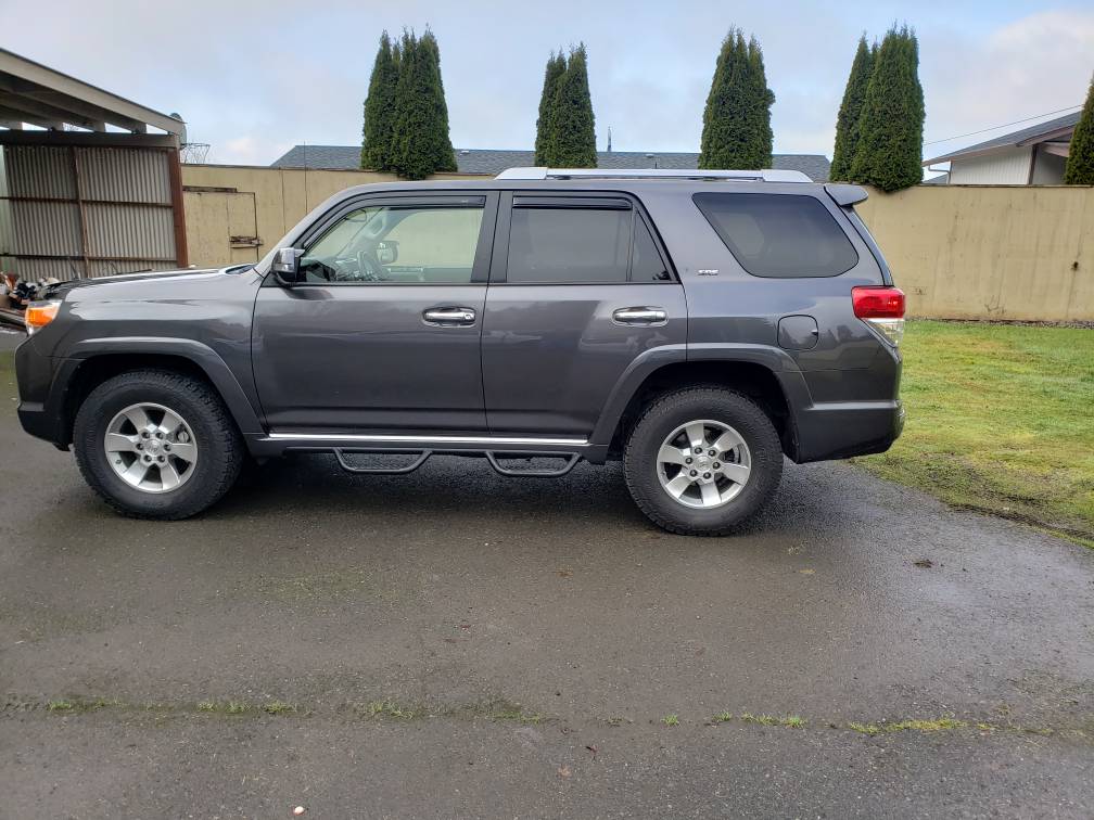

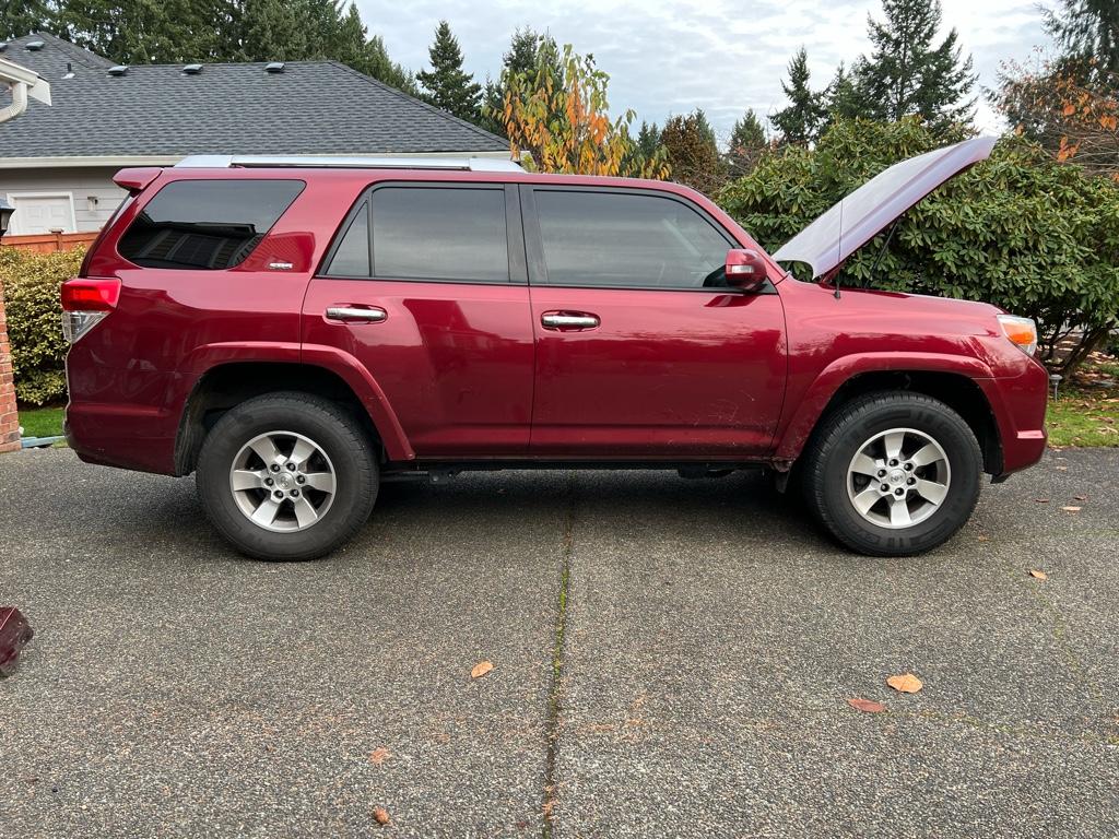

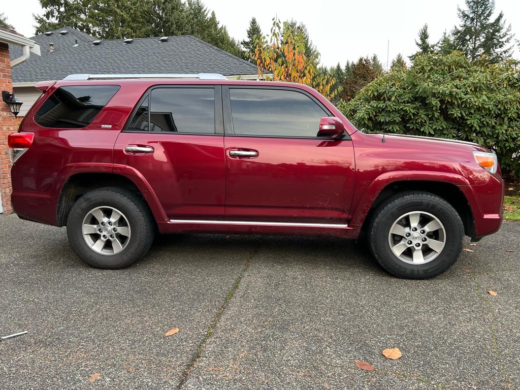

2013 SR5 I just bought. I removed the rocker trim just to see what it would look like. The only part that is noticeable is that rear portion of the front fender.
I know this is an old thread but has anyone found anything cheaper than the Toyota $100 fender caps to cover the bottom of the fronts?
I put my panel back on and will be assessing how to either trim it or just leave it off.
Lift wheels and tires coming soon.
Thanks. It really turned out great.

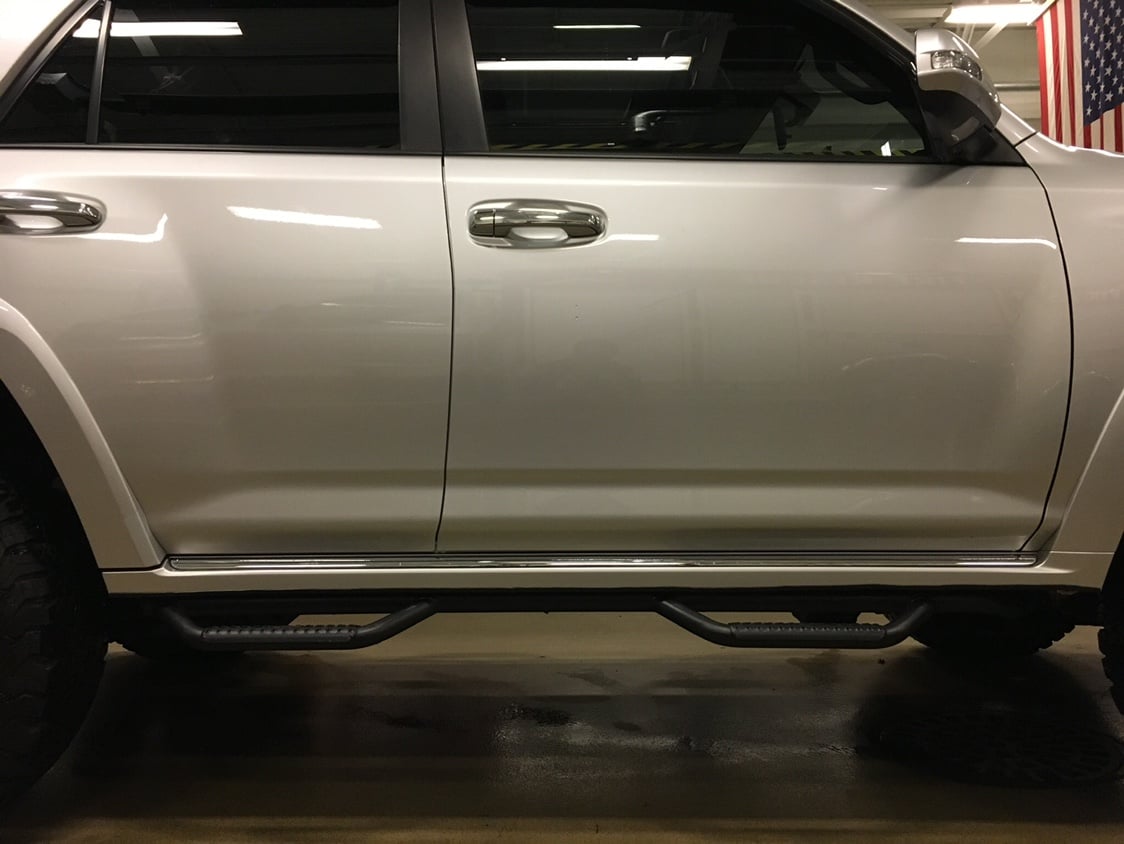

I basically held the step up and got an idea of how much I’d need to cut. I can measure mine now to give you an idea of how much I cut off.
I simply used a tape measure and marked the side skirts all the way down their length with a sharpie every foot or so.
I then taped along that line with painters tape.
I used a Dremel with a cutting wheel to cut long the line. It’s all plastic so it was easy to cut.

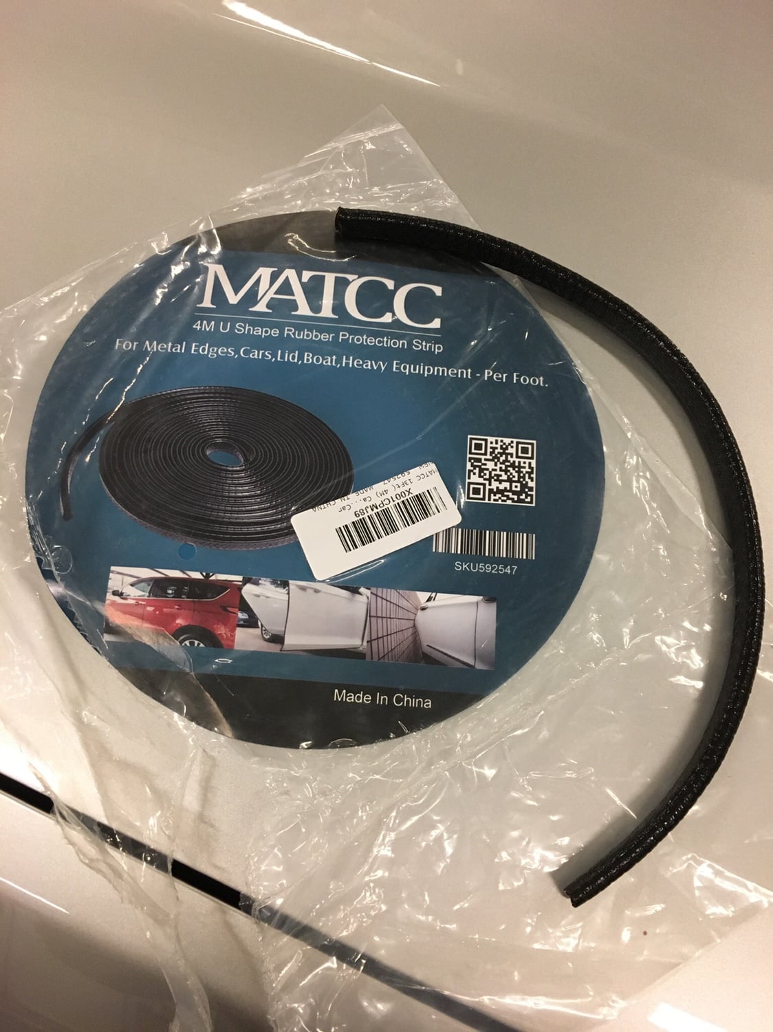

I used protective door trim that people use to protect their doors from dings. It finished off the look and covered any little imperfections.
I remounted the steps using some 3M molding tape in the corners by the rear tire to make it a little more stable. Was absolutely worth the time and saved massive money. Plus it looks good IMO.
