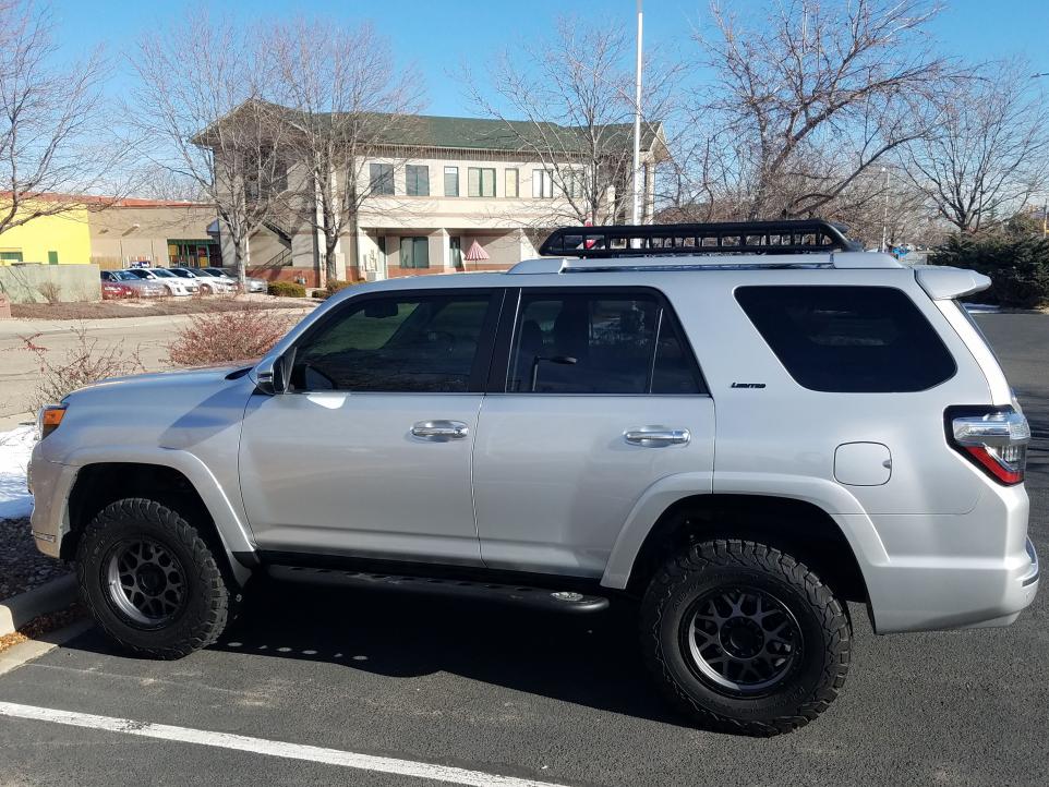

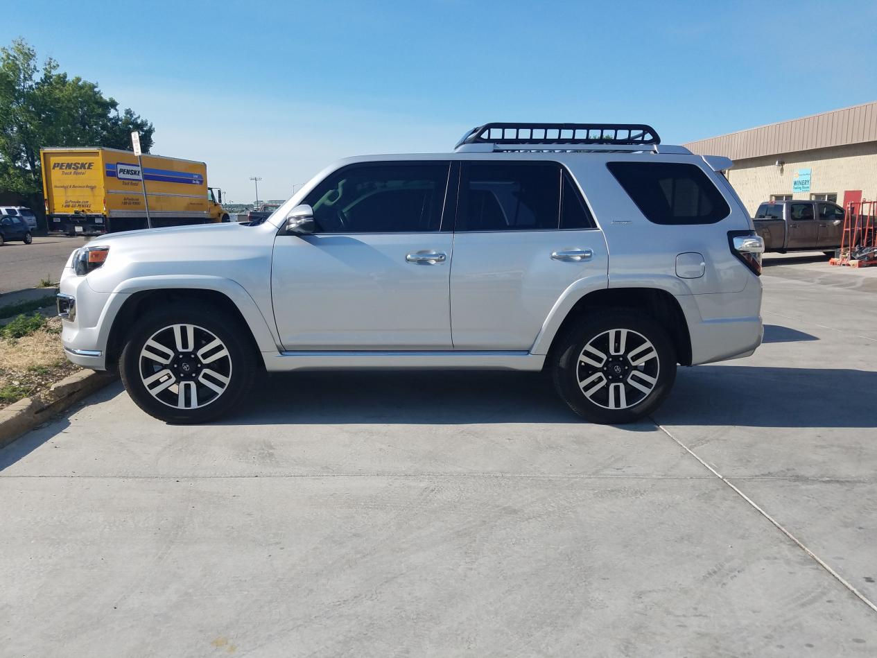

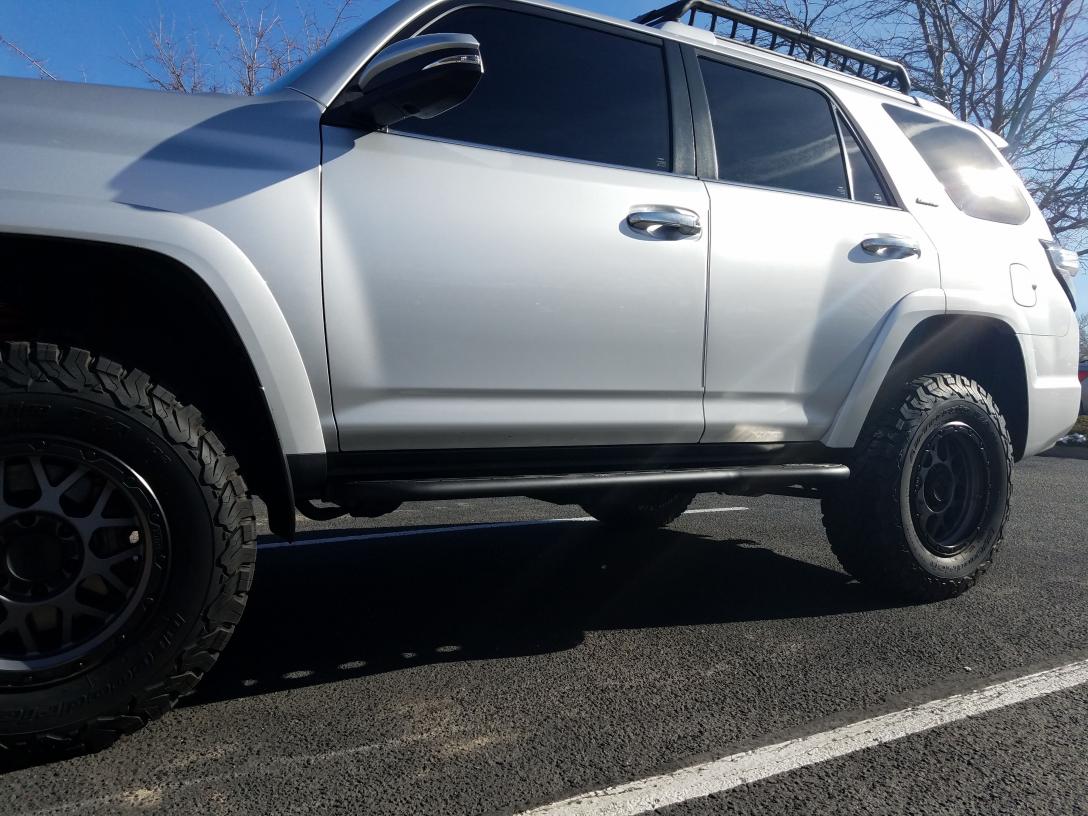

Here is 1 before and 2 after pics of the TE rocker trim replacing the LE rocker trim, with RSG sliders on a 2014 Limited...

After looking at your pics again I meant pic of rear not front.
Know what you mean skinny at the waist. If I do this mod, eventually I would get some sort of aftermarket bumper (assuming one is availablefor the Limited), and possibly either aftermarket bumper or SR5 bumper for the rear. But with sliders or Nerfs the middle isn’t way too high for the ends.

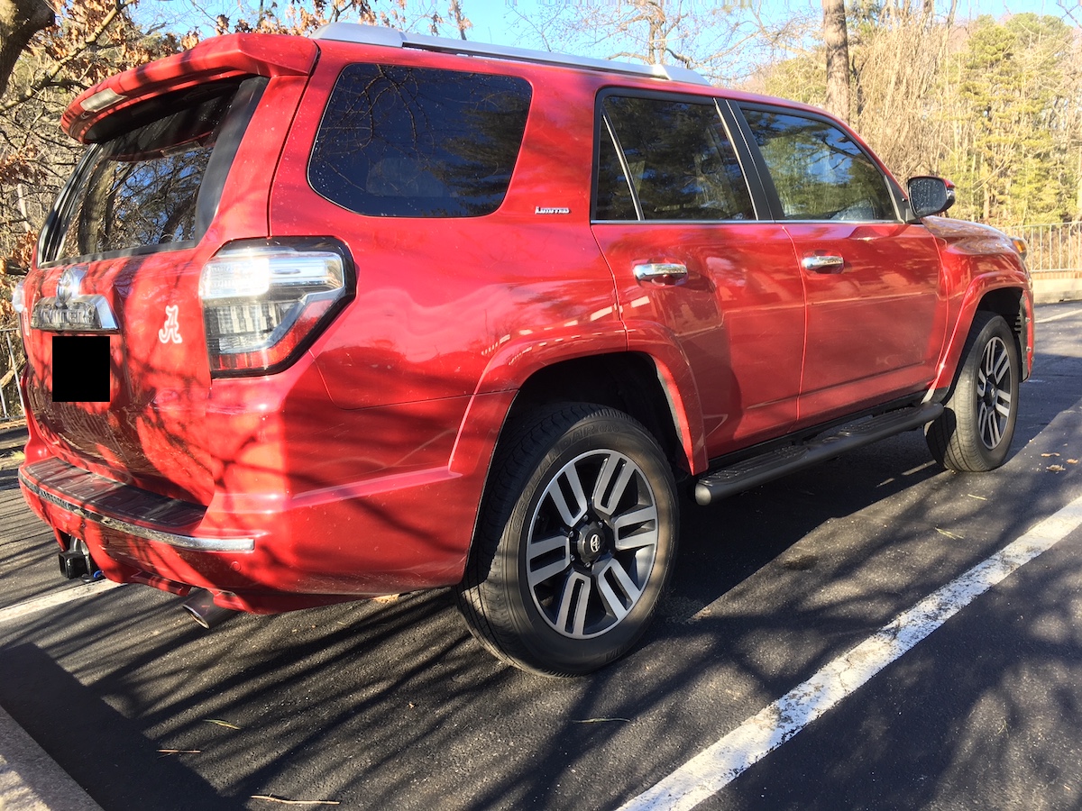

Here you go. I just added the Go Rhino nerf bars this morning (I don't need sliders at this point...) which improves things a bit.

I thought the same and once I put the rock sliders on you can't notice it at all.
