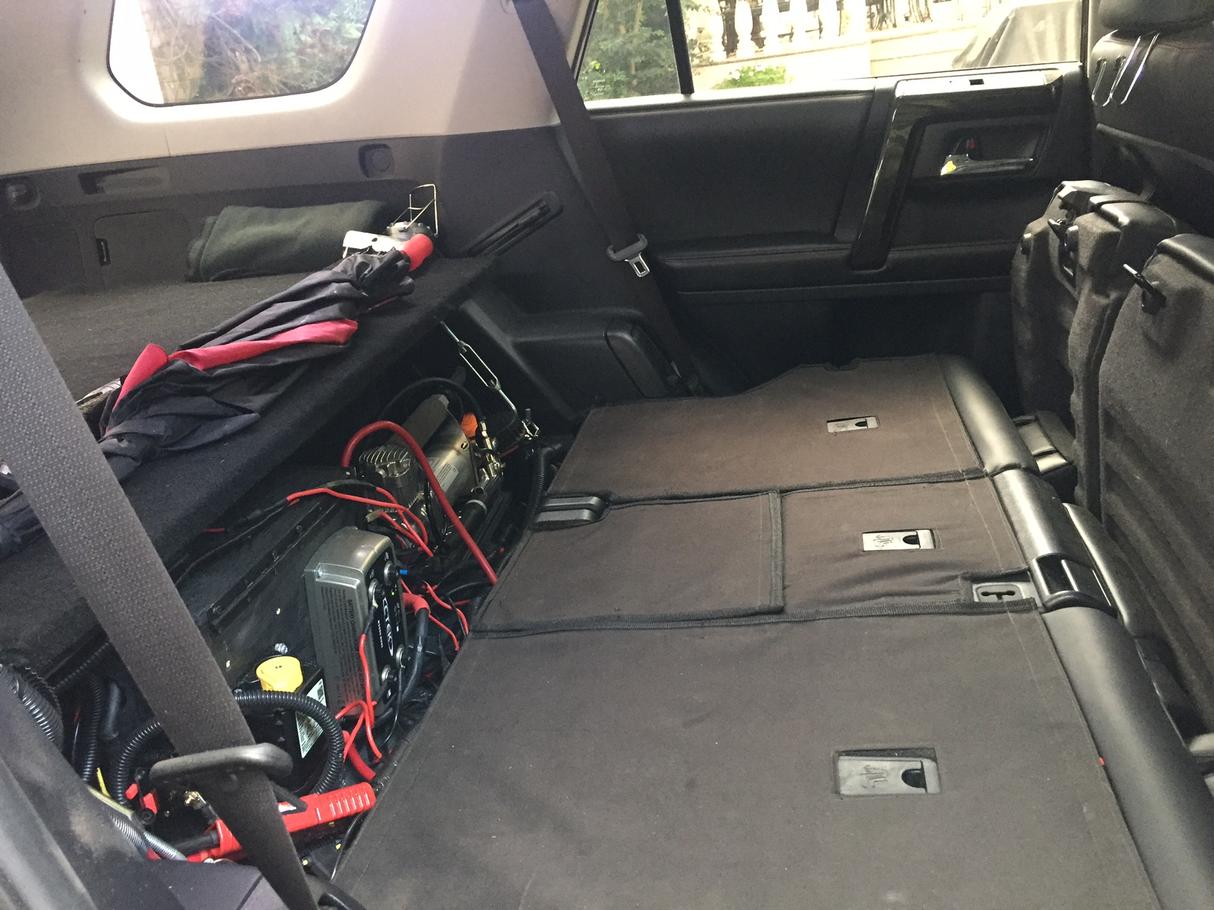

2nd Battery and drawer system, finally installed

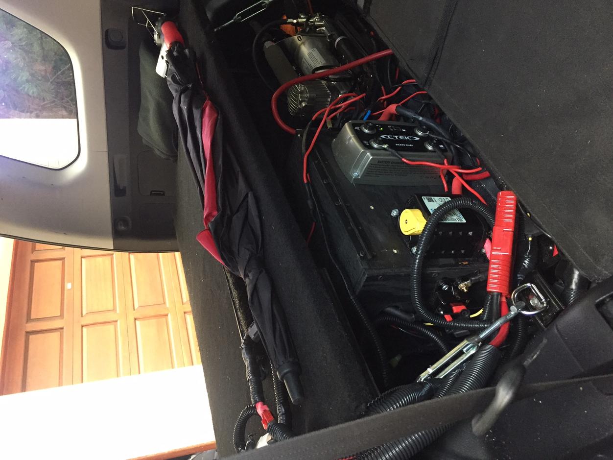

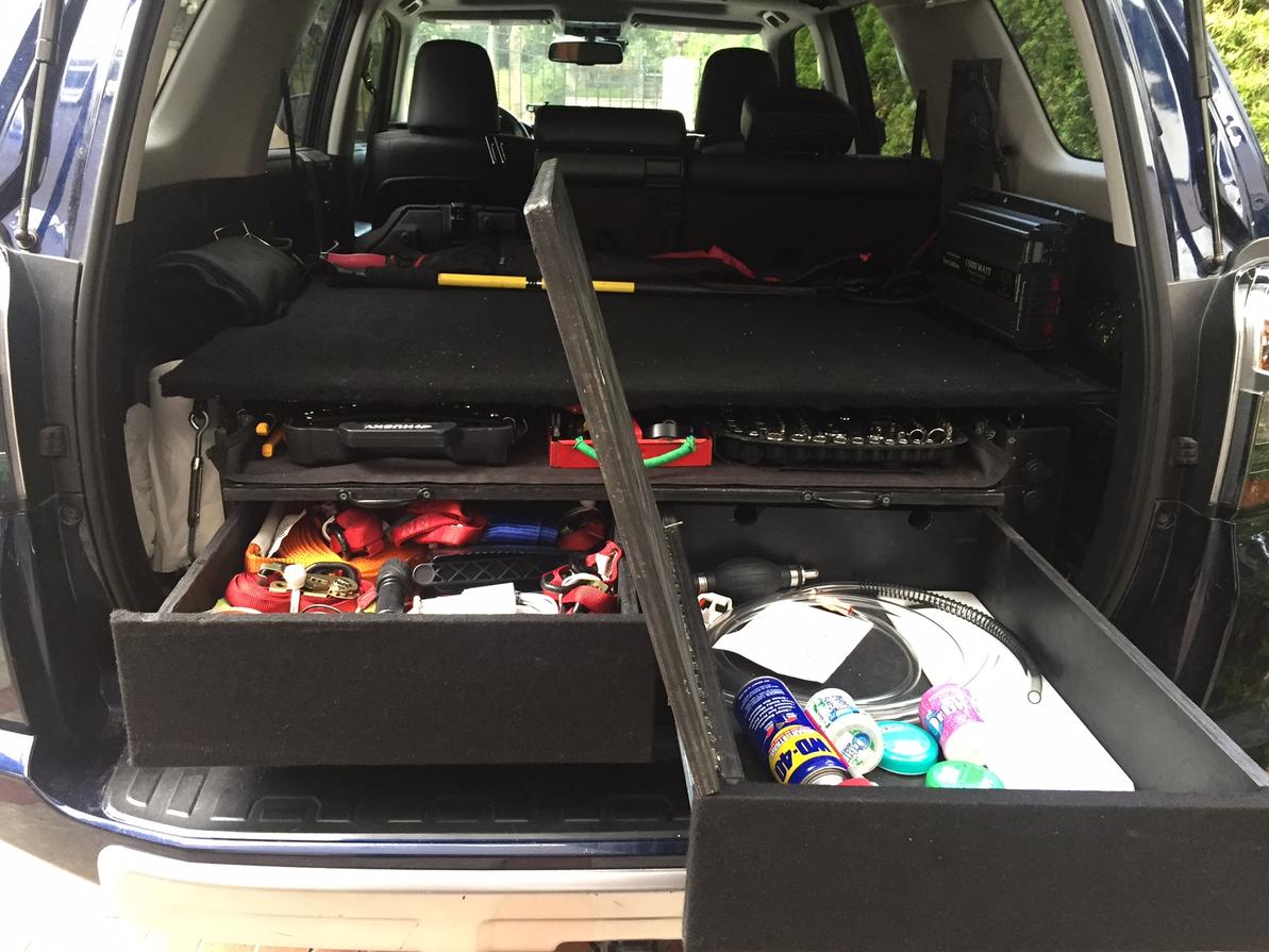

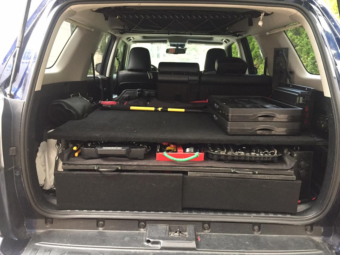

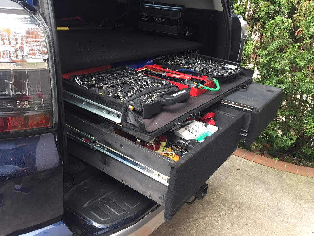

Thanks for everyone's posts. I looked at dual battery and drawer setups and did a mix and match. I used a Blue Sea ML ACR and a CTEK 250s Dual to isolate and charge the AGM battery. The drawers were all cut to fit.
This took a couple of weekends worth of work with a lot trial and error - a lot of errors. Still have some clean to do with the wires and will eventually add solar.
Any recommendations for a dual battery monitor?
Glad to answer any questions and glad to hear any suggestions for improvements.

Here are some pics of My dual battery install.
The marine Battery was used because it has the extra terminal on top which will be used for the bussman fuse and relay panel. I used #1awg marine cable due to its flexibility and amp capacity. The added support bar on the fire wall is to keep from attaching to the OEM loom. Both batteries have a negative to ground at there location. I also ran #1 awg cable from both batteries to a negative bus bar which is also grounded to the frame. The bus bar also provides grounding for the ACR. I did not drill any holes to do this install, there are plenty of existing threaded holes in the body for mounting. I installed a terminal strip next to the ACR for testing the three position switch. I have not found a good location on the dash board for this switch yet. That is the next project when I install the light bar.
This was not the cheapest way to go but when I shut the hood I feel confident that the truck won't self destruct. Thanks to everyone who posted there dual battery mods. All the information was most helpful.
