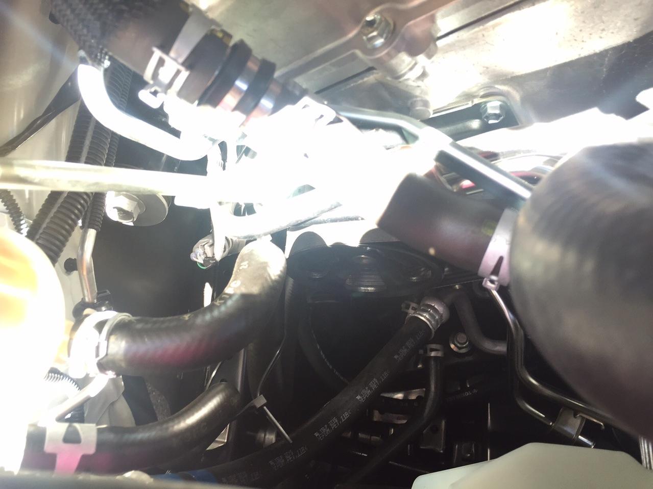

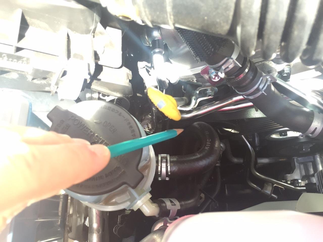

To those that have installed this, have any of you had trouble with the power steering hose contacting a coolant pipe behind the fan after relocating the power steering reservoire? Mine is, I've got it zip tied right now but am looking for a more permanent solution.
Thanks Keith I appreciate the help. You can see here I've got the two power steering hoses zip tied together, I did this to keep the larger hose from contacting what I believe is a coolant pipe (the polished one, pointing to it in the first photo). The fix I see is to rotate the hose on it's fitting on the power steering fluid reservoir, and/or shorten the hose slightly. Have a look. Thanks again!

I just went and looked at mine and now I see what we did differently. I actually used two zip ties (just to be redundant) and zip tied that hose to the silver 1/4" tubing that's next to the dipstick and your pencil. I left maybe a 1/4" slack in the zip ties so the hose was not actually touching the tubing due to the natural tension holding it away. This kept it from being able to touch anything, especially when off road and things have potential to bounce around. I checked everything for signs of heat related issues and none were evident.
Good luck.
Good to know, my hose rests on that silver tube in it's natural state.. could just be normal differences with the bends in the hoses. Thanks for checking it out for me, other than that the install went smooth. Time to get the rest of my electronics hooked up.
Thanks Keith
Thanks a ton Keith_PDX for the full breakdown. Going to try something similar. I like those ABS mounting plates. Need to find a plastic fabricator in my neck of the woods now.

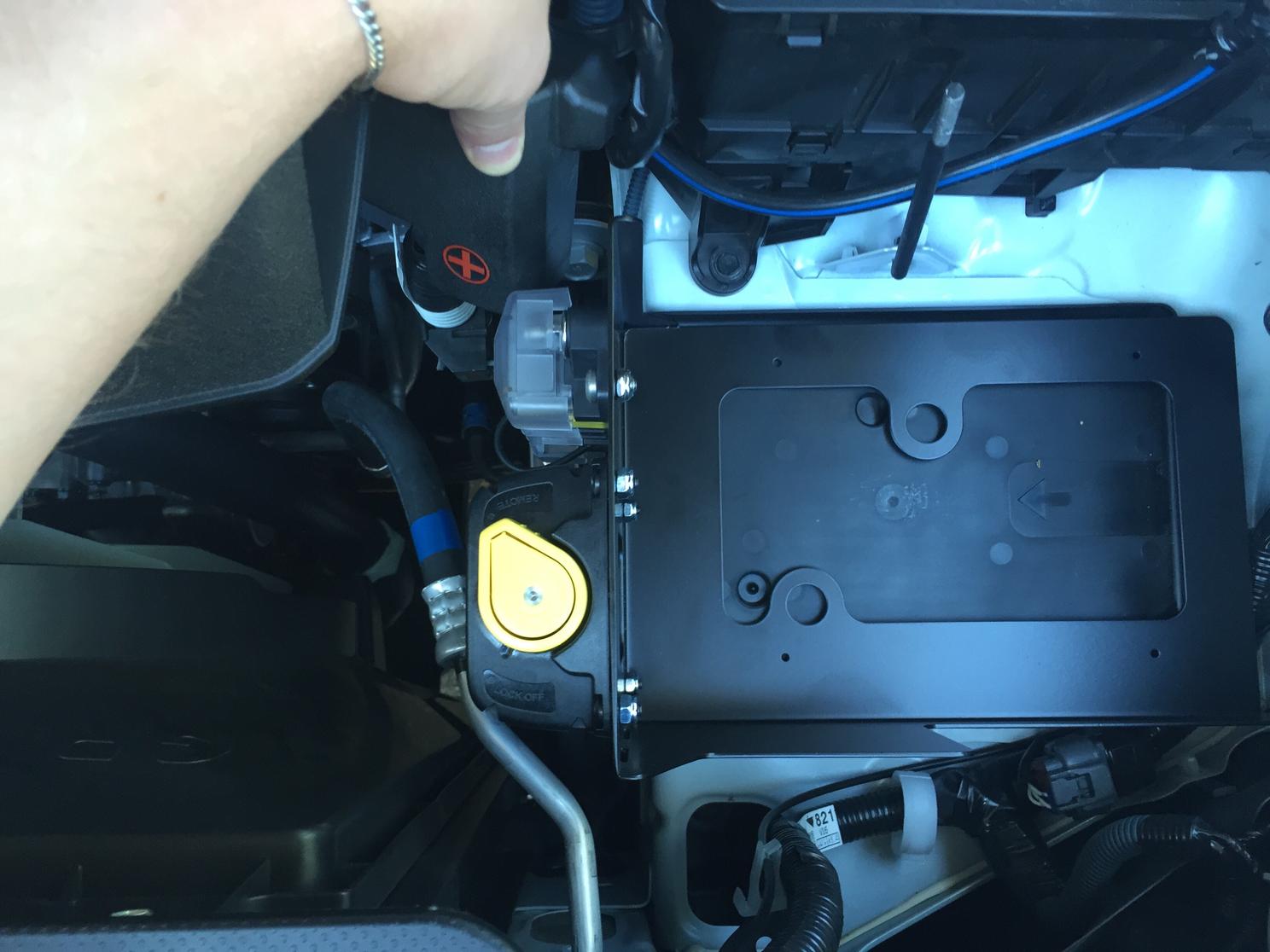

To those of you with the ACR tray, any of you run into clearance problems with the hard radiator line? Mine is contacting the ACR and the tray still needs to move over another inch such that the holes line up, at least per the instructions. I'm using ACR part# 7622.
Yes, with my big batt I had the same issue. That's an AC condenser line. I VERY gently bent it, no big deal.
I feel responsible to say that unless you feel confident, maybe have pipe bending tools, I don't recommend it because you can get a kink and have to discharge the system to replace.
The two 8mm fasteners that you see are tapped into the battery holder strap. If memory serves me correctly I also added a nut for double security.
