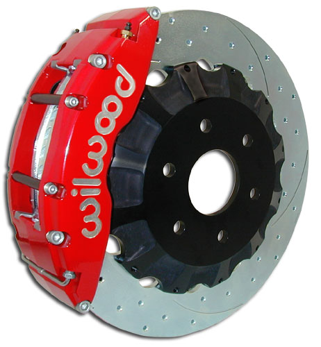

If you have the money then you should go this route in all four corners.
