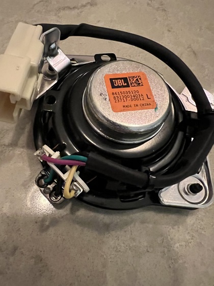

you are right, its not as easy as a non-jbl.
I did have to cut the wires and off of the stock dash speaker and mount them to the aftermarket set, to make it plug into the stock location.
Thanks Masterfoo, Please tell me if the JBL pictured is a speaker or just a tweeter?
I also want to know if when you cut the wires and hooked up the replacement speakers if it changed any of the original functions such as the EQ the JBL head unit has.
