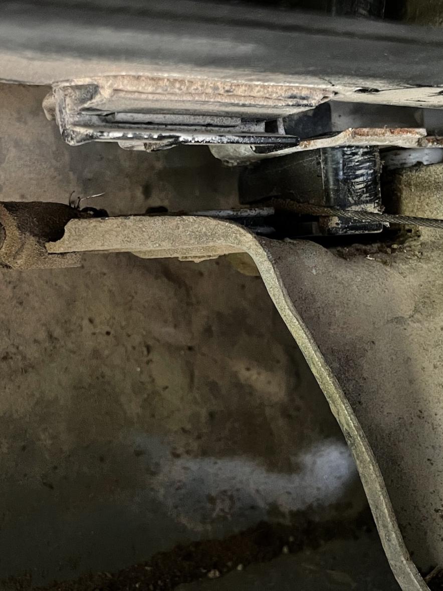

Hey, thanks for the speedy reply, this is super helpful! Can't say for sure but i can see that there is a cable that is frayed where it enters the housing. I expected to see this cable move and get jammed against the housing when I tried the window though and it didn't so I'm not totally sure that is the problem. Didn't get a photo of the cable coiled on the motor but it looked a bit mangled.
Hitting some dirt roads this afternoon so I have it all covered with cardboard but going to pull it apart again on Sunday and take another look.
Thanks!!

Hello slide531
From your photo it sure looks like you have a frayed cable.
I’d say that’s the cable run at bottom end of the regulator channel on the driver’s side of the vehicle, so when you close the window the frayed piece of wire doesn’t go into the housing, it goes the other way and runs alongside the regulator channel where it wouldn’t have any housing to squeeze through. But where is the other end of the frayed cable? Most likely somewhere inside the black sleeve the other side of the housing. And that could be your problem. If the loose frayed cable other end is tangled up inside the black sleeve it is most likely jamming up inside the sleeve when you try to close the window, and causing the ‘pinch sensor’ to kick in and roll your window back down every time.
And maybe there’s more fraying cable at the pulley coil on the motor. You say it looked a bit mangled. You should take another look at that and get a photo.

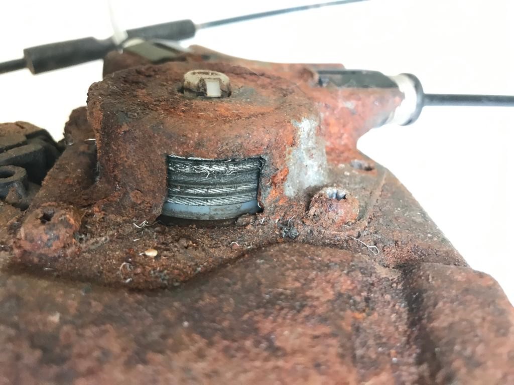

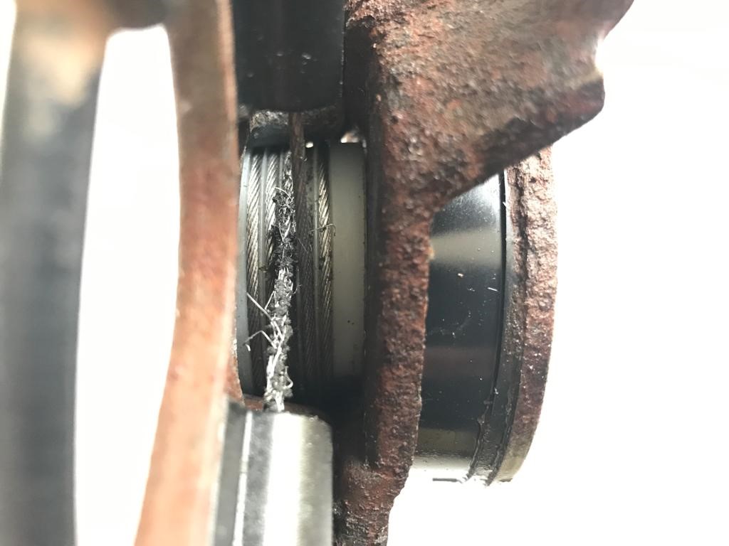

I’ve attached photos of my frayed cable where it is coiled on the pulley coil attached to the motor. When I first saw a loose piece of wire similar to the one in your photo, I snipped it off with pliers hoping the window would then work OK. But after a few open and close actions with the window there were a lot more loose frayed cable ends, as you can see from my photos.
I hope your frayed cable isn’t the problem, but I reckon it is! Like I said, take another look at the cable where it meets, and winds round the pulley coil on the motor. If you see frayed cable there too, that’s the problem for sure.
You can’t just replace the cable. You have to buy the full Regulator Sub-Assembly, but you can get this (Toyota Part No. 69807-35030) from a Toyota Dealer for around $125, and following the instructions I linked you to earlier you can do the repair yourself. No need to replace the Power Window Motor unless that is badly rusted or damaged.
If you need any more help on the repair, let me know.
I notice from your photo that there’s a lot of mud inside your Tailgate. That was the same with mine. The Tailgate interior isn’t watertight, when the back window gets wet, the rain water, or other gunk, runs down inside the Tailgate. Dust gets in there too! That’s the reason there’s a plastic sheet sealed with butyl strip over the service hatch, it keeps the water/gunk/dust away from the electrics and wire harness. But water/gunk/mud/dust gets inside the tailgate behind that plastic sheet, and it contacts the window regulator and motor, sticks to them and over time damages them. Like other posts on this subject say, it’s important to keep the drain holes at the bottom of the tailgate clear, and I’d say important to flush the Tailgate out with clean water when you’ve been off roading, or driving through dirt, salt or sand, by hosing water onto the back window and letting it run down the outside of the window into the Tailgate. You can also get access to the bottom of the interior of the Tailgate by popping out the two black plastic closing hand holes which are on the bottom of the Tailgate. They pop out easily if you pull hard on the top edge of the black plastic. Once they are out, you can get your hand, and a hose, inside the tailgate and pull out/ hose out mud/ salt/ sand/ gunk, and you can clear the inside of the drain holes.
I hope you don’t think I’m being a smart-ass here with all my comments and advice! I’ve learnt all this the hard way over the last 6 weeks, and want to share my knowledge with others to help them with or help them avoid the same thing happening to their 4Runner!!
Cheers, David H

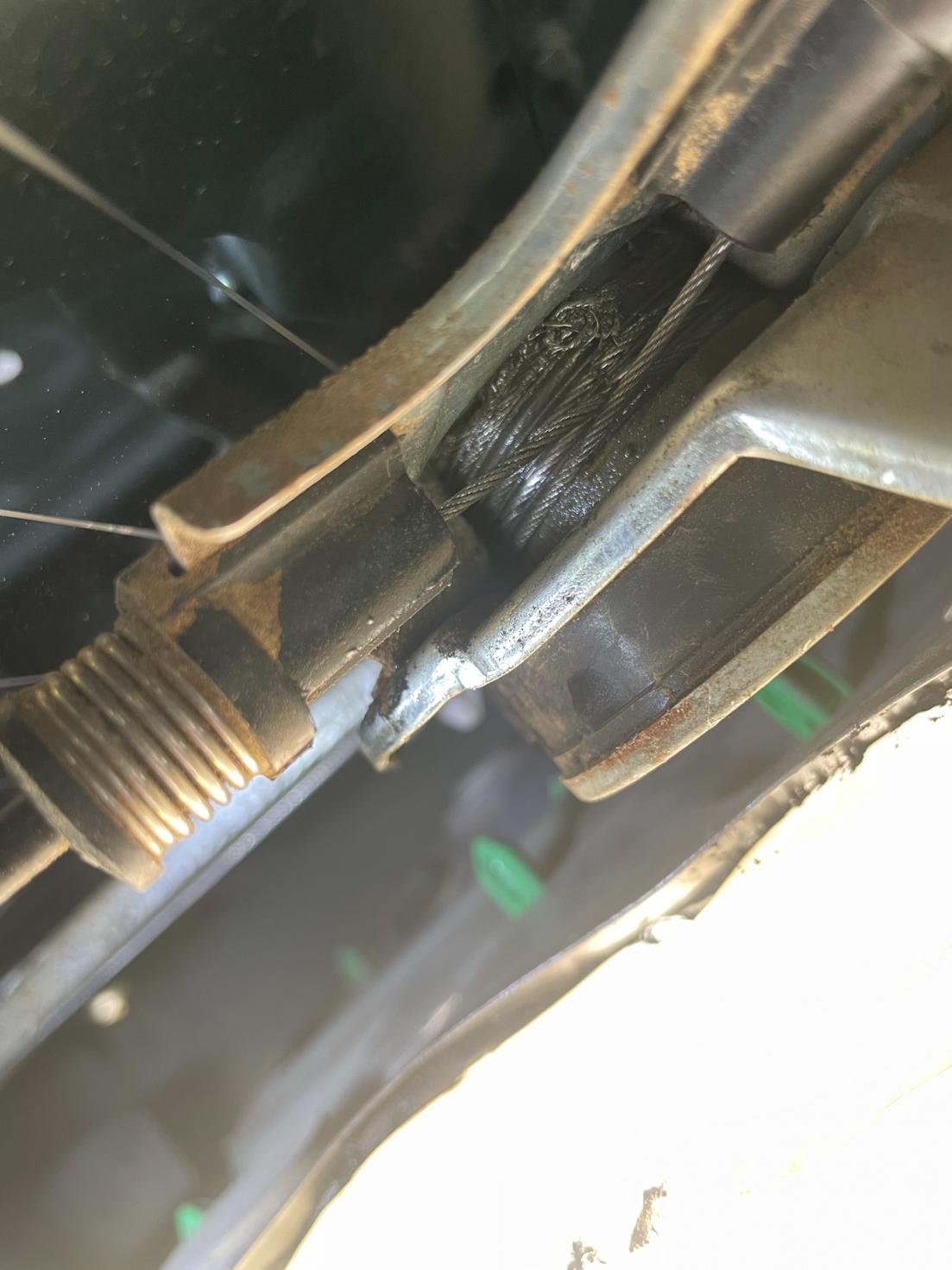

I raised the window one inch and paused it and here is what I see on the pulley. Definitely need to replace the Regulator sub-assembly.
Hey slide531
That looks exactly like the issue I had! (Although with a lot more rust!!)
You'll deffo have to replace the Regulator Sub-Assembly.
Power Window Motor most likely OK, as the metalwork in your photos isn't rusty or corroded. Your cable probably sucked in grit from the dirt/mud/sand/salt inside your tailgate and the to and fro of cable movement frayed the wire.
If you have a local Dealer they should have the replacement part in stock, or an express delivery internet purchase. The full repair took me 8 hours, but at least 3 hours of this was removing the Wire Harness, prepping the replacement and fitting the new Wire Harness (I bought the replacement on eBay and had to swap most of the plastic clips over as the breakers yard had snapped them on removal), so you could get the job done in 4 hours one day/night this week, and still make your camping trip!?
I'd recommend you clean all the mud and grime out of the interior of the Tailgate once you remove the old sub-assembly and before fitting the new one. Otherwise you have the detailed step by step instructions from Rytanium’s Post #31:

Hey Slide 531
Sorry to hear you have the same problem!
Yes, I completed the repair on Tuesday this week. Had to wait a while for the parts to arrive from the USA. My Tailgate Window/ Wiper/ Heater all now working 100% Perfect.
Have you seen this 07-01-2017 thread from lightfreak: Liftgate Window Regulator Corrosion
It’s in the 4th Gen Forum, but the Tailgate internals are pretty much identical on a 5th Gen.
Make sure to read Rytanium’s Post #31 on page 3 Liftgate Window Regulator Corrosion where he gives a step by step guide to replacing the Tailgate Window Regulator.
This all REALLY helped me.
One edit to their instructions is that I did NOT have to remove the Window Glass from the Tailgate. With the Tailgate open so the Window was horizontal, I removed the 4 Bolts holding the Window onto the Regulator brackets and slid the glass up into the closed position. This means you can’t close the Tailgate until you’ve completed the repair, so best to have everything ready before you start.
If you have the same problem as me, and the cable and pulley are damaged, you’ll need to buy a complete Regulator Sub Assembly. This comes with the pulley and cable and is attached by 3 screws to the Power Window Motor. The Motor detaches and can be re-used, although mine was so rusty I replaced it.
I don’t think it’s possible to pull out the old motor or the Regulator Sub Assembly with the window stuck in the down position, there’s not enough space inside the Tailgate to do this. You’ll need to remove the 4 Bolts I mentioned above, and slide the Window Glass up into the closed position. I reckon this is possible as in the down position you’ll be able to access the 4 bolts.
Hope this helps.
If I were you, I’d make absolutely sure the problem is with the wire cable and motor pulley before buying the parts and starting the repair. Maybe you’ve already removed the Tailgate interior panel and the service hole plastic cover and the metal bracket across the service hole, and you’ve popped your head in there with a head-torch on to check the wire cable and the motor pulley for damage? If so, the repair is definitely do-able - go for it!!
I replaced one side of the Tailgate Wire Harness whilst I was in there, as it had some damage and a botched fix by the previous owner. Whole repair took me 8 hours. Maybe an experienced mechanic would have done it quicker, but I took my time and did everything slowly and surely!
Let me know if you’d like any more help.

Do you have the Part #s for the Regulator sub-assembly?
Edit: I see it now in a post above. Wife is having this issue on her 2014. Dog stepped on the console button causing rear window to go down. Would not return all the way up. She finally got it up with the Scotty Silicone approach. She is currently at our Montana home overseeing construction of a 2nd garage; I’m done at our Fullerton, CA home working the day job and home projects on the weekends. I’ll inspect the sub assembly when I’m next up there in mid-June and order replacement if needed.
Rear window on our 2014 SR5 was not consistently going all the way up. Dog would inevitably step on the switch, sending the window down. Silicone spray helped some, but dog wants in the front passenger seat when it is vacant. Sometimes on first attempt the window will go all the way up, but comes up short on subsequent attempts. Seems like the motor gets tired.
I pulled the panel and could not see any cable fraying. It does seem like the motor or pulley is binding. So I ordered the regulator sub-assembly. It was $138 plus $45 shipping from an OEM Toyota Parts online site. Other sites it was $185 to $285.
Truck is stuck in the garage as we are building a 2nd garage. New apron outside the old garage and can't drive on the concrete for 10 days. Wife is driving her other 4Runner, a 2023 ORP.
Regulator sub-assembly arrived and I installed it today in about two hours. Old assembly was rusty, but the cables were not frayed, though definitely gacked up in their cable sheaths. Did a couple tests and it went partially up, then down, then fully up, then down, then fully up and it stopped, locked in the up position. The regulator motor seemed very weak and I suspect that is the problem. Before I buy a replacement, I'd like to check the fuse, but can't find a fuse box in the cab and the manual does not provide location and listing of fuses.
1st Update: Went out to check the fuse box in the engine bay, but there is no specific listing for window motors. Went and checked the other windows and they all work. Then I checked the liftgate window. It now goes half-way down to a hard stop. The other way it goes fully up, every time. I will pull it apart tomorrow am (I'm on vacation at our Montana home) and see what's binding it up.
2nd Update: Took the panel off and observed from inside the trunk area while wife operated the window. The cable on the driver's side had slipped under a nylon slide at the midpoint of the track. Repositioned the cable on top of the slide and now it goes fully down and up as designed, repeatedly.
