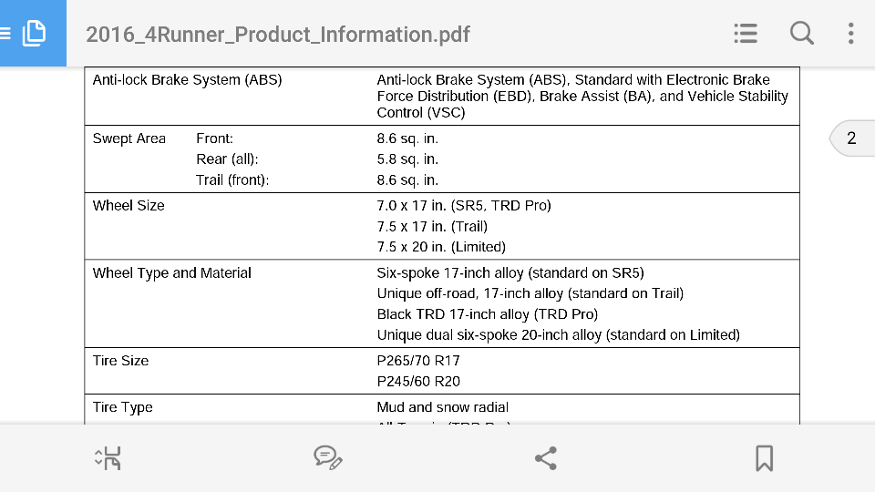

Googled and found the 2016 4runner press release info...
Edit: Limited wheels are 7". Check link jhalko posted above.
I guess the proof in the pudding is as bofa suggests. Look at the rim.
Gonna try that again. Parts guy could be wrong although he showed me the screen with the rim and my VIN on it or the parts system is wrong.
Just to be clear that is not correct for the Limited, the LE 20's are only 7" wide. It's been debated to death in another thread. Toyota materials have had it incorrect for quite some time. See link I posted in above post.
Good to know, I'll edit my post.
